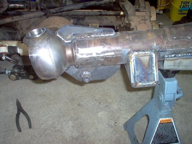

Why the axle guesset kit? The front 62 axle already has the lower gusset stock. How many people actually run into axle housing breakage or warpage?

knuckle ball gussets...

Last year at TTR, someone (I think Texican (Butch)) broke the weld right through where the C&T had been done. The heat effected zone right around where it is cut, heated, and re-welded looses strength when you do all that. Those gussests which get welded above and below that area take care of it. Like I said, I havent done it with either rig I've SOAed, but after seeing that FJ40 with a broken out knuckle-ball, I think its worth the $25 bucks for insurance alone.

I just looked at the kit and I agree with you. It's pretty cheap and only an extra few minutes of welding.

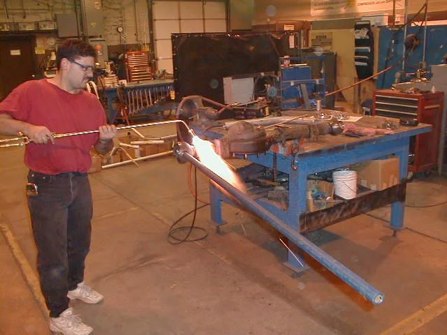

If your axles you bought were set up and run in a truck, then a cut and turn will be more complicated then you think. Ideally, you will want to cut the perches off, and weld on new ones that give you the pinion angle you want (I recommend pointing straight at the t-case). With that done, then rotate your knuckles back to avheive the proper caster. You need to know what geometry is built into the perch/pinion relationship now before you can really plan your attack. So, get the old axle out, swap the new one in under the spring and see what it looks like before cutting or welding anything. You may decide to use your existing housing since the stock pinion angle is better than a stock FJ60 pinion angle.
At risk of Hi-jack, your recommending more welding (heating) to mitigate heat effected zones?
I'm currently looking at replacing my pretty well bent housing (SNT is an equal opportunity carnage maker) but so far it doesn't look like it bent at the knuckle ball. It looks bent closer to where the spring perches are located. Which makes sense to me since that is where the force is applied if I recall my Statics class correctly.
Randy, you can add new driveshafts to your list. And might as well get the full knuckle kit when you get your Marlin axle seals. Oh yeah, new longer shocks (and a place to mount them) for your increased wheel travel.
The Rose-Bud is what changes the grain structure so much. Its not the welding... The welded area will not be prone to bending. It will be prone to cracking...
For clarification this is how the gussets mount:
What do you mean by rose bud? I never heard that term in any of my engineering courses or materials courses.

i believe he is referring to the application of heat over a large area for a extended period of time. Say for instance with a torch. Heat is allowed to "soak" the material in question, releaving any internal stresses that would have previously added strength to it, as he said changing the grain structure. The tip commonly used with a acetylene torch is referred to as a rose bud tip, i believe this is what he is talking about. Maybe all those Mech Eng. classes did some good other than increasing my debt to income ratio.

This would not become a problem if a standard MIG welder was used? As for the explanation of cracking; I'm guessing that the weld creates a difference in the grain and that area becomes an area that stress concentration could eventually fatigue or break.
I saw a cracked FJ55 axle from the drivers knucke to the drivers spring perch. This happened at SnT because he got well over 5 feet of air. As long as I don't jump it like that I think the welds will be fine.
CORRECT CORRECT CORRECT!!!
During the C&T, you MUST heat the outter tube to rotate the inner tube. I've heard of guys doing it without the heat, but they must be stronger than me. In the 3 C&T's I've done, I used a 6 foot cheater bar and we still needed heat. All that heat is what distorts the grain stucture of the metal weakening it. Also, just remembered, one of the companies (maybe all-pro) has the gusset kit also but it put the shock in double shear instead of single shear like the picture i posted a few minutes ago. The double shear shock mount is also a good idea if you're trying to do it right from the git go. I've seen shocks in single shear bend bolts pretty badly.
If my memory serves me correctly, Toyota put the inner and outer tubes in a .007 interferance press fit (pretty tight)
Pic of "rose-bud, cheater bar, etc....

No gussets for me either except the stock housing one...
I didnt need to heat the housing end when I did the c and t...maybe I was lucky, but as long as I hit the right depth in the "cut" it turned fairly easily.
I made my own shock tabs out of 1/4 in material, and theyve held up great...FWIW. I did howver need to run TWO, one on each side of the eyelet with a through bolt. I tried the FJ40 set up with, but it bent.
As for the traction bar, I got my brakcets from Ruffstuff and built my own ladder bar. The hardest part of that is finding the BEST location to run the x member for it. In the 62's it was quite a challenge cuz of the exhaust set up.
