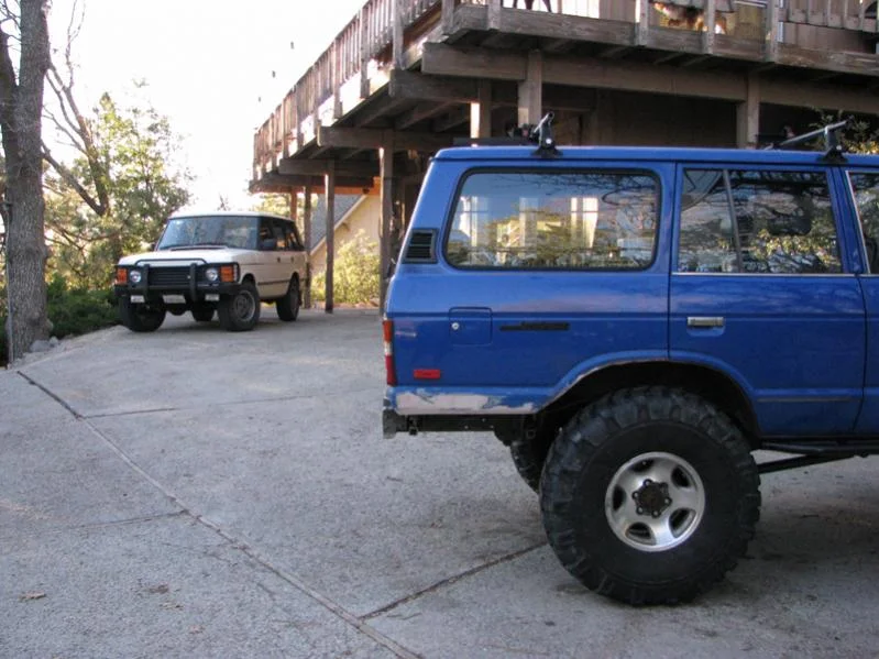

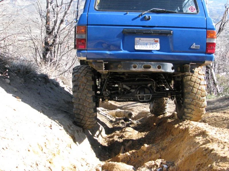

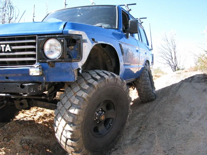

It lives! First test drive was last night. Ended up having to tow it home lol. The alternator wasn't charging. Well I got that figured out and went for a short drive today. Its not yet registered so I didn't go far but I can already tell that the ride is going to be very nice. Everything feels tight and I really like that the 80 steering box is a lot quicker. Also, I cannot even feel the tires, they are quite and drive very smooth, we'll see how I feel once I get it up to highway speed. Ill get it out more as soon as my reg. stickers arrives. Im really looking forward to getting dirty. Heres a few pictures of it in the driveway.
Mor4wd is offline   Reply With Quote

Mor4wd's Avatar

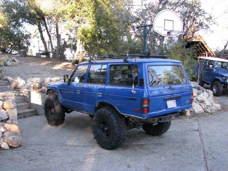

Having a hard time deciding on black or silver for the wheels. I always wanted black, but side to side I might like the silver. What do you think?
Old 01-29-09, 06:24 PM   #102 (permalink)

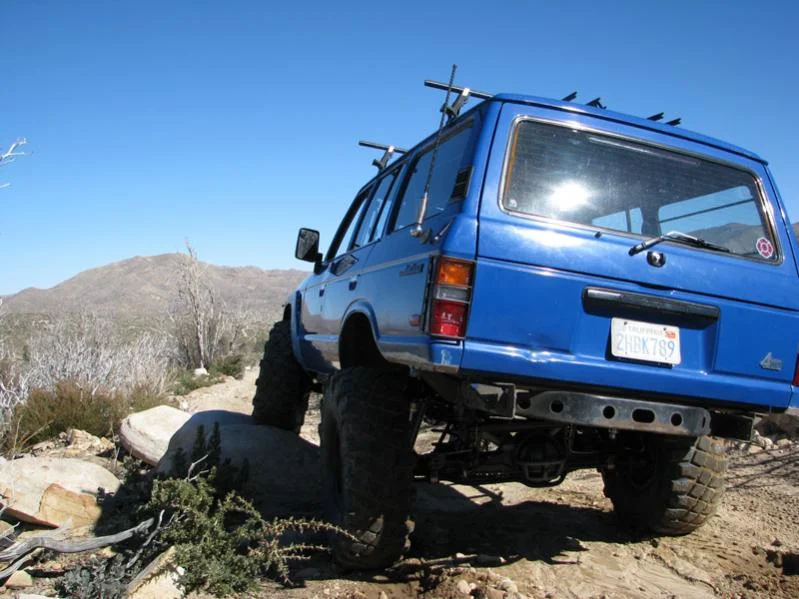

one more...

I vote for the silver wheels! Or paint the inner sections black like the 40th Anniversary cruisers (I think it was 40th)
Awesome work dude.
Whats up with the un-matching mirrors and only one tail light guard?

The silver may win. Something about it just looks right.
Obviously I still have a lot of work to do. The larger mirrors were cheap after-market ones and the passenger side glass fell out on the freeway and I haven't replaced it. The taillight guard just hasn't been put back on yet.
Thanks for the props.

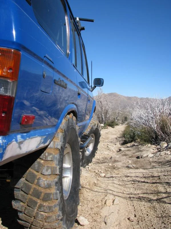

Nothing to extreme(no front drive shaft yet) just a nice ride out on a local trail. I had a couple minor issues, but the ride is smooth and the everything seems nice and tight. I left both sway bars on as well. I'm already considering options for lower tcase gearing. I'll start a new thread on it, but what are my options for lowers gears in my stock split case thats behind the 4l60e? I'd like to just swap gears or a direct replacement case. I want the last amount of work possible, haha. What about an 80 case?

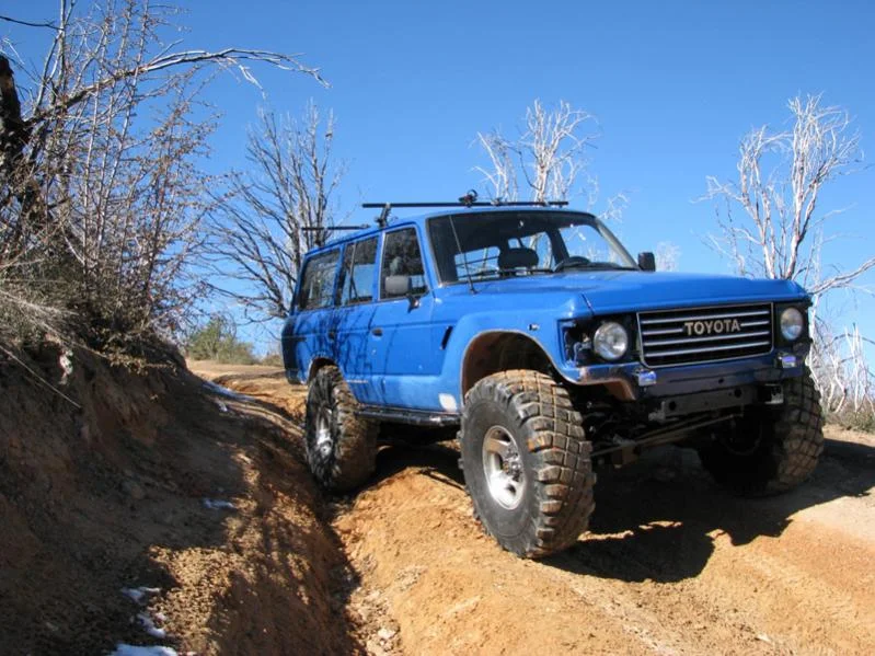

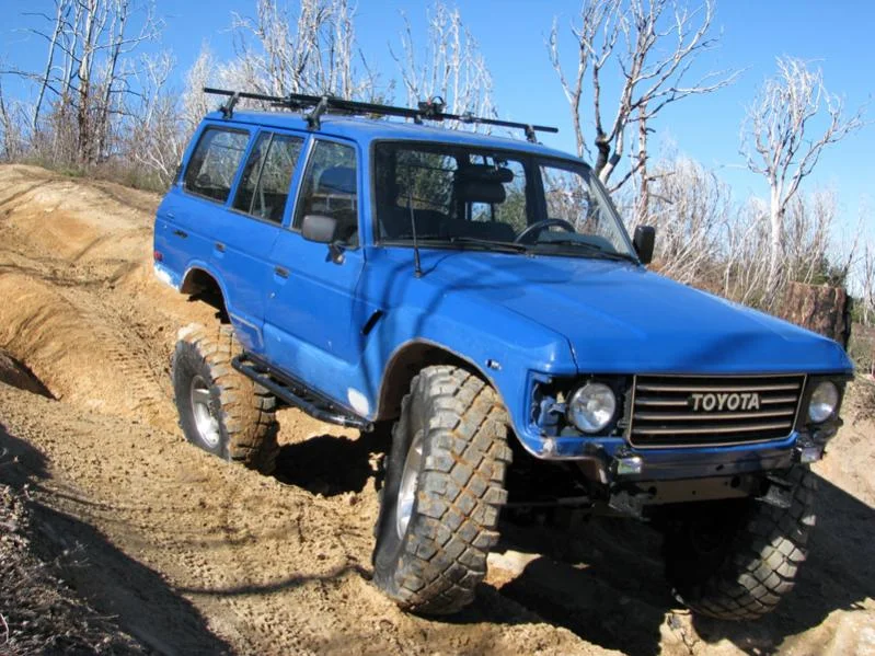

another set....
As you can tell, Im putting off the last of the body work as long as possible, I hate bodywork!

The front is running 2" Ironman lift springs and the rear has stock front 80 coils. I'd like to find a slightly stiffer spring for the rear without gaining any lift. Maybe a 4 Runner lift spring? Air bags? Custom coil? Any ideas?
Links are all custom. 36" lowers and 30" uppers. Don't remember the tubing I used but its all DOM sleeved with DOM, I have NO worries of them ever bending.
