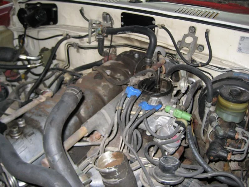

Now I couldn't find a tutorial about removing and replacing the carb, just some random bits of info spread out. So I figured i would write one for the new 60 owners out there.

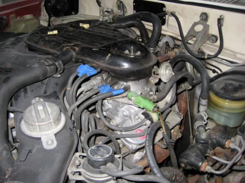

The removal process:
• Take note of the vacuum hoses. Most of these follow sets of 4 or 3. Instead of marking individually which would take too long, I instead wrapped up the sets together in their order. For an 84 FJ60 there are only 3 sets of 4 vacuum tubes.
• Disconnect the electrical connector, disconnect the throttle linkage by removing the cotter pin, disconnect the choke linkage by open the throttle all the way open then pulling out the cable and pin.
• Remove the top air filter housing
• Notice how dirty our air filter is and how much oil has collected and make a "note to self" to replace the air filter and PCV valve.

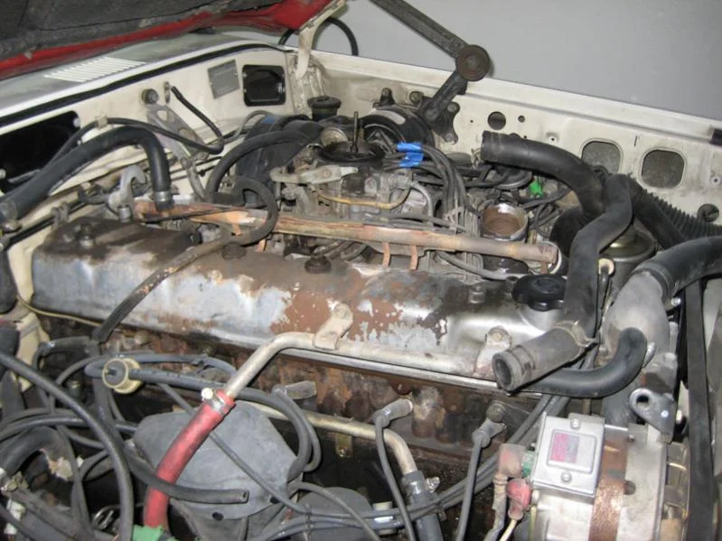

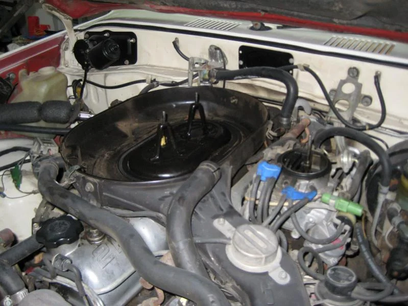

• Remove the bottom of the air filter housing by taking off the (3) 12mm bolts that are attached to the head and valve cover
• Disconnect and label the remaining hoses
• Be careful NOT to split the two rubber hoses connecting to the front of the air cleaner
• Note to self, replace two hoses on front of air cleaner
• Disconnect the air intake hose

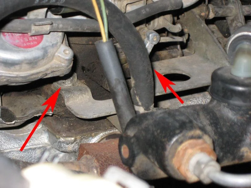

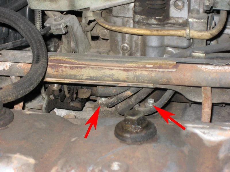

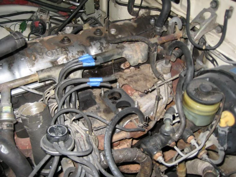

Taking off the carb was something that worried me. On the carb threads it mentions removing the valve cover for better access. Well I wasn't gonna do that unless I had a new gasket to replace it with.
• Note to self, replace leaking valve cover gasket
• The magic tool needed is a stubby 12mm combination wrench. this work NO problem. Within about 10 mins I had all 4 nuts off the carb and the carb pulled off....after I disconnected the fuel line with a 17mm wrench. Oh the things we forget.

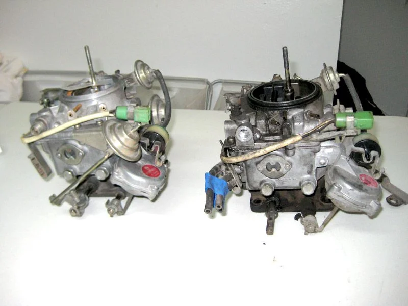

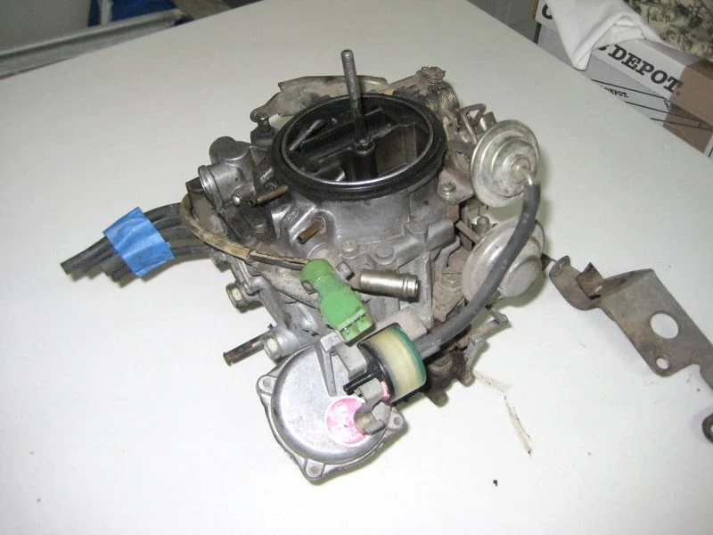

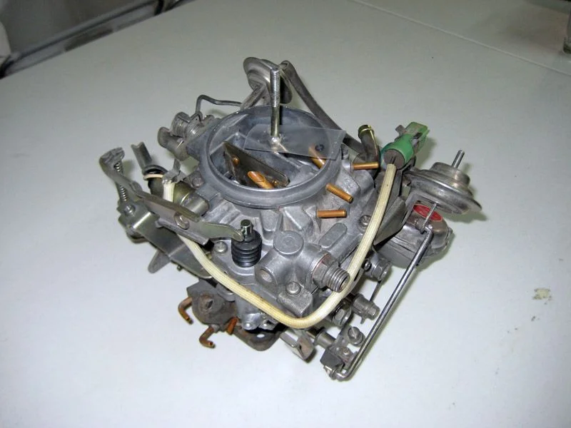

Now we have the old carb and the newly rebuilt carb side by side. Its at this time that you have carefully inspect all the sides of both carbs to make sure you are bringing everything over that you need to. It was here that I learned how to take out the Idle Needle:
http://forum.ih8mud.com/60-series-wa...crew-carb.html
Once everything is moved over then its just a matter off reversing the process back.

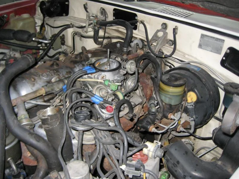

THE REVIEW OF MARK'S OFF ROAD CARB REBUILD
I have a new new truck. Its that simple.
Mark was great to work with, I dropped off the carb to him and picked it up without a hassle. Total came out to $331. I would have been better off using my original to be rebuilt instead of sending him a core. With the core he was able to totally play detective and detail every single thing that went wrong with the carb. Including how long it sat and what type of additives it used.
The carb came back to me clean as a whistle and ready to install.
After test driving it for about one hour AND NOT ADJUSTING A THING, I can honestly say this is the BEST piece of maintenance I have done to this truck so far.
• The truck now starts up WITHOUT having to repeatedly pump the gas
• The idle hovers at ~1000 RPM
• The truck glides smoothly through the gears without even a hiccup
• I do not notice any extra power per se BUT I have a feeling it was becasue I was running WAY too rich
• The truck doesn't stumble after its been warmed up
• The truck now has no flat spots when accelerating
• I no longer have the gas smell
• I now use Trojan Magnums (YMMV)
I will be checking my gas mileage over the next few days and I will report back on that as well.
