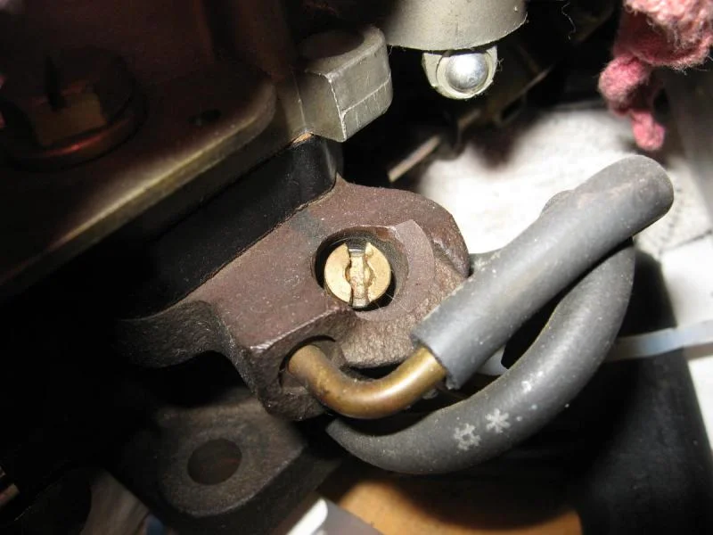

advice needed on how to remove a screw on the carb.
I just had my carb re-built but instead of using mine to rebuild, I used a core I had. Problem is I am missing this brass screw. I "think" its to regulate vacuum but not sure.
Now I've tried using a flat screw driver that is small enough to get in but it seems to be too narrow because it seems to be messing up the screw.
Here are the pics of what I need and where it's going. Any ideas on how I should remove it AND what about that aluminum piece thats around it?
Did I mention this is all I need to get the truck working so I can pick up my son from school? :P

I am 99% sure that that screw is the idle mixture screw. From the factory, it has a plug over it which needed to be drilled out and removed to access the screw. Is there part of the plug still in the hole preventing you from threading it out?

Idle adj screw. Thought there was an SST to remove it ? I think I've read where people have ground down a slotted screwdriver ... ?? Lemme look in the FSM

No, sorry, FSM says SST or screwdriver... Looks like it should just unscrew... May be corroded in there or some of the plug may be remaining... Can't quite tell from your pic.

there are two possible OEM screws in there, just depends on which one you have. one is sst and one is flathead screwdriver

That is actually the idle mixture screw. You drill out the aluminum cap when you are rebuilding the carb so you can adjust the mixture once you put it back on the truck. It comes sealed from the factory.

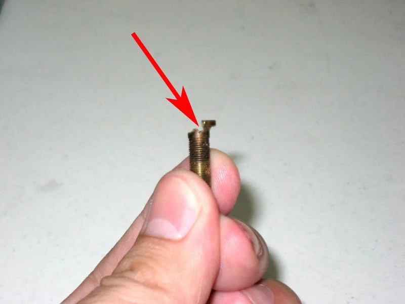

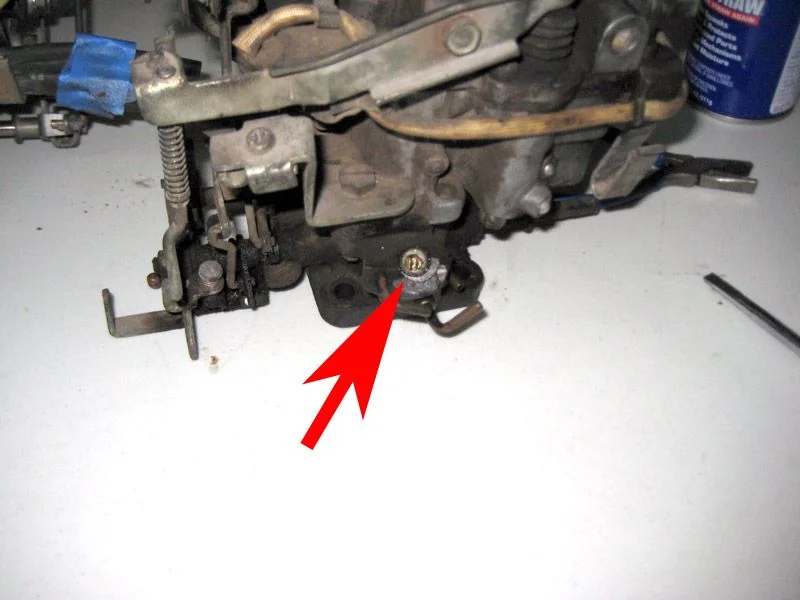

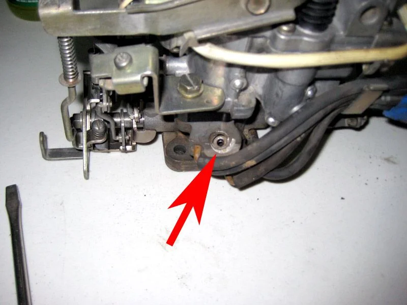

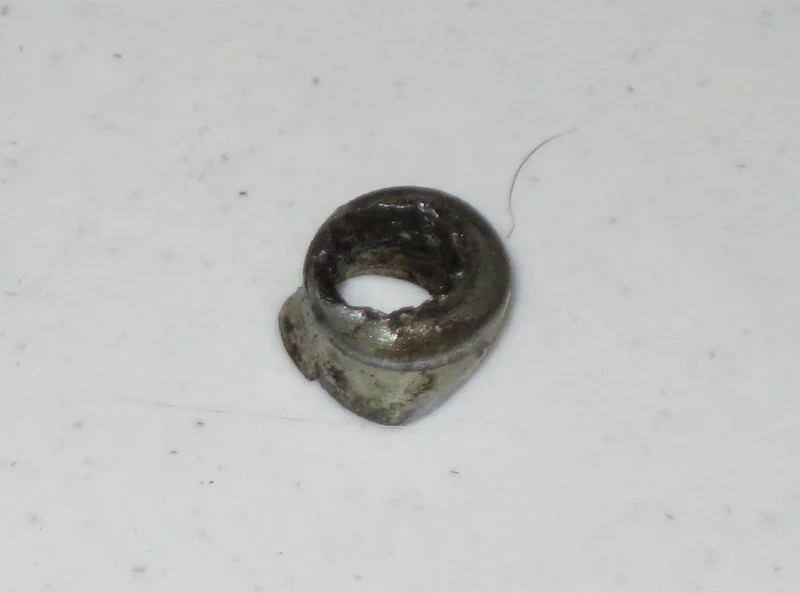

So here is the deal for those that don't know.
Of course this really only matters if you are rebuilding your carb but just in case.
Yes you need to drill out the plug that is there. Most already are for one reason or another. Mine was drilled so it was easy. I tried backing down the screw but it wouldn't budge. So I figured it was time to remove it. Besides, I needed it for the rebuilt carb. I just stuck in a screw driver and......
Broke the tip. Next screwdriver did the trick and it popped right out. Once gone I could see why the screw wouldn't budge. The head of the set screw was broken off on one side. Ugh. Took a little bit of effort but I got it out.
Now I dont have a spare so, I talked to Mark of Mark's Off Road and he has the suggestion to fix the problem.
All I had to do was take a hacksaw and carefully cut in a new slot for the screwdriver. Bam, it was done. easy peasy. Its not a permanent solution I think but it works.

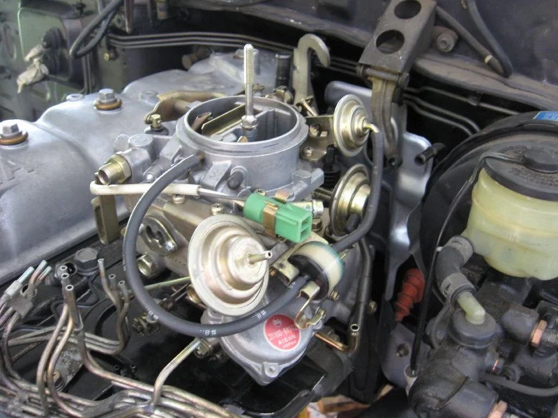

Can you identify where the idle speed screw is? I have a pdf from another posting on this forum that depicts it to the left
of the idle mixture screw, but shows it on the same side (valve cover) of the carb. The only possible one I can find on mine
(1984 fj60) is reachable from the driver's fender side, and even that one doesn't seem to affect idle speed.
I have high HC's on idle, and would like to run it lean at least until it passes smog.

The Idle Mixture Screw is on the side that is against the valve cover and is under the air cleaner. Pretty much impossible to reach. There is an adjuster screw on the front of the carb facing the radiator. That is to adjust for the A/C kick on. The other two adjusters are on the back side of the carb facing the firewall. The one that is easily seen is the choke adjustment. The one that is tucked back next to the body of the carb is the idle set screw.
Sounds like what you need is the screw that is next to the valve cover, the Idle Mixture Screw.
