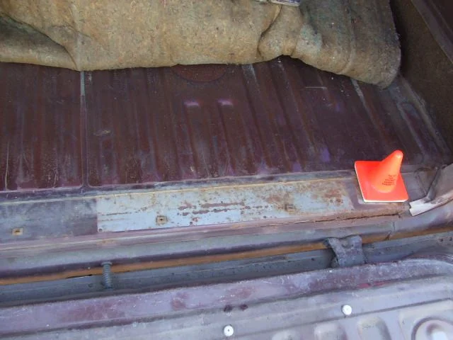

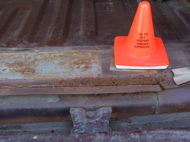

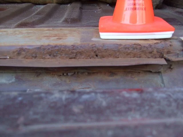

Look at a rusted our 60 and then a slightly rust 60. Focus on those areas first.
The frame looks nice but where they rust is between the rear cross suport and the actual frame. It is a "C" inside of a "C". It is around the spare tire area.
The next area would be around the rear wheel wells at the back bottom corner of the passenger doors.
The next area would be in the cargo area. Lower you tailgate and pull the carpet up and look in the righ hand corner of the bed. There is a seam there where it is assembled. That is the second place to rust.
I can post pics of these areas if you want.

I looked around the spare, I will check the other areas tonight. If it is clear of rust- do you think a shot of metal protector would give a good protection? If it is not too much trouble to post pics of the rear passenger and deck area I would appreciate it.
