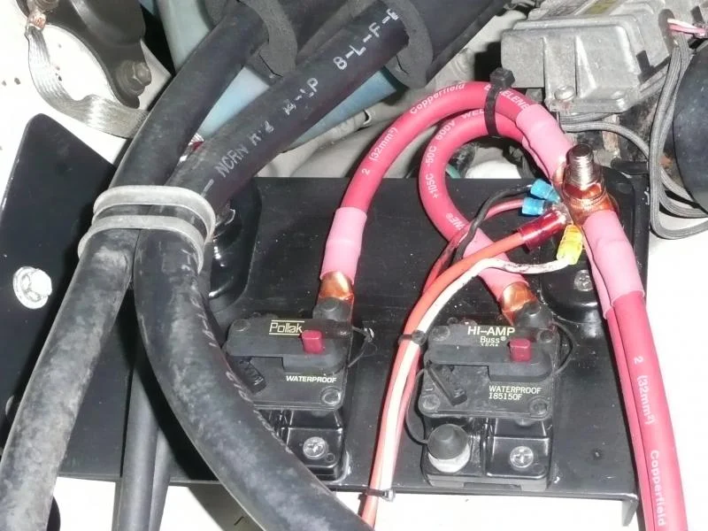

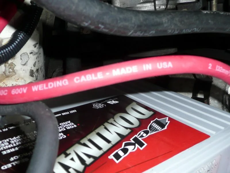

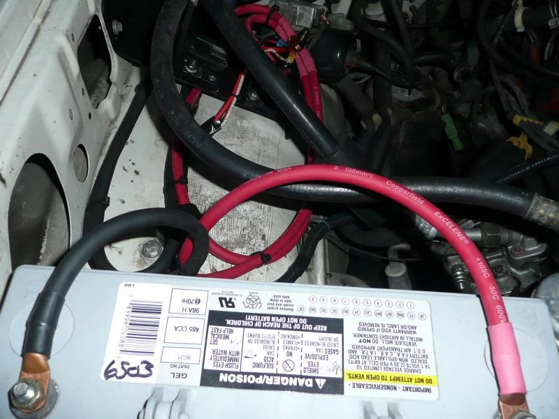

you can use welding cable 2 ga...same way that i use
