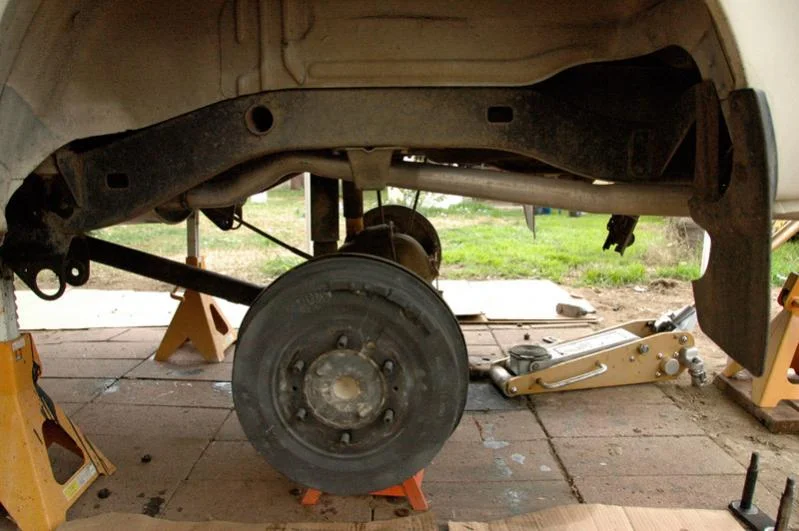

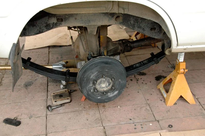

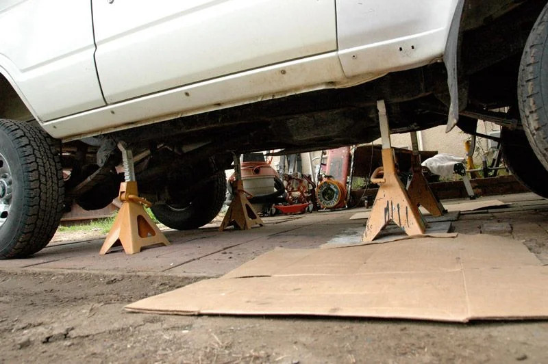

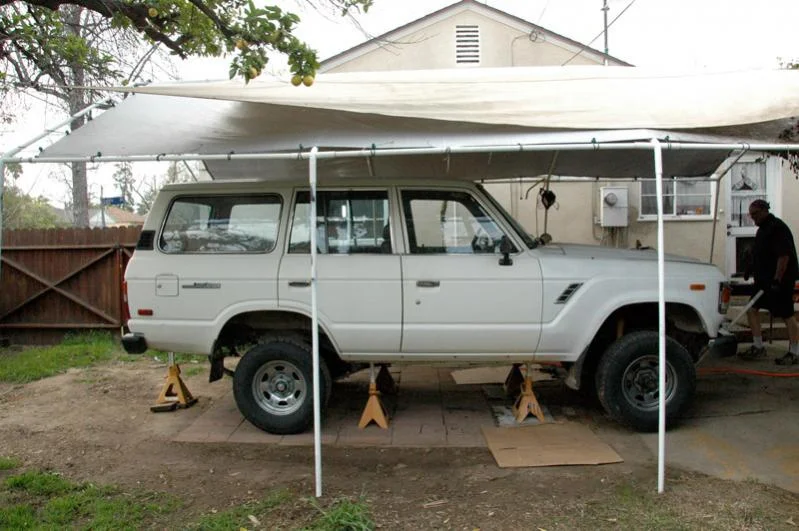

As promised I got some pics.
Sunday was spent at SPIKE's place with Mark A and Randy88FJ62 helping out. SPIKE and Randy attacked the springs after SPIKE and I spent the first hour or so getting everything ready and the truck level and off the ground.
Lucky for all of us that when the truck was over at Georg's last year he replaced all of the spring bushings. What does this mean for us? Imagine taking the spring bolts off, taking the spring pin ONCE and having it hit the floor....EACH TIME!! What could have easily taken all day with a torch and the Fire Department turned into just a few quick hours.

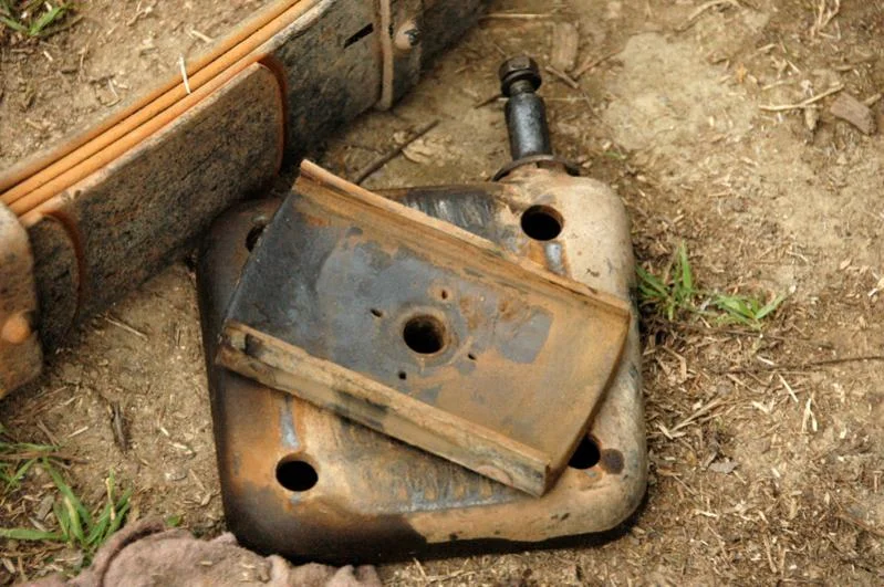

All the springs were off and the new set were getting prepped. I forgot to spray paint the U-bolts so I did that and painted the leaf springs because there was a little bit of surface rust on them. SPIKE and Randy would have finished it expect for two things:
1. I forgot the driver's side spring in my garage.
2. LCWIZARD sent me two passenger side spring saddles.

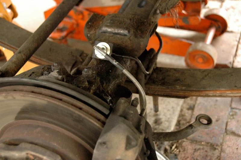

I took the opportunity to replace so far 2 of the 4 rubber brake lines. I still need to replace the other 2 and then bleed the brakes. Some notes about the brake hoses:
•*The female couple of the braided hose isn't long enough to reach the hard line. This means manipulating the hard line to get it to fit in. This was lame.
• The kit comes with a large washer but on the PS you need to curl the ends to get it to fit right in the braket or else the Jesus clip isn't going in without getting bent.

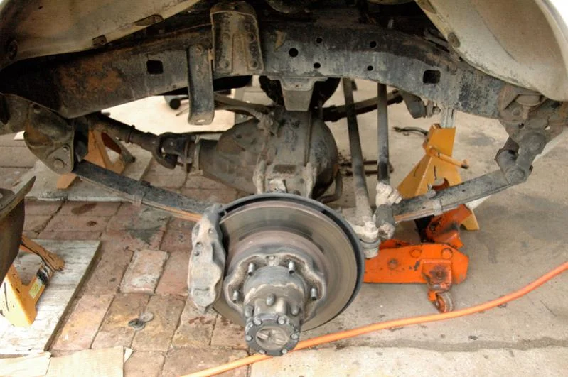

Some more lift pics mid way through

few more

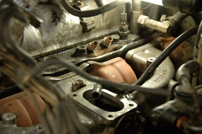

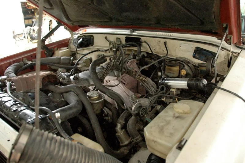

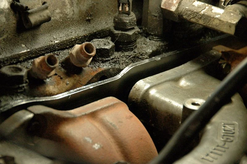

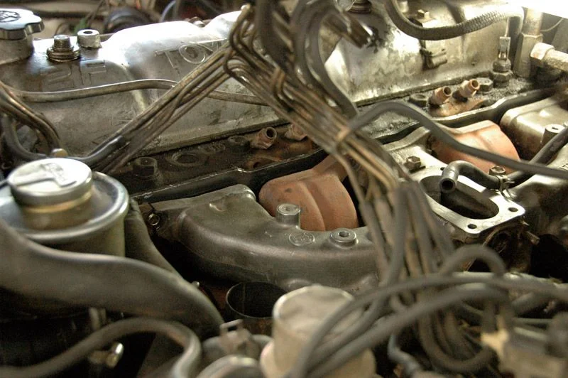

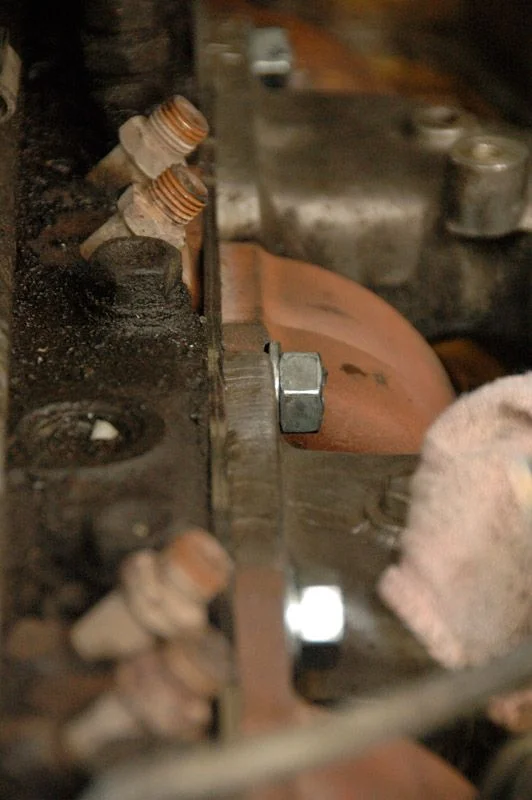

So at this point we moved to the exhaust.
It took the rest of Sunday to get the manifold out. In doing so I found that the brake booster hose had a large crack in it although I never had an issue with braking. While take out the air rail, the #6 tube twisted , the smog pump to air cleaner hose split and after taking off the manifold we found the take tell sign of a junk intake manifold; the hairline crack down the center of the throat. Its oh so small but large enough to wreak havoc.
Luckily Mark didn't leave for Katemcy yet so I got an intake/exhaust manifold set up, new air rail, another brake hose (I was short one), the hoses and another Jesus clip .
So this morning SPIKE and I wrestled that F'ING manifold back on. It was a good three hours to get it where it was supposed to be. Part of our problem was:
• we were using the REMFLEX gasket. This was the problem perse but meant we had to be extra delicate.
• we replaced the exhaust bolts with all new exhaust studs and nuts. This made maneuvering the manifold around the exhaust flange AND the J tube next to impossible because the #1 ram horn was banging into the P/S bracket. It took some "persuading" with a BFH (deadblow) but it went together.
WE set the torque to 14# because REMFLES recommends 14-17 MAX and we used anti-seize so we went to the bottom of the scale.
I also clipped on the carb spacer heat shield. This will make future torqueing MUCH MUCH easier.
So tomorrow will just be putting everything back together. I will of course still need to wait for LCWIZARD to send me the other bottom plate to finish the lift. SPIKE put the onld set on that side backon just so it can be driven in the mean time. I just wont be off-roading with that set up.
