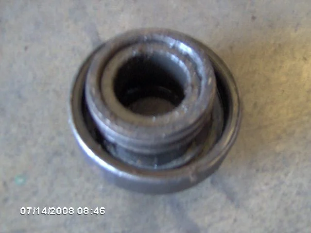

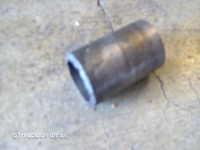

Looks like the the throw out bearing was history. Must look nice where the shot bearing and fork were trying to turn the clutch fingers into shredded wheat..

ding, ding, ding. we have a winner! but why did the throwout bearing fail?!

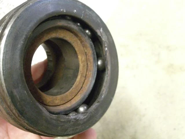

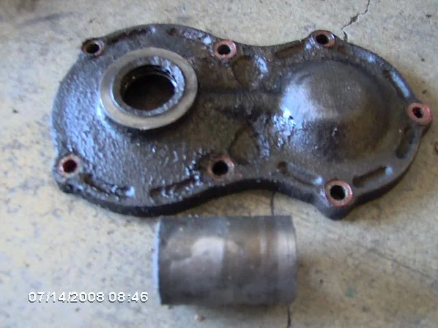

here's the last clue:

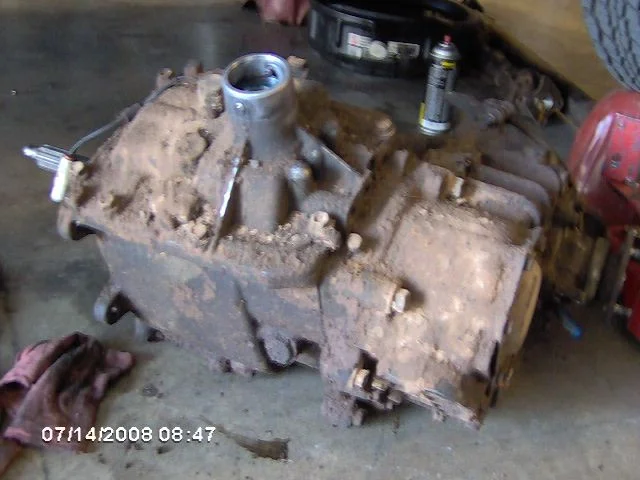

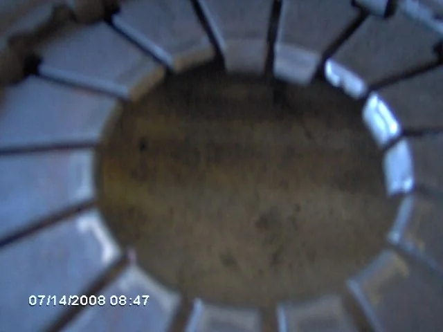

wow, these pics really suck. i'll try to do better next time. here's the trans after i removed it from the rig. lots and lots of reddish clay and oil..........

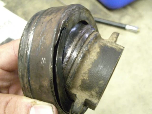

Let me take a stab a the guessing.
Somebody drove through some really deep mud and tried to shift gears while submerged. The mud and debris got between the pressure plate and flywheel. The presure plate wore way down and allowed the tension forks to over extend and break off. Or the debri held it back and pushed the pressure plate agains the throw out bearing until it began rubbing on the input shaft spacer.

great theory but you're WRONG also!

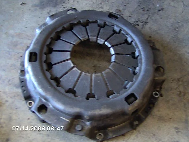

alright, so here goes. i think the throw-out bearing support ( snout on the front of the transmission front bearing retainer ) broke off after having been cracked due to an improper previous clutch replacement attempt.
this in turn caused a mis-alignment of the throwout bearing to the pressure plate, causing the bearing to fail and wear thru the clutch diaphram fingers.
either way, it's fubar'd. but i have another front bearing retainer and clutch kit in stock. right now i'm waiting for a new front seal and bearing retainer gasket from toyota and the trans will be ready to go back in. both the trans and t-case were low on oil but the oil did'nt look bad so i;m not sure if it was'nt filled all the way or if there's a leak. i did'nt see any obvious signs of leakage. i did replace both t-case output seals since they were rock-hard.
once we get the new clutch and geartrain back in the rig we can take it for a test drive and see what else we need to fix.

last pic for the day:

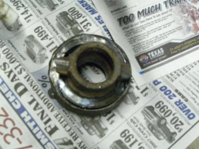

From what I can tell both the slave and master are both fine and there is plenty of fluid BUT I didn't have another person around so I really can't be 100% positive. I did know before buying it that the throw out bearing was making noise. When I finally test drove it myself it didn't sound as bad as I thought it was going to be. In fact any throw out bearing issues didn't translate itself through the stick. In other words I couldn't feel a wobbly bearing through the stick shift. What sucks is I could replace all of this myself but I couldn't take a bag of tools on the plane so I had nothing in the truck.
My guess was gonna be the throught bearing failed but it was revealed already... and also with a bad throughout you wouldnt feel it in the shifter... it would be felt in the pedal if anything.
Quote:
Originally Posted by NLXTACY View Post
This would be a negative. At the point I left the truck you could no longer get the truck into gear, at all, any gear. And the retched smell of burning clutch was really overpowering. Something locked up. Even though its technically in neutral, the tow operator and I could not push it. But the winch could get it to roll when it was getting onto the flatbed.
mine did the same thing as you describe above in both post. it turned out to be my throughout bearing came apart and no longer hit on the clutch fork, it died died on the tollway in dallas, so i shut it off stuck it in gear and started it up, shifted it with no clutch the 25 miles home too, only thing that sucked was stoplights having to shut it off and start it back up, so it was kinda a slow take off process but on the road was no biggie.
the three images are of my T/O bearing after i got it home then proceded to drive it yet another 30 miles with no clutch to my new house. Why? cause i knew it would go so why not drive it?

When I was in collage my 60 did that. The cheap replacement (Chinese) TO bearing seized. I was broke at the time and could not afford to fix it properly (Toyota parts). So I only used the clutch with the seized bearing for 1st and reverse. Eventually (about a year later) the bearing finally machined its way through the fingers on the pressure plate. I was able to pry the TO bearing out of the pressure plate and tie the throw out arm back and still drove it for a few thousand miles by shutting the engine off at a red light then starting it in gear. Ahhh... the good old days.
