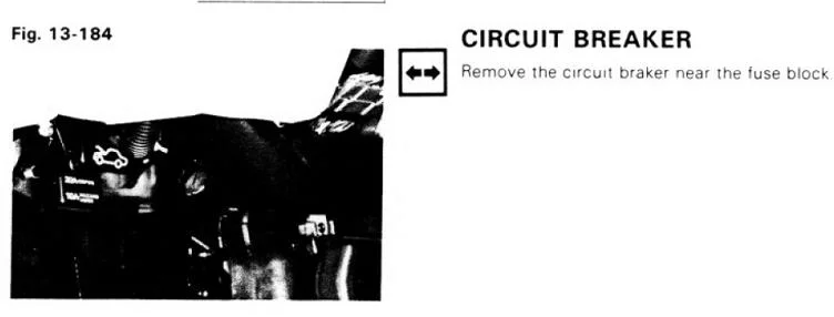

I think the fuse box changed sometime in 1983. You most likely need to reset your circut breaker. It is located under the dash to the left of the steering column (Fuse Box side). It is round and about the diameter of a quarter with a small hole in it. push a paper clip into the hole and you should be good to go.

This is from the FSM for the early 60 series. The picture is pretty bad, but the circuit breaker must be near the hood release, probably somewhere below the fuse box.
