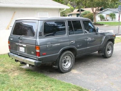

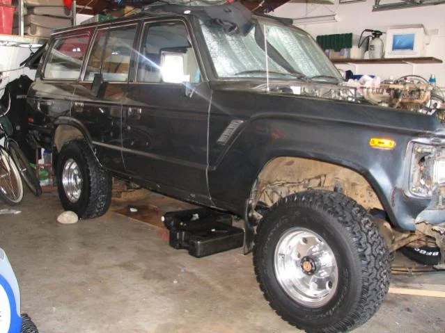

I just installed 4 man-a-fre add-a-leafs. It was a major pain but I think it was worth it. The front end is sitting a little high but I think thats because 1/2 of the engine is out of it right now. The guys at MAF(very helpful i might add) told me that the springs would settle a little bit(i hope). I have BFG AT 31x10.5x15 on there. I would have gone with 33's but I dont wheel much at all and I didnt want to have to regear. Anyway, good luck with your decision. Here is some before and after pictorial visualization that we all love so much.
Paul

Thanks Trapper,
Not without my share of blood, sweat and well... more blood. Especially from the knuckles(mine not the cruisers). I sure am learning a lot though.
Thanks,
Paul
