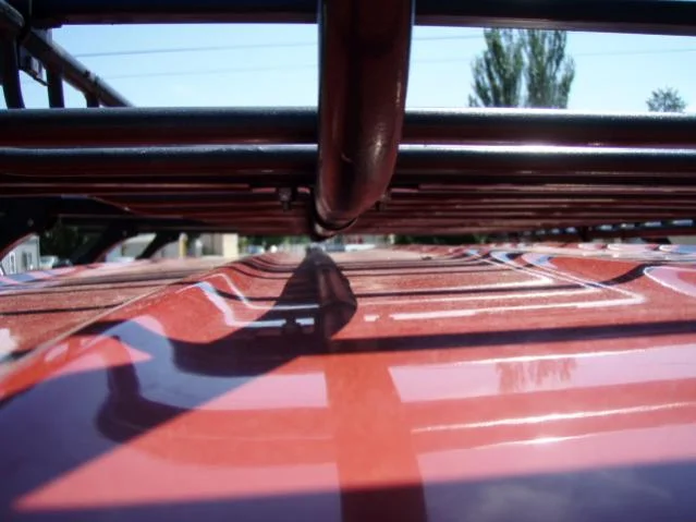

I mounted the rack under the bars with u-bolts a got from the local hardware store to keep it as low as possible. I still got about an 1-1/4" between the roof and the rack so I think I'll be ok on flexing as long as I don't use it to transport my pet elephant. I don't think she'd like it up there anyway......

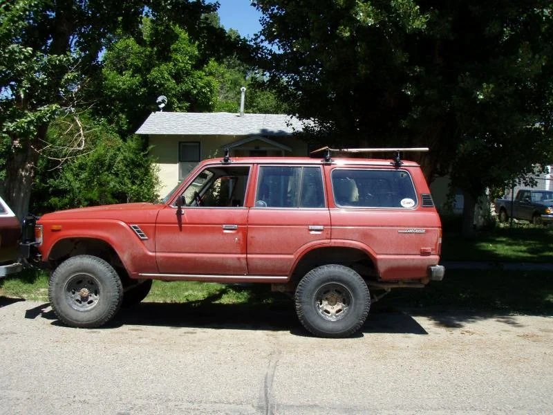

Before with old roof bars.

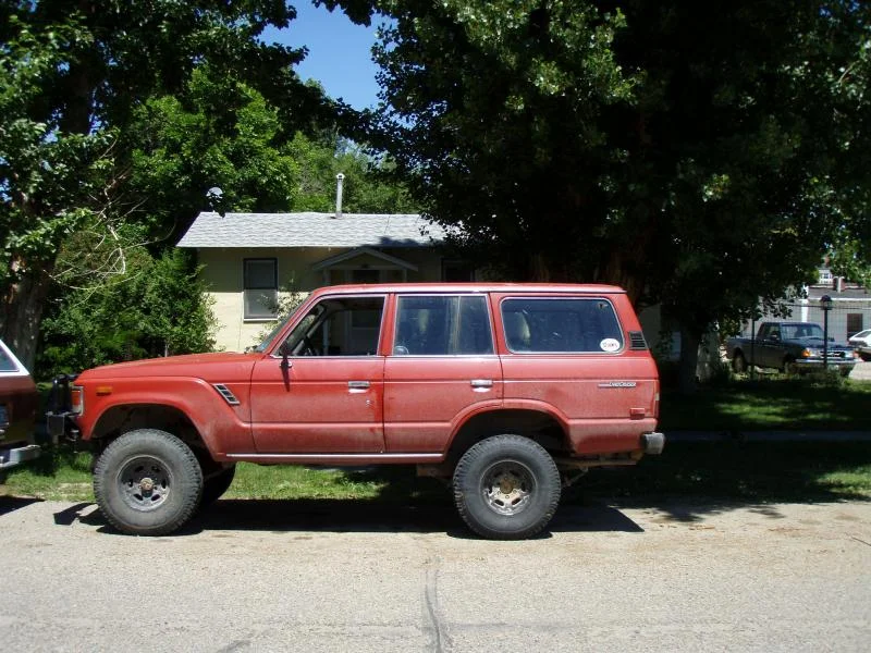

No rack..

Dirty but solid gutters.

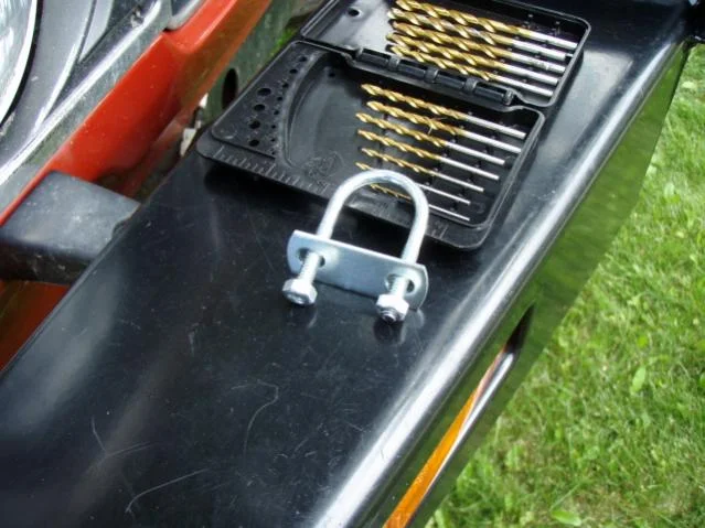

Hardware ie u-blots.

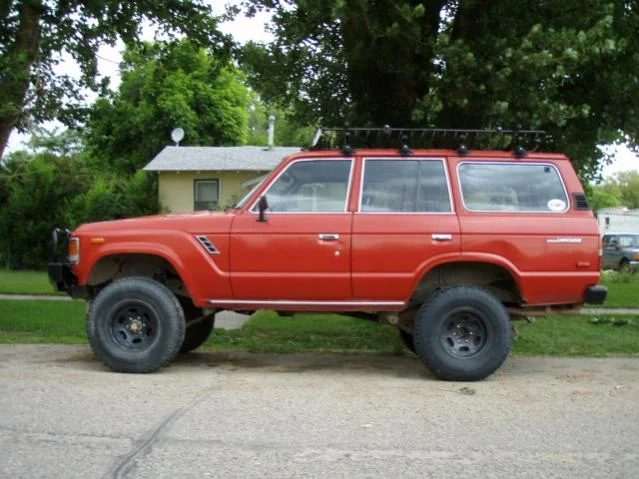

Rack on!

Last ones.

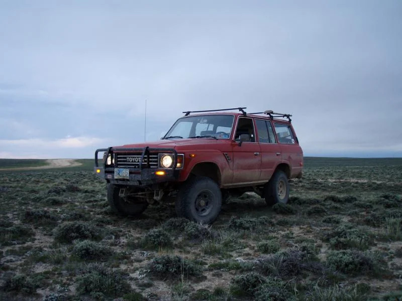

While I'm at it...
Well since I'm at it here's a photo of my Cruiser in it's "natural" habitat.(Before the rack)
Hope you all enjoy.

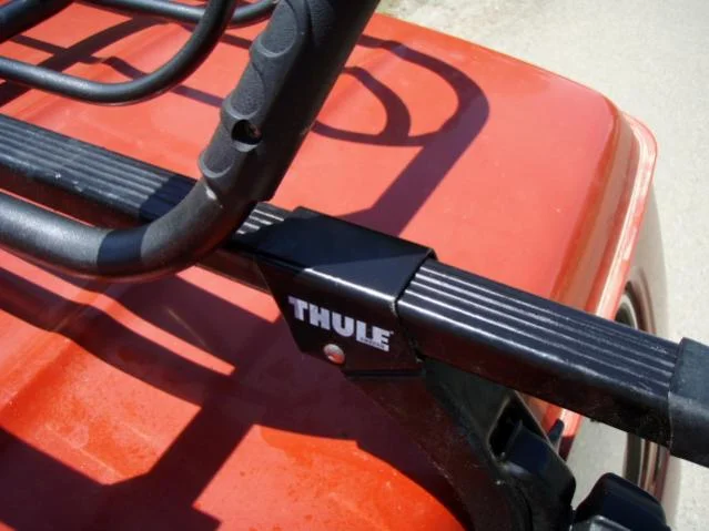

Now you have to add some screws so the cross bars do not slide out of the side clamps. Put some weight up there and you will see what I mean. The little allen bolts do not allow enough clamping force to firmly hold the bars in place. I lost my RTT while wheeling.
Hmm.. I was kind of thinking the same thing. Were the bar goes through the mount? Mine does not even have any allen screws or anything.They're kind of hinged,see the shiney metal part below the writing. I think the idea is that when they're loaded the hinge action forces the mount into the rubber therefore making it tighter. But I think I'm thinking like you. I'll probably put some machine screws in it.
You mean put some screws in this area right?On the flat part above the "Thule"
