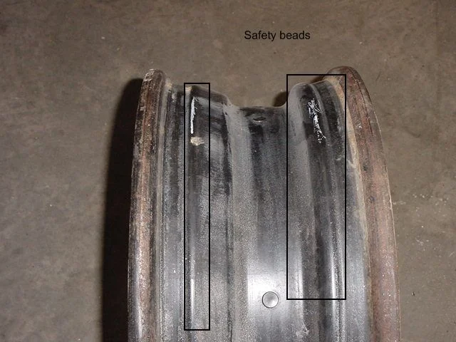

Hmm, whats a safety bead? Its going to be an on and offroad vehicle.

It's not accurate to say that ALL 16.5" wheels do not have a safety bead, but most do not, and if I can poke around google images, I'll dig up some pics to help ID the safety bead.
Edit: Here's a pic illustrating the safety beads, (look at the extra 'bump' about 1" inboard of each outer wheel lips) and the pic was captioned as a "16.5" tire" but I can't vouch any further for the validity.
Basically, the safety bead is an extra lip in the wheel that helps retain the bead. At normal road pressures, it won't matter, but at offroad pressures, it becomes much easier to lose the bead.
