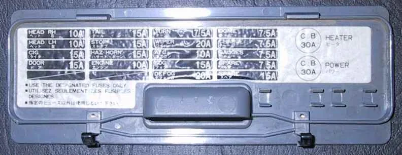

There is a circuit breaker as well as a fuse. The circuit breaker is mounted next to where the fuses are. It's cylindrical and silver with a hole in the middle. Unlike fuses, it can be reset. It's the 30A circuit breaker labeled as "heater" below.

like a charm, thanks for your response, chiltons had nothing about a breaker. thanks again, chris
