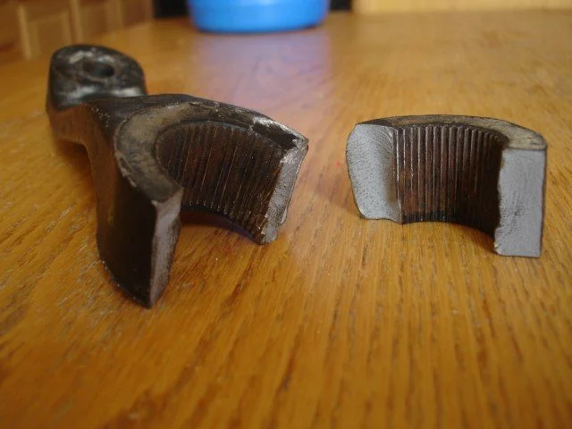

Did some wheeling this past weekend in the Sierras...
BUSTED my Marlin Pittman arm about a 1/3 of a mile into the trail.
Fortunately I was wheeling with some great individuals who went to GREAT LENGTHS to get me out...(Mudders; Jack, calicrusier, LX450 and Silverscout and Hoser).
The details of that are not pertainant to this thread, however, what I found out about the pittman arm is...
The following day I contacted Marlin regarding this break...Apparently a couple years back (when I did my SOA) Marlin was obtaining their pittman arms from an alternate vendor (to remain nameless) and they did a recall on TWO types.
They are both 100% cast. ONe had "NC" or "MC" stamped into them, and the other had NOTHING stamped into them. They are wide, with a seam down the middle. They look beefy as hell, but looks are decieving.
I had apparently been one that had NOT been notified by Marlin of the recall, to my (and the others listed above) misfortune.
The guy at Marlin stated the he was surprised that it had lasted as long as it did...They have since stopped using this vendors product r/t this issue.
So be aware, if you bought a Marlin Hysteer kit, and or have used a Marlin pittman arm, double check that you DO NOT have this arm!
Apparently the arm that has a tig welded rod end hole is the GOOD ONE!
I would recommend that if you have any question to contact Marlin Crawler for verification.
They DID TAKE CARE OF ME on this and have shipped me a new one, free of charge and shipping, even though it was out of warrenty by a year.
For future, I will be carrying a spare!
Hope this helps someone!
Chicago

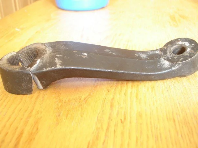

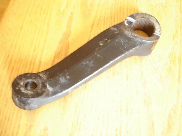

Here are a couple of pics of mine for referrence!
Chicago

Hey all,
Just got back in town...
Sorry I couldnt respond sooner.
On the sound...it wasnt a loud bang. It actually sounded like my MT's hitting the fender well bolt (which is common for me). It gave me some pause to where I thought "that was weird sounding"
Ive never had an issue keeping the nut tight.
I arrived home today to find my new pittman arm. Its the Marlin arm, and IT has the "MC" stamped into it and it too is cast without welds...I was mistaken that all the cast arms had issues...I called Marlin again for clarification. The guy said that if this one breaks, then there is an issue with the geometry somewhere.
Chicago

FWIW, the parting line (the seam) of the one pictured above is wide enough to be a forging. Parting lines in castings are classically very narrow, nearly knife-edge widths.
I'm curious about how those came to be considered castings.
Failure looks like a one time, brittle failure overload. No obvious fretting & "beachheads" visable. I'm suspecting that heat treat or alloy choice, or both, is the root of the problem.
