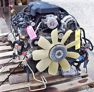

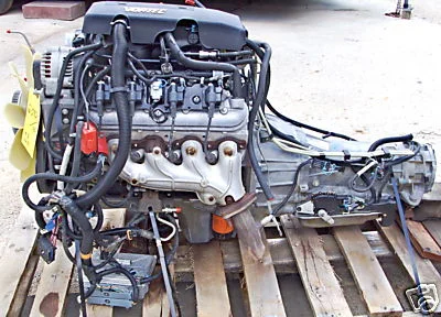

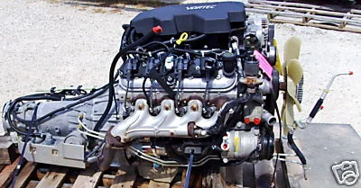

Finally ended up with a 5.3 Vortec/4L60E combo and will start on the conversion within the next couple of months while getting the rest of the parts together.
