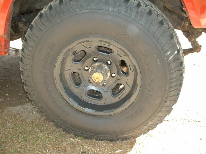

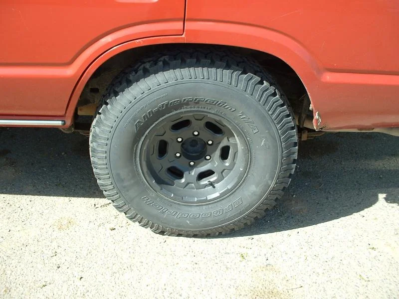

Heres some picts of the wheels. I can take some more pictures of the back side and such tommorow in the daytime if you want me to.

Quote:
These wheels look good!

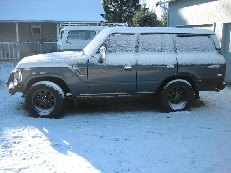

18"x8" Mojave's - 285/65/18 Toyo's for the DD. Got 'em when they first came out... 3+ years ago? I love them and still get TONS on compliments! I wouldnt recommend for off road as I have one small chip from a torque wrench?

Quote:
Thanks PAFJ.
I like the way those 18's look too,not very practical for off road use as already mentioned but still, a good looking wheel. Kudos to you highcruise55 looks like you have a nice rig too. The finish on my wheels have held up pretty good,I do have a couple of nicks though.
