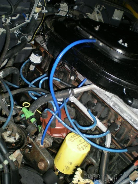

Well i was thinking of making it like this pic... would it still leak like this?

On an engine in decent shape a closed PCV system saves a lot of smog for very little performance cost.
When I had a bad #5 cylinder my PCV system moved enough oil to coat the inside of the intake manifold (which isn't good for the environment or performance). I put an air/oil separator inline. It collected about a tablespoon or so every tank of gas. I simply emptied the canister back into the engine while filling up. My engine is now in very good shape (recently rebuilt) and moves a very small amount of oil through this line (probably 2,000-4,000 miles before I get a tablespoon).

PCV is good.
Just connect a hose from PCV valve to PCV fitting on intake.
Done.

alrighty then, thanks jim, ill just cap off the tee on the stock hose, would that work just fine, or should i run it direct?
btw, jim, you have time to rebuild a card and dizzy?

Leave the tee connected to the HIC valve on the air cleaner.
It too is a Good Thing(tm).
I have time to build a carb and dizzy, if you can wait for 6weeks.
