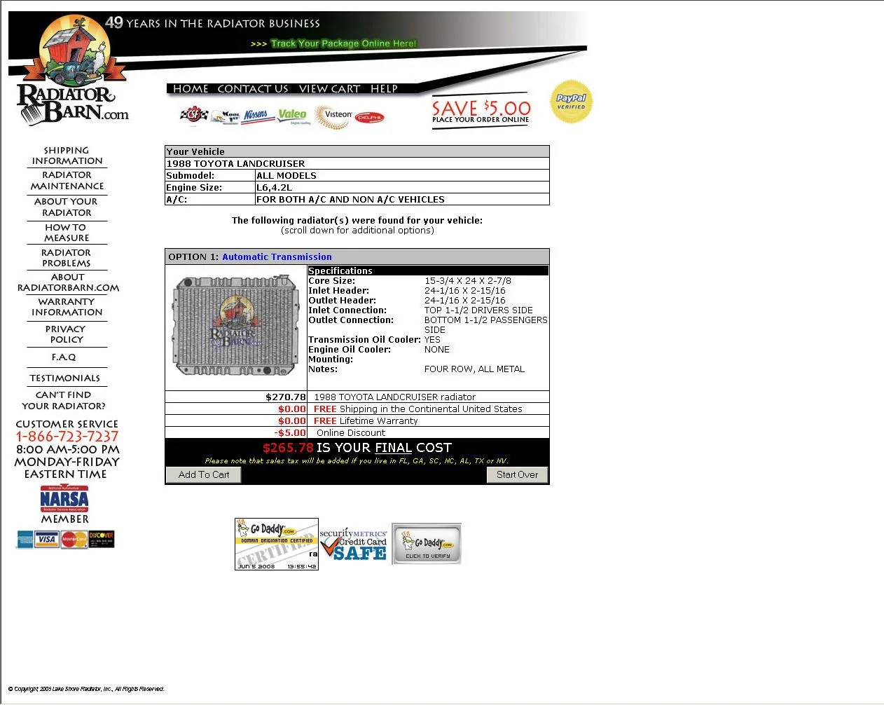

$270 Radiators, automotive radiators, condenser, oem radiators, truck radiators

What is this one made of?

Randy, I'm not aware that the 88 year is any diff than the 89-up. Here's a cool cruiser's of Texas linky that shows a common bolt-in rad.
Radiators
Two issues some guys have reported with this rad (same one avail from more than just CCOT) are shipping damage, and the filler neck having a less than 90 deg orientation on the upper tank(makes for slower filling) otherwise it requires no mods. Just bolt the old mounts from the old rad, and install.
I installed one from Radiator Barn listed above over 2 yrs ago, and it too was a bolt-in affair. A few things your supplier is saying ain't jiving.
