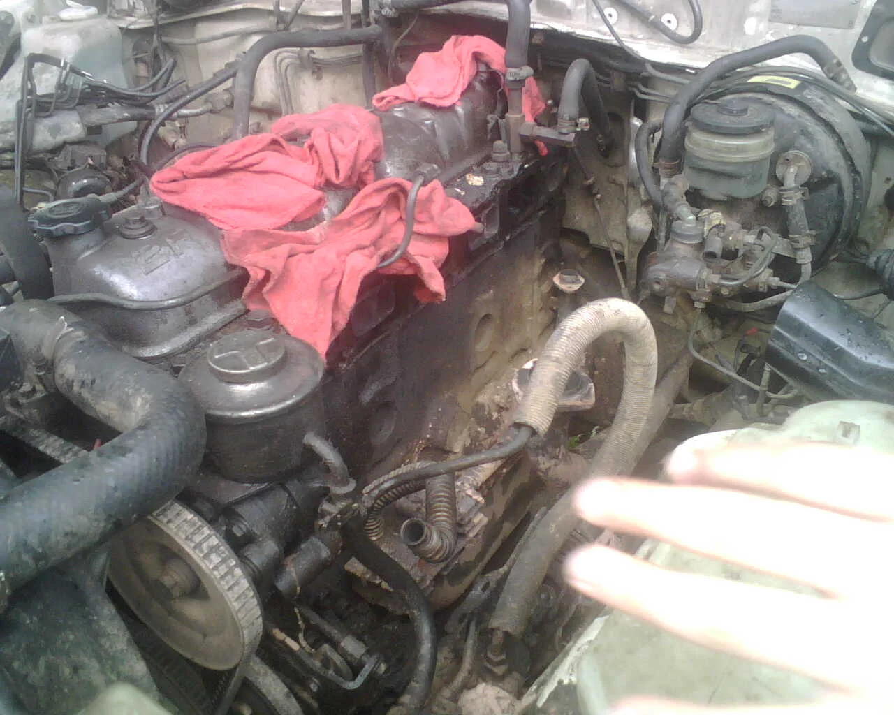

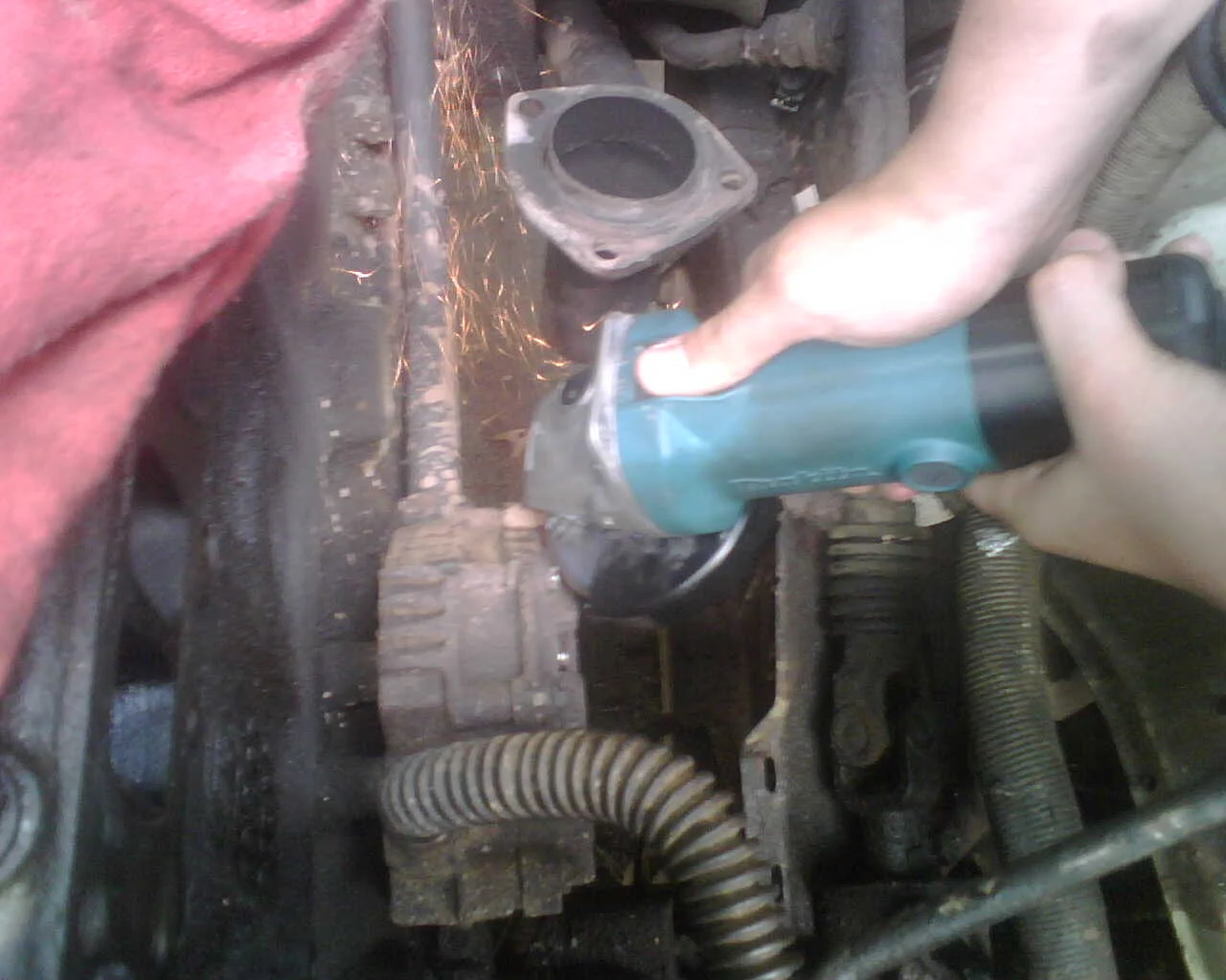

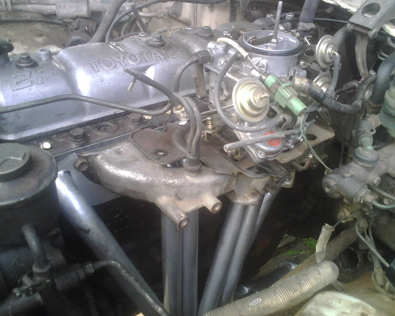

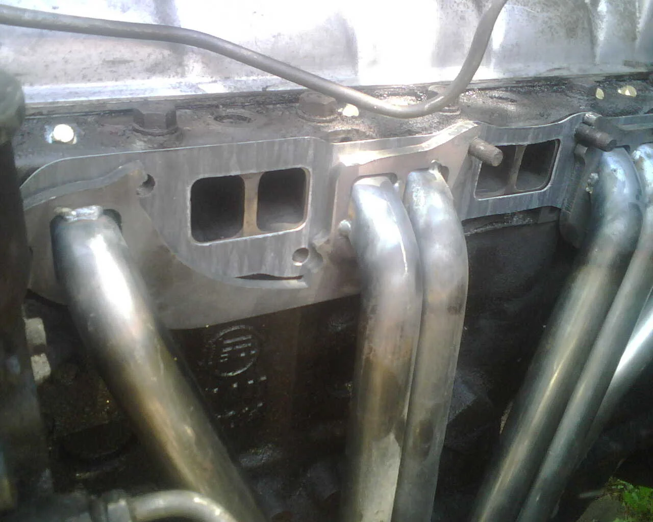

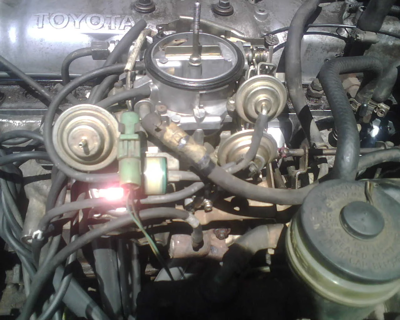

Just finished tuning up my truck after gutting the entire emissions system, manifolds and rebuilding the carb. I reused the carb insulator plate, even though half of it is missing, but I think that all in all it came out pretty awesome.
Here are the headers: New Headers. The gasket that they come with is a pretty low quality unit, and is not the same as the one pictured. The one they send doesn't have crush rings. The gasket is probably going to leak, but I like working on my truck and without emissions it's going to be an hour and a half minute job to swap out the manifolds now.
Before putting the headers on, I painted them with some 1200 degree header paint so slow the rusting process. Note: let the paint fully cure before running the engine. Burning header paint smells horrible.
As for the emissions, I kept some of the systems because some of them actually help the truck run better. I kept the PCV, EVAP, SC, HAC, HAI, HIC, CB and the Deceleration Fuel Cut systems. I also tried to hook up the Choke Opener system, but it was eating too much vacuum so I plugged it. I'll figure that out another day. In short, there's still some tubes under my hood and it does look a bit like spaghetti, but for now it's working really well!
Tomorrow I'm having a new 2.5" exhaust put on with a 40 series flowmaster, so I'll post up some pics when that is done. Without an exhaust at all, it's LOUD!! Holy hell do the headers resonate.
The story is in the pictures, and you guys have all done the manifold install before, so it's not too much different.

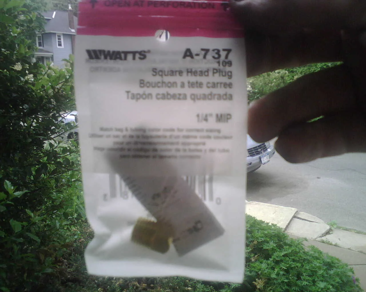

More pics....

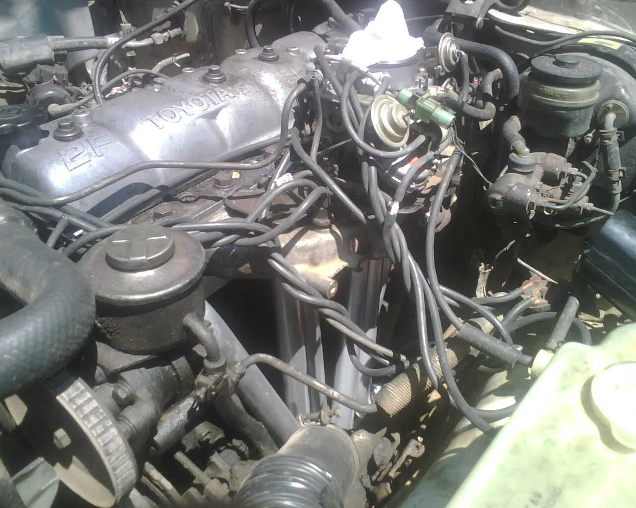

the last one...
As you can see, I modified the PCV tube that bolts to the front of the intake manifold. Like others, I cut off and capped the portion that used to go to the EGR valve.
Anyone else install headers for a desmog??

The original F gasket is the best you can get for that. It has the siamesed exhaust ports separated with a steel wrapped rib and will work well with your headers. I never had one fail as long as I got the header tight against the head.
Really? I wish I heard about that before I put mine on. Oh well, like I said the process probably takes a bit more than a couple of hours now, so when this one fails I'll swap out to that one.

Little update: evap, choke opener and spark control systems are going to leave as well due to some advice from Kevin. I'm also going to advance the spark to 13 deg BTDC to try to get a bit more power and mileage out of this pig.
My carb leaks gas out of the two bolts in the float bowl, but changing out the crush washers should fix that.
On a good note, I've gotten 13.79, 14.23, 14.56 and 14.89 mpg on the past 4 tanks, so that's an improvement! That's mostly city too, so that's about a 1-2 mpg improvement.
After I get my lazy butt off of the forum, I'll go make those tweaks and report on the mileage.
