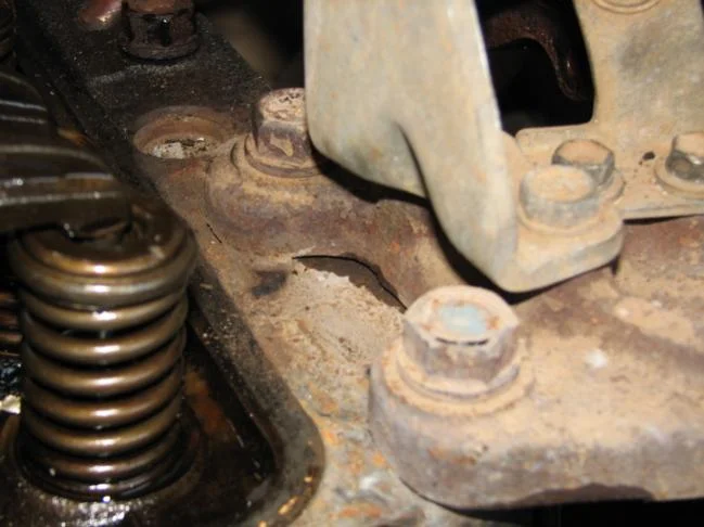

Do these two bolts attatch to the block(the big ones that look like head bolts)?
If so, how do you re-atatch them to pull the head off?

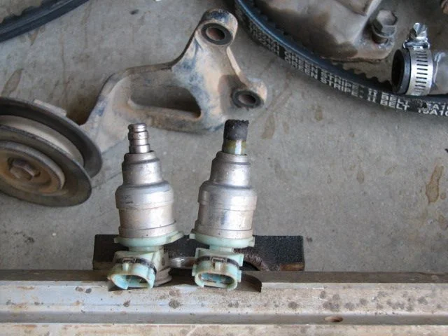

Also, 3 of my injectors look like the one on the right. What does that mean? Do I need new injectors or can I clean them and put them back in service? Also the intake manifold has black residue in the ports. Do I have a more serious problem then a HG?

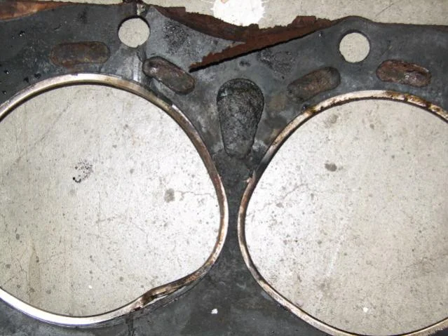

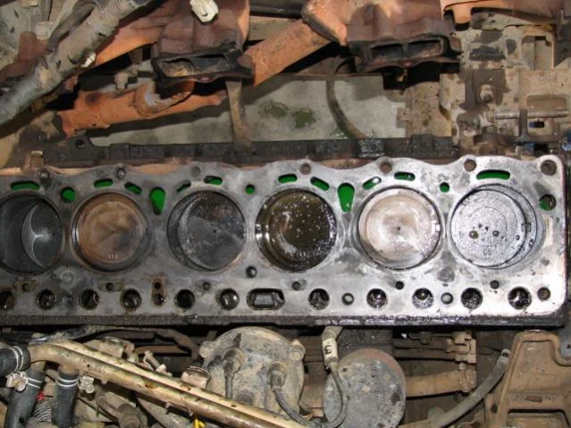

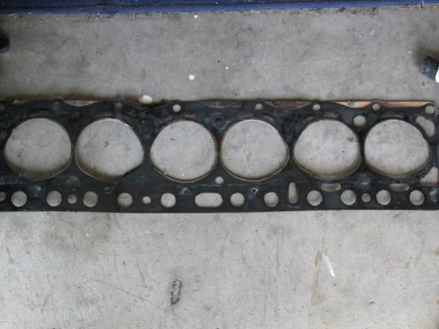

ok, the head is out and the gasket looks pretty warped. Im not sure what to make of it as far as where coolent might have been getting through but here are a few pictures to see what you all think.
The metal area around #2 got a little bit dinged up as ot came out.

Here are my thoughts. Yes, those two bolts are head bolts. Those two hooks are to remove the entire engine, not just the head. I pulled my head by myself with no hoist, so it is possible but if I were you I'd use a bolt into a threaded hole (like a rocker arm bolt) with some chain.

I can't really tell from the picture because of the flash, but are the first 2 pistons clean (shinny)? The gasket looks ok to me. If you have clean pistons it usually means water is getting in the cylinders. Carbon build up is normal.

Make sure the head goes to a machine shop to be checked for cracks. Hopefully it's just the gasket, but you never know.

Looking at the injector picture:
The dirty injector is normal.
The other (clean) injector is missing the plastic nose that is supposed to be permanently crimped on the nose of the injector. Look down in the injector socket for that piece(s).
