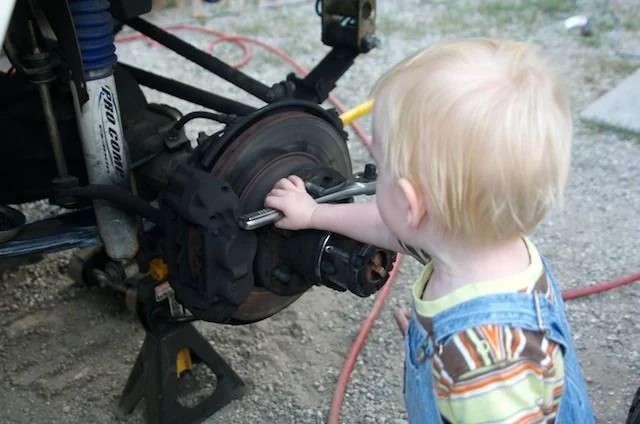

I did it...finally I did it!
Several months ago, I purchased a set of DBA Drilled/Slotted rotors. They've been sitting in my garage since. I finally said enough is enough and went to it yesterday. Here's some before and after pics.

More Pics, my son decided he wants to be an addict like daddy...
