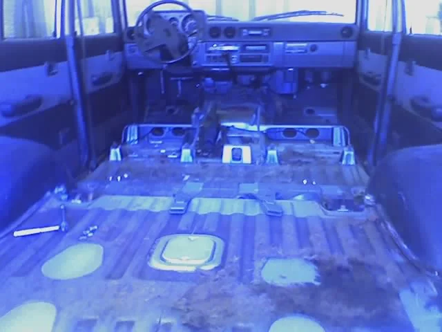

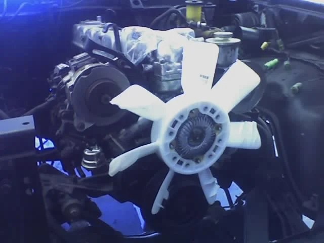

The rebuilt engine is nestled back into the frame. And the interior is approaching ready to paint stage. However she sure looks funny without any wheels and axle's.

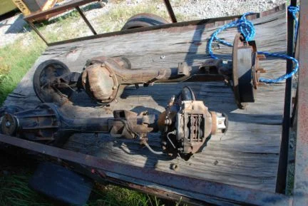

Off to the diff shop for the lockers and a compleate rebuild of all seals, gaskets etc.

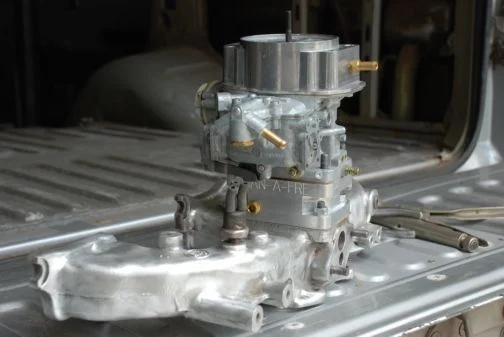

Dry Fitting the webber and adaptors to the manifold.
IndianDoc is offline   Reply With Quote

if that weber doesn't work out.. i have two extra 60 carbs.

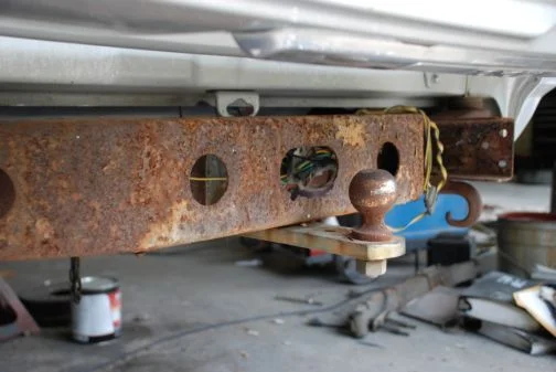

None could not believe it. However the rust on the rear cross brace is bad but that's comming out to put the 4 +bumper on. Name:  DSC_0035.JPG
Good to know I've still got mine too.

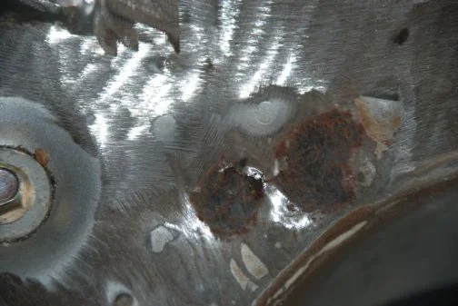

One small area near the wheel well perforation into body tub. Welding in new steel today or tomorrow.Name:  DSC_0031.JPG

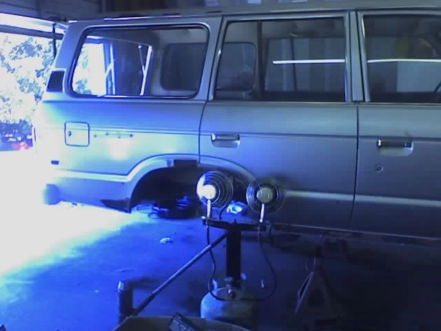

Is a common site for rust but they have been poked and banged pretty good, the photo shows the new steel that has been welded in and the thin layer of fiber filler over the pinholes etc. in the rockers they were rusty but over all in pretty good shape. the one rust rear fender panel and the rear cross brace had the worst rust. I was really surprised. Name:  DSC_0026.JPG

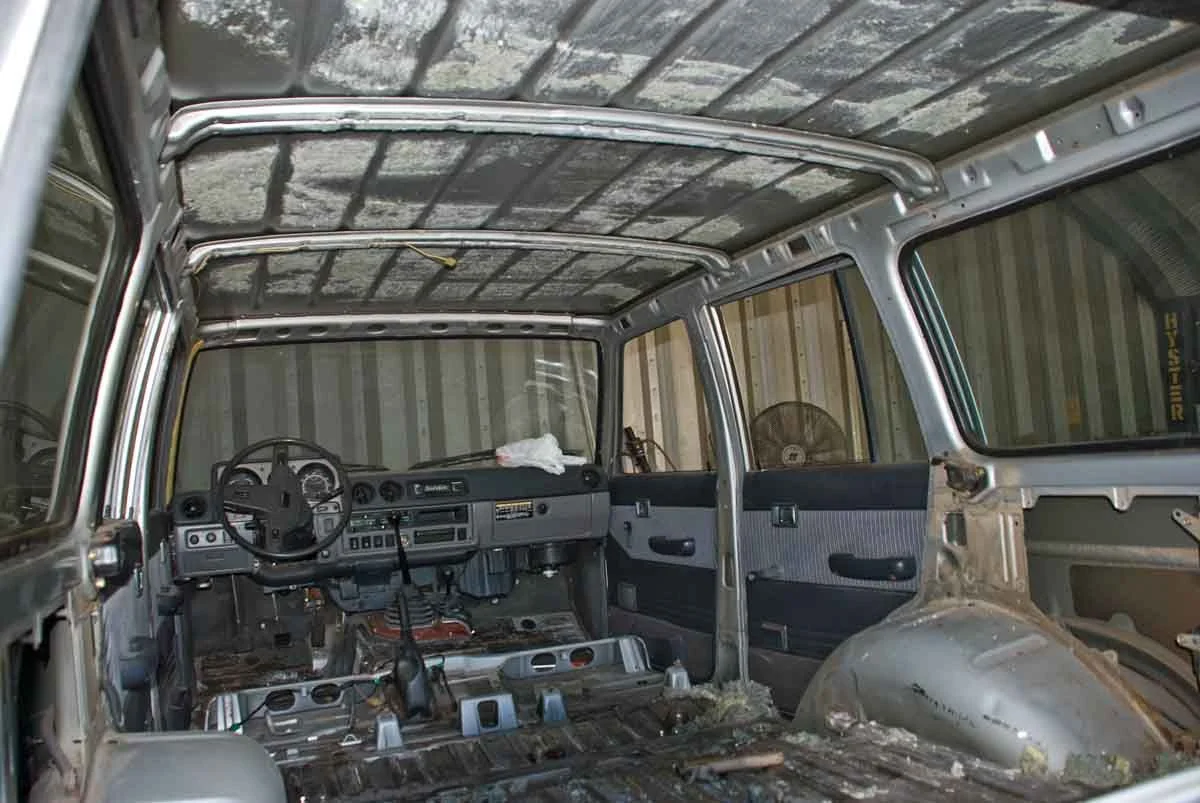

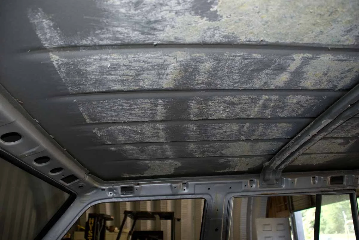

Over the last two weeks I got to work a little on the BT. Mostly removal of the headliner and the associated hardware. Then scraping off the insulation and finally sanding off the glue and most of the old paint. Not many photos too boring.

That crappy glue clogs up wire brush, grinder wheels only thing worked was a sander and grinder grade disc.

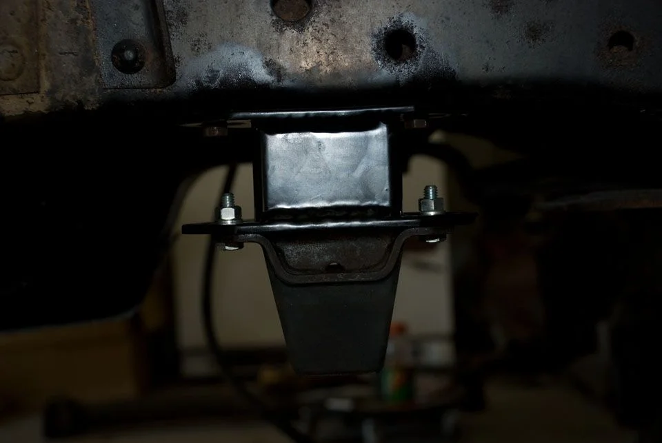

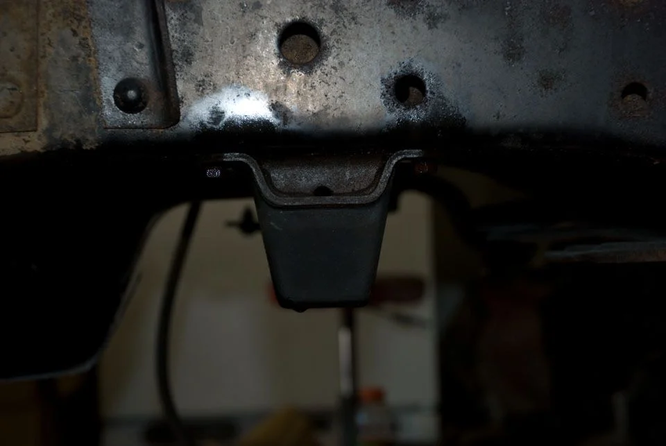

When my arms got exhausted from the overhead work took a break and installed the 4+ bumpstops (2 inch) a half bannana job.
Stock
Mod complete.
