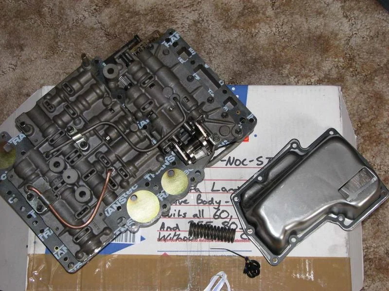

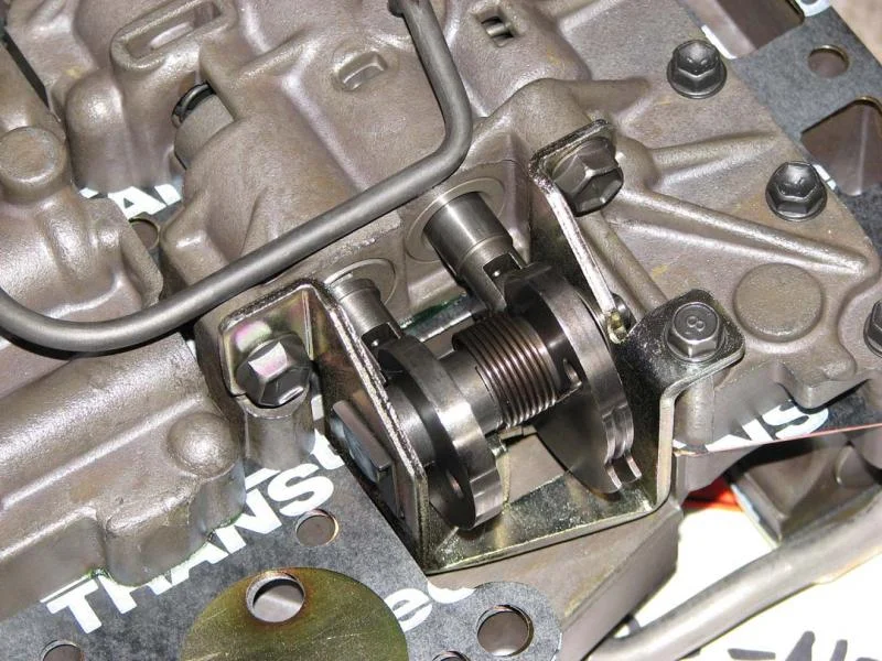

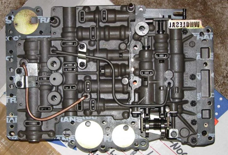

After sitting in a box on my living room floor for around 6 weeks, my extreme valve body is finally in my truck and working. For those who aren't familiar, Wholesale Automatics is an outfit in Australia that does rebuilds and upgrades of Land Cruiser automatic transmissions (A440F, A442F, A343F) as well as other brands. Their extreme line goes beyond a simple rebuild, with components being recalibrated and machined to tighter than factory tolerances (yadda yadda, best thing ever, yadda yadda). The extreme valve body is touted to give you greater clamping pressure for the clutch packs and torque convertor lock up, quicker shifts, and greater flow to the cooler. But the big advantage of these units is that they give you torque convertor lock-up in 3rd gear (when above the same road speed as for OD lock-up) so that you can take steep hills and tow on the highway with more umph and less heat generation (from the torque convertor).
So, I have an A440F in good shape, about 170 000 miles on it, and decided to swap in the new valve body after hearing good things from others here on mud who have done it. Wholesales products are now distributed in North America by Pacesetter Products out of the Yukon (same guys as Outback Imports, one of the big JDM importers in Canada). They list the valve body at $1250 Cdn, an enquiry direct to Rodney at Wholesale sent me back to Pacesetter...... I'm sure you all want to know what I paid, all I'll say is that Jesse at Pacesetter and I agreed to a price, and it was considerably less than the list price.
Here are a couple pics of the valve body straight out of the box. It came with a new strainer/filter & gasket, a new pan gasket, 4 new o-ring seals (that go between the valve body and transmission case) and a recalibrated spring for one of the accumulators:

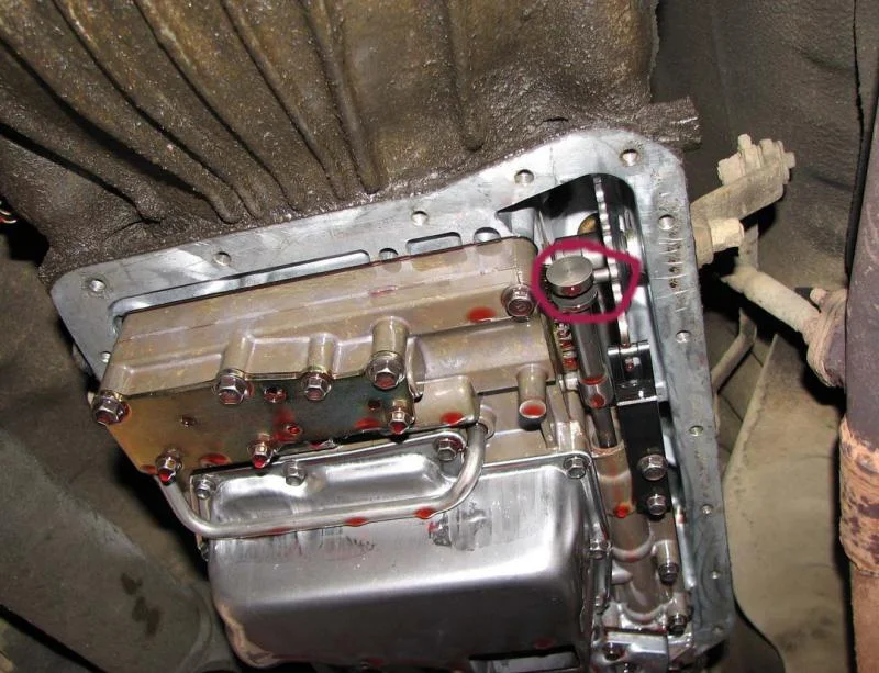

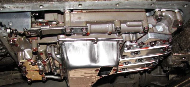

Got around to installing it last night, what a mess!!! You'll need a 24mm socket (for the drain plug), a 12mm socket (for removing the skid plate), 10mm and 8mm sockets, an inch-pound torque wrench, about 8 litres (~2 gallons) of ATF to replace what drains out, a large catch pan for all the continuous dripping, and lots of paper towel.
Removing the old valve body goes smoothly, but dirty. Wholesale provides some instruction sheets (really just copied pages from an FSM for a different version of the A440F with relevant stuff highlighted and other stuff stroked-out), so it is easy to see what bolts must be removed to loosen the valve body from the transmission case. The only thing to watch out for here is to make sure you get the kickdown cable disconnected from the cam before you drop the valve body. I loosened the kickdown cable at the throttle body to give more play to work with. Also, removing the dip-stick before separating the pan is a good idea.
Installing the new unit is where it gets tricky. Having an extra set of hands for 5 or 10 minutes would help a lot. First you need to put in the new o-rings. I suspect soaking them in ATF for a day or two would help them swell and hold in place better, but I seemed to have managed without. Then you need to swap the accumulator spring, just pry out the appropriate accumulator piston, and switch it in. Lifting the new valve body in is where it gets tricky. You need to lift it in place, hook up the kickdown cable, get the accumulator piston(s) in position above the valve body, get the "manual valve" aligned with the pin in the manual valve lever and get a couple bolts in place to hold it all up in "one" step. I found it easiest to angle the valve body up to get the kickdown cable in place, then swing it up and get it bolted up. Unfortunately, I didn't get the manual valve and lever lined up on my first install attempt (no mention of this in the "instruction" sheets, but illustrated clearly in the FJ62 FSM) so I had to go back into the transmission after sealing it all up
Once you get the valve body held in place with a couple bolts, use the FSM or instruction sheets as a guide to get the correct length bolts into the correct places, and torque them all in. Slide the strainer and gasket in place, bolt and torque it up. Slide the pan and gasket into place, lining up the two portions of the dip-stick tube, then install the bolts and torque. The 3 bolts along the back of the pan are a pain, as the transmission cross-member is in the way and make lining them up tricky.
Replace the ATF you lost (about 8 litres/quarts for me), and test it out. At this point I found that the gear selector wouldn't go back into "1", and the transmission wouldn't do anything, all a result of the misaligned manual valve (circled in the photo below). Fixing this was time consuming and messy, but straight forward.

Going for a drive, the difference was immediately apparent. At first the shifts were harsh, and the gears "hung" long before upshifts (especially when moving the selector up the gears, rather than letting the tranny do it all in "D"), but this went away fairly quickly, and I'd chalk it up to air in the system. After everything settled in, the tranny seems to give a more spirited feel. I think this is an equal mix of placebo effect, crisper/quicker upshifts and higher shift points. I did my best to keep the kickdown cable adjusted the same, but the difference in shift point is akin to the first time I adjusted that. Cable adjustment won't give you the crisper/quicker shifts though. The more spirited behavior is most notable at moderate throttle, and less so at WOT (when the transmission was already doing its best in terms of shift points I suppose), so it seems to be a re-profiling of the shift behavior with the limits staying much the same. It does seem to give you better response when step into it after light throttle cruising though.
Taking it out on the highway, I was initially shocked to find no lock-up in 3rd, but this must have just been some air in the system, because a minute later the lock up was apparent. Lock up is much more subtle in 3rd than in OD, but dropping from OD to third when lock up is engaged is much more solid (read a kick in the pants/holy crap is it supposed to do that?) than from OD to a non-locked 3rd with the old valvebody.
I did a couple of speed tests before the install to compare performance, then did the same spots again. 0-100km/h (63m/h) in "3" on a slight incline took 27.7 sec with the old set up, 28.7 sec with the new. 80-110km/h in "3" up a slight incline took 16.6 sec before, 15.4 sec after. I'll test these again after things get worn in a bit more, to see if the first value drops back down after the fluid level is stabilized and air is all worked out. Clearly though, there is a slight improvement over the range that the TC is locked up. So far there is no clear difference in operating temperature.
Well, that's all I have to report now. I'll add in more after a get more seat time with it. Can't wait to see how it does on a good highway hill, but may be a few weeks before I get to find out. I'm going to be more relaxed throwing it into 3rd at highway speeds now, as I should be able to get another 10 or 15 km/h without pushing the engine speed any farther. So far I am pleased (aside from F-ing up the install), time will tell if I am pleased to the tune of the purchase price. If I end up towing at some point, I think I will be.

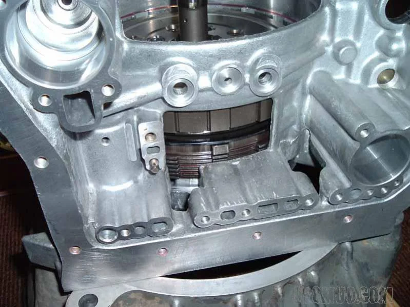

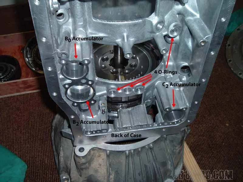

It really isn't a complicated swap, just messy and a bit awkward at times. I'm afraid I don't have any real different pics, it turned into such a mess with ATF everywhere (including my face) that I didn't want to bring out the camera till it was all in place an I was cleaned up.
Have you seen Cruiser Jimmy's rebuild thread? http://forum.ih8mud.com/80-series-te...nic-style.html
Here is a photo from his thread I have doctored to show the 4 spots the o-rings go (the old ones held in place for me) and the accumulators. The B0 Accumulator is the one you swap out the spring for, I just pried it out, changed the spring and pushed it back in. The C2 Accumulator popped out on its own for me, so I had to hold it in place as I got the valve body up under it. The o-rings go in with the smooth side to the valve body and the pitted side to the transmission case.
