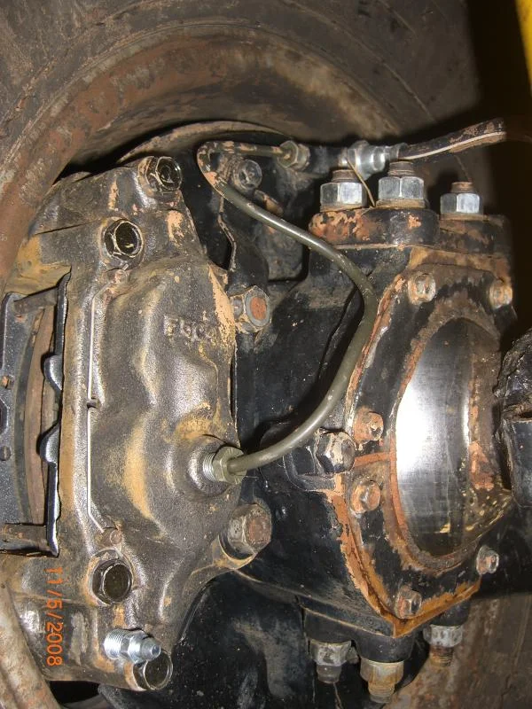

bleeder position pic
taken a few mins ago. cold and riany outside still trying to figure it out. thanks
here is a pic.

bleeder is on the bottom of the caliper,of course you can't bleed it this way it has to be on the top of the caliper in order to release air trap in the system.john

x2 on bleeders being on top....

ok ok ok I am going to kick myself now. I thought they had to be on the bottom. I will change in the morning. thanks guys
I feel like a *ss

Don't feel to bad I did the same exact thing a couple of years ago just swap the calipers, bleed your brakes and you should be fine .
