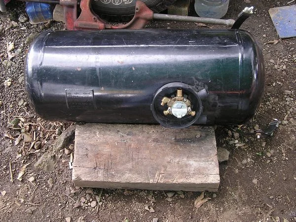

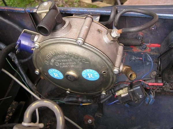

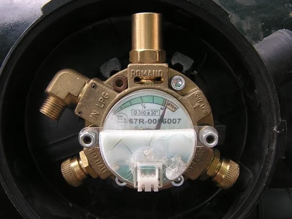

Have a seller here in Costa Rica who has a complete system out of a Cherokee.
4.3 motor. Near brand new and a full tank of gas.
From what I gather the the duel curve ingition will prob. not work? Maybe it will???
Mace said he hadn't seen many they really worked on our motors except a closed loop he has.
What could any of you recommend for timing my motor for the duel fuel?
Car a timing light and set it everytime I want to change over????
I want to go duel fuel.
May not use it all that often but for piece of mind I would like to have it.
I can get LPG at any corner store but the fill time might be a pain in the arse.
The only time I jerry canned before was when I was flat out of LPG.
Top up looks to be more time consuming according to the link Mace posted for the transfer hose.
By the way Mace thanks for that link.
The hose is easy anuff to have made up here.
Welding supply stores also carry this fittings for the tank connections.
Propane is OK for the torch.
The other ? I have is the conflicting answers on the fuel pump issue.
valve between the carb and pump sound possible or just electric pump it???
Would rather the mech. pump as It has never let me down yet and have a spair on hand always.
I am going to buy this setup if anything for the for the tank. Tank is full and worth every cent he is asking.
I just need some help planning the install and what additional parts I should factor in.
ie electric pump or valve/ timing light or duel curve ingition or a cable to the dist.???
The extra parts might be tradable with the LPG shops here for the pieces I need.
I have the mixer for the carb. Same as Peru has on his.
Was hoping to do this install this week but things happen at a slower pace here some days.
I will be going full tilt next week and will post the install with photos.
Any help much appreciated.

Not high jacking but this seems to have become and propane Ed. thread here on its own.
Well I got the tank and all parts I need to go ahead here and install.
The tank is about 13'' dia and 3' long.
Tight, but will fit and be large anuff that I can put on lots of milage before fill ups.
Way more than I have under the passanger seat. 45 liters + or -
I am guessing 70 liter tank. 150 lbs full right now.
I have looked at lots of photos on this site of guys hanging them under the tub between the rails
I can do this also, but don't like the look or the thought of having it banging around.
Also 150 lbs hangin there will combine when on ruff roads.
Have thought about replacing the floor of the tub and putting a half moon in it to sit the tank in.
My floor is good but will do what is needed to make this a comforatble safe and durable fit.
I want to keep my seat in the back and not mess with this too much, this is were the half moon thing comes in.
5-7'' depression in the floor to lay the tankin and then strap it down
Not sure about having this in the same cab.
Seen it done but wondering about safety issues.
Should post a photo & will of the tank.
The main valve the with level gauge looks like there is a releif valve on it.
Next ? is I have a sheet of 1/16 308 stainlesss left over from a job I did awhile back.
Any input on using this.
I can welded mild and 308t ogether no problem.
I have never done this or seen it done on floor boards.
I don't normally (rarely) mix and match mild and stainless.
But have a good sheet with no plans on it and thinking it might be the way to go????
It is harder and might stand up better to the saltly air here on the coast.
I am hoping if I seal it well I will not have to worry about oxidizing transfering to the 308 Stainless.
Any input????
Tank in the house and mild stainless combo flooring.
Thanks for the help
Will be posting photos this week as I install.
I looks to be an easy install exept my tank delema.
Well I am off to the corner cantena

the tank in the truck is prolly not the best idea... but however so long as there are no leaks...
i mean mine may end up in the rear section someplace... again i dunno how smart that is but yea.

tank in the truck is fine..
But be aware, it needs a liquid feed to run right, your typical house tank only feeds vapor..
And mild steel will weld just fine to stainless..
__________________

Here are a few shots of the tank valve and install.
Mace could you tell if this has a relief valve on the top.
If so I don't really like the idea of having this in the same cab as me.
I smoke.
Would have to remove it and put a relief inline on the exterior.
Mounted the main part here on the wheel well.
Read somewhere that it is best to keep the hose to the mixer as short as possible.
Will buy the donut for the carb. on Monday.
Not much $ and if t doesn't preform I will have a Impco sent down.
This kit came with copper hardlines to the fill valve and converter.
I have some nice shielding I might use to put over it then run it along the frame up to the converter.
Anything wrong with using this copper line???
If so speak your mind please.
I can have Goodyear lpg hoses made up but will be expensive.
It is heavy wall and was installed on the last rig.

I have some 308 that works well and a spot welder that should do the seams along the wheel wells.
Just have to clean and buff up the old mild for good pen.
Thanks for the input on it.
Will post shots later in the week once it is done.
Hope chop it up Tuesday and done by Wed.
Plan on re-enforcing under the tank with a frame to carry some of the wieght so I don't cave or stress everything else out.
Will snap a photo of this also.
Note the relief valve I think is an adjustment for the level gauge.
Has an alan bolt in it so it's not a relief.
I have a 450 lb lpg valve that I will install outside the cab.
Maybe on the filler line???
Any suggestions on this???
All I know is there should be one on the system just not sure where.
hammered is offline   Reply With Quote
