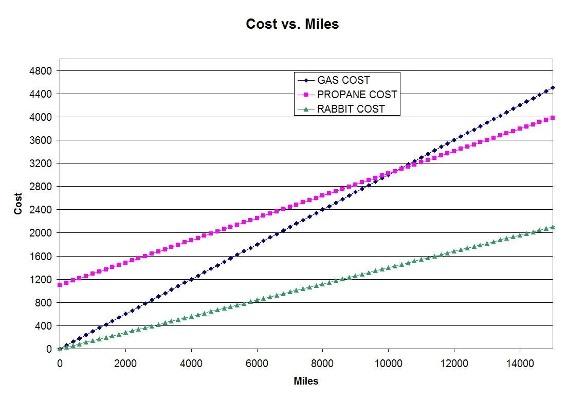

This looks like fun. I was doing some calculations last night and according to my spreadsheet the break even would be somewhere between 7500 and 12000 miles of driving, depending on how much you spend on the propane tank and how much propane costs.
Gas-A-Lot is going to spend total of $1600, but at $2.19/LPGgal, his break even is still around 12000 miles.
inputs:
MPG-Gas = 14
MPG-LPG = 13
Gas/gal $ = 4.2
LPG/gal $ = 2.5
Kit Cost $ = 1100
Also, if I did this, I would have little financial motivation to dive my VW Rabbit(30mpg) to work anymore. Does anyone know if I could use my Weber base instead of the Holley?
Here's the results: the price if the kit is the initial offset to the pink line, the slope changes with LPG$/gallon

So for the dual setup case....if you tune the engine for propane use (advanced timing etc.) would it really run ok with 92 gas + octane boost? KITB, have you tried to do this with your truck?

Wenejor.... It makes sense to me cause my 60 is my DD... I have a runner now that is not working.... I looking at my investment paying for itself in under a year.... And that is with conservative driving... I have a Market/grocery store 1/2 block away, Church is 3 min. drive and well I mostly do work driving and don't go out much due to the cost.... now I might go out more ... wont do it on my 4banger cuzz I get bout 17mpg... If I pull the rear top off I could get a little more due to the reduction in weight.... If you get great mileage.... well you don't spend much on petrol to begin with..... If you got a massive commute, then yes You will benefit.... but in that case I would drive a diesel with propane injection.... cuzz your pane tank options are limited...

Yeah for me the rabbit is getting just over 30mpg and that's what I drive all of the time. I've had the 60 now for like 5 months and so far put on like 3500 miles. I did two 800+ mile trips in it over the holiday weekends and we are likely going to do some more trips this year. I think it would be cool to have 60 that drives like a VW Rabbit from the wallet perspective.
Personally, I would consider doing the dual fuel setup with propane as the main fuel source. I am interested in the results of your project.
