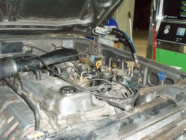

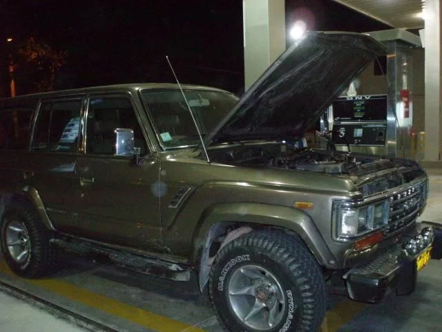

Down in Colombia South America it is very common to run on propane. I had posted these pictures a long time ago, but they seemed to just get pushed to the bottom of the thread list. I'll post them again. I talked to a guy I met and he said it cost around $1500 u.s. to have it converted. However, that is in Colombia, and it was parts and labor. Doubtful you can get it for that price in the states.

you could prolly get it for that much not including the tank.....
I take it that the 62 had a heart transplant.... looks doable..
