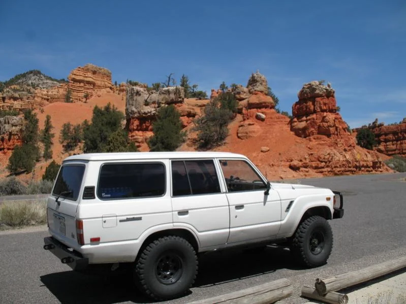

I am running OME springs medium duty in front with some long AAL's and rear medium/heavy springs in the rear ( I am thinking about adding leaf after the trip to make them heavies so the rear can handle the load better). I got the springs about 8 years ago. I am running a 1" body lift too with 3.75 BS wheels. I went with the smallest 35's I could find (dunlop mud rovers) which show a 34.2" on Dunlop's website. I didn't get any rubbing at Moab but would be nice to check on a ramp. I would stay away from the shackle reversal. Here is the cruiser on the trip out with it loaded down.
