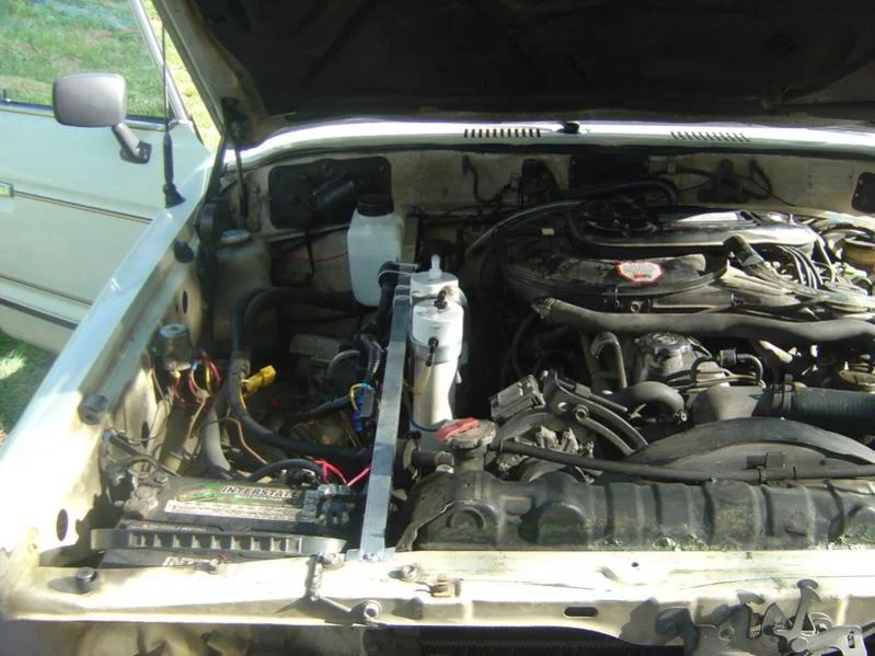

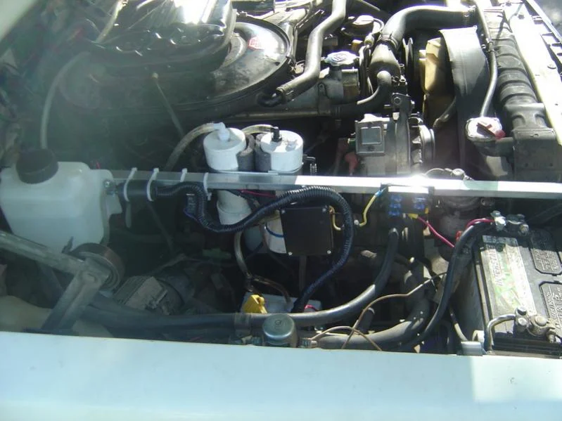

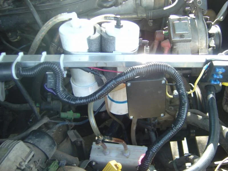

here's the pics of mine in the fj60
This is the previous 11a single brick unit. The system has been changed slightly for more effecient production. It draws up to 8 amps and produces 2-4 liters per minute of hho. I have it on 15a fuses.
The brick cell is mounted below on the inside of fenderwall for cooling. the two pvc condensate traps are now eliminated on the latest model and the resovoir replaces them both for removing any condensation. The booster pump now runs from the brick to the c-trap/resovoir which circulates the flow more efficiently.
