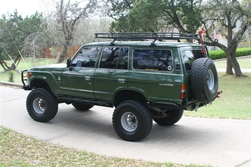

The issue is there is a threshold where SOA is about 6" of lift and makes your rig "big." It is hard to build a 60 series small SOA. For this reason I advise SUA more often than on, 4-5" of good healthy springs and you will clear 35's fine. I like SOA but you have to keep in mind the size of it. This pic is about the smallest you can safely get a SOA on a 60 series. If you are happy with a "big" truck then you will be fine. You can build truck small with 35's...
