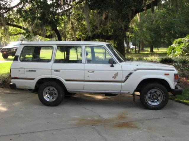

well thanks for the replies guys very helpful. well i got the 60 today so now the fun begins!
