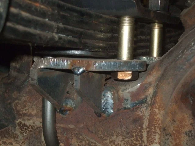

so tonight I'm bummed.
Set the pinion angle, welded the drivers perch in and found out the perch is a good half inch taller. Right know i really want to cut it out and get Dan to send me the right perch . Thats about four hours of cutting and grinding and resetting everything that I don't want to waste. my other thought is to just cut some .5" plate and weld it to the drivers side plate.
Only good thing is I got my Marlin Crawler shock hoop in on the drivers side . Had so straddle the steering box. With a 14" shock I have about 3.5"s of rod showing. no pics

Old 03-12-08, 12:51 AM   #97

That sucks.
Tack welding is you friend.
Quote:

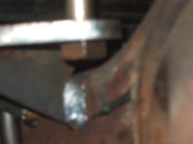

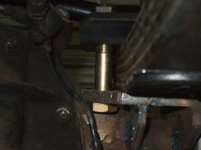

Alright, got the back supports fitted and welded on the driver shock hoop and threw on some paint.
Looks like we have the same problem as Tim. The front hole on the Ruff Stuff passenger side spring perch is too close to the housing. Can't get a bolt through, a nut tight to the bottom, or even a socket head cap screw to fit in.
My first thought is to use the plas to elongate the hole to where a bolt can come down from the top and then weld a tall nut on the bottom side. Should work.

Quote:
I'm calling Dan again right now. This needs to be fixed. I realize this kit is like 80% and some cutting and gringing is expected but I don't consider this problem safe at all.
I ended up just burning it in, didn't want to wait. ended up fine. no problem using a large 5/8" u-bolt nut(tall nut). I did end up having to cut a lot out of the little plate to get the angle.

My Ruff Stuff perches look a little different than yours. I was able to use the bolts that came with it and have room to install them.
Only you and Fred40 will understand these pictures.
__________________
Cruiser Dan at American Toyota Phone is 1-800-432-6668 ext. 8 (I am not cruiser Dan)
My Tow Rig = http://forum.ih8mud.com/hardcore-cor...g-tow-rig.html
D'Animal is offline   Reply With Quote

A few more. Look at the brake tab on the housing for reference between mine and yours.

One shot from below.
