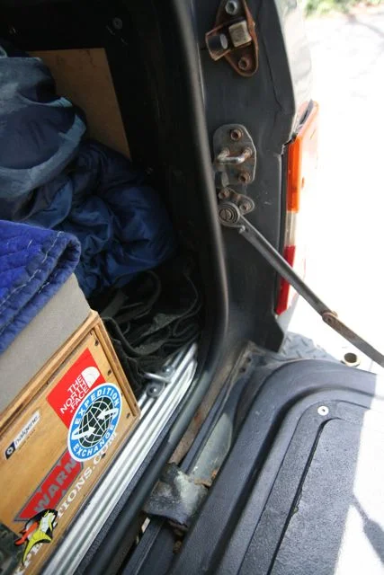

Fiddled with the tailgate weather-strip today.
(still have a box of the 4 doors if anyone needs it)
The seal looks like it will work out quite nicely, take a look at how smashed the old stuff is.

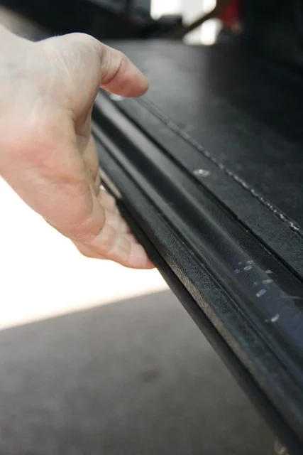

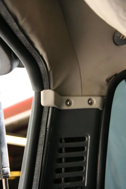

I am not real keen on how the welting worked on the headliner lip, not sure if it is really going to help the seal at all, think it may be better to just go with a piece of straight edge trim. It is very nice to have it cleaned up though, the old edge trim was pretty ratty.
I wanted to use the same material so as not to need to order another roll but the fit is not as good as I hopped. Even though the metal lip is the same size, the headliner wraps over it and makes for too tight a fit, you can see in the one pic how the edge gets all wavy. I also had to trim the welt back since it wont fit under the plastic trim, the edge trim continues under the plastic end cap, but the cut welt makes it look sloppy.

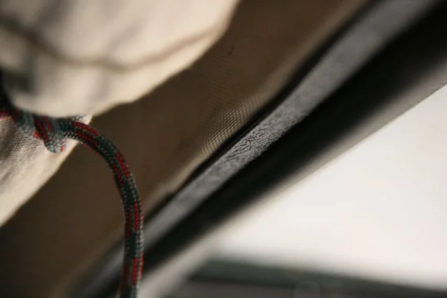

In the top pic here you can see where the water has been seeping around the old weather-strip, I cleaned the dirt off so I will be able to see if any water gets past the new seal, that will help me determine if the second welt is needed as well.
With the tailgate shut the new welt is nice and compressed.

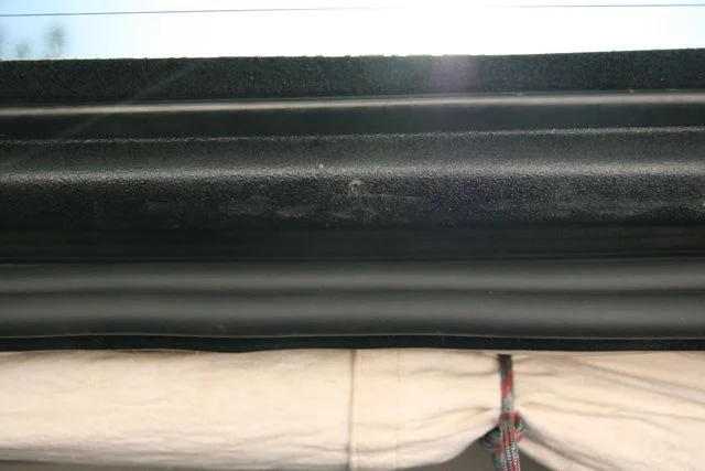

The best part of the whole thing is still the edge trim on the tailgate lip. It protects the edge, makes the lift gate seal solid, and it works like a nice padded grip, I grin every time I close the tailgate now.
