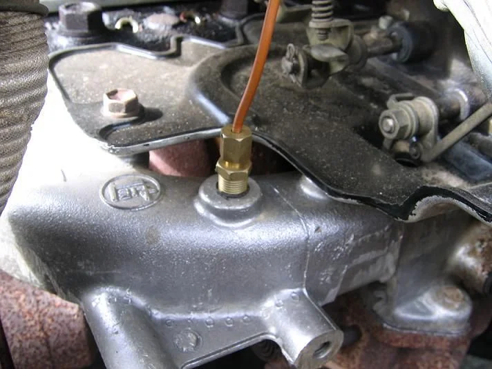

What is the recommended brand/type/model of vacuum gage for permanent installation on FJ60, and what is best connection location and mounting location?

I've been told the best connection is the passenger side of the brake booster - that's where I got the best reading when I was redoing my vacuum tubing. As for mounting the guage, I guess the sky's the limit - there was a group buy on A-pillar pods a while back, that would probably work pretty well.

I use Autometer gauges, plumbed the vacuum line into an unused port on the top of the intake manifold.

Quote:
x2 on the intake mani

x3 on intake manifold . Mine also there as in pic

NEVER on the booster only on the intake.
lol you will find mine in the center console .

x4 intake... left of glove box door indash 30>0 backward sweep out of a bus ...... cool twist

What size is the hole in the intake fitting?

I think it's real close to 1/8"NPT...
