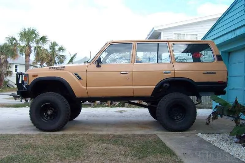

Alright....I guess I'll start in the beginning because well it seems like a good place to start.
I grew up always wanting an off road vehicle and orginaly I was after a old series rover from Point Break ( Sheeaaaa!!!! ). but after some research and finding out that the drive train is on the week side of the line. I found the Land Cruiser, Actually it might have been a subconscious thing. A white fj60 is the first vehicle my dad and I ever stopped to look at for me to drive when some day when I was old enough to drive. And then later on I remember stopping and looking at a mustard fj40 with him.
It was final, I wanted a Land Cruiser. So, I spent the next 2 years saving. While I was in my freshman year at Penn State I saw a brown fj60 zipping around campus with a for sale sign in it. The guy originally wanted 3,500 but I offered him 1,700 and 2 months later he called me up and ask if I stilled wanted. I bought it that day.
I spent the next year driving around 250 miles a week through the mountains from my apartment at campus to my home on the other side of the mountains. It was for the most part my favorite time of the week plowing thru deep snow late at night with no one else on the road.
After that year was up I ended up moving to Florida where I started to plan for a SOA. I got the rock crawling bug after FSUsteve gave me a copy of Toyota Trails. After reading the trail stories from Tellico I knew thats what I wanted to do, and the trails were just with in my reach.
Mean while I was still driving around 300 miles a week to school in a SOA Fj60. Doing a bunch of PM and upgrades...
SOOOO how did Velveeta Wag get its name??? I went to have my rig painted tan and the shop screwed it up and painted it neon yellow. Well I raised hell and had them repaint it for free....Tan.... Well sorta of. Close enough any way......Welll back to the name. I posted up a thread in chat when I use to hang out there about being in love with Velveeta cheese. Patride was nice enough to notice that my truck was the same color as the cheese and dubed my rig Velveeta Wag.
Alright back to the tech...
As my rig sits now.
1982 SOA with fj62 srpings
New Fj62 frame
Frame and body chopped 22"
Roof chopped and caged
37"MTRS
4 wheel disc, 4 runner calipers, brembos, rear GM discs and calipers
.250 track bar
Aussie locked front and rear
4.56
front and rear axles rebuilt
Marlin crawler hysteer, .250 drag-tie with fj80 tres,
hydro assist with 80 series PS box
Par-desmogged stock 2f/ H41/Splitcase
Tubing front and rear, Sliders, high clearence bumper, M8000 in cab controls
CB, hand throttle
10,000 other little doodads and upgrades...
Whats sitting in the shed/ what will be in the rig in the next 2 months.
Narrowed 14 bolt, spool and 4.11 gears, discs
Toybox and rebuilt h41
Narrowed D60 with 35 chromos, new brakes, 4.11s, spool,
8" ram , hysteer , 1 ton steering
.250 drive shafts
39.5 Iroks on 17" wheels
The above plans will be done before Tellico this May with any luck. I am also enclosing the cab right behind the front seat to make it more comfortable. Down the line I will prob completely lose the rear for tube and a 1/4 elliptical..
Here is a bunch of shots my from the past and I will throw some more up later of what the rig looks like now.
Peace, Love and Chicken Grease...
-Al

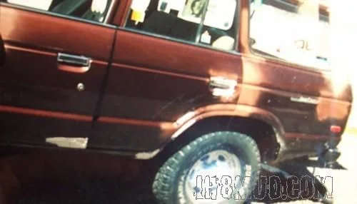

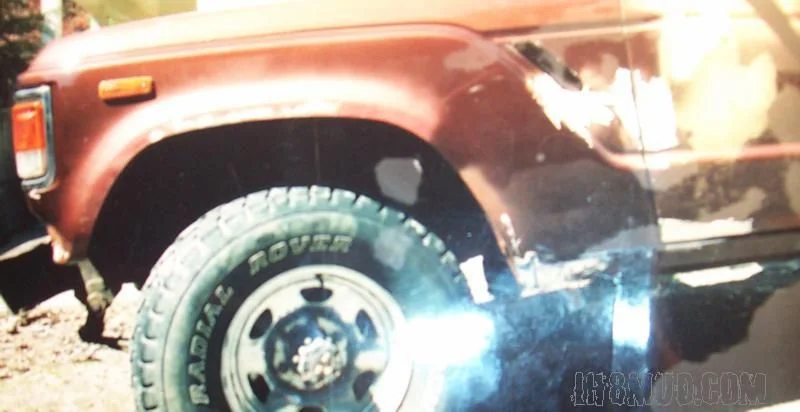

Here are some super old super bad pictures of Velveeta back when it was brown...And a good shot after I two toned it. In the two tone picture I just got done making 1/8 plate rear quarter panels.

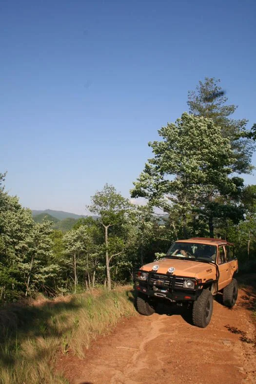

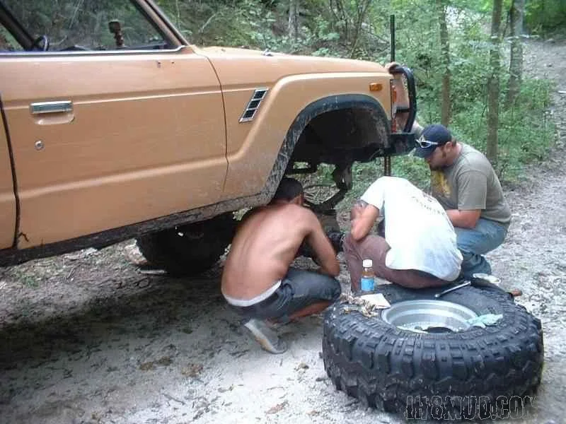

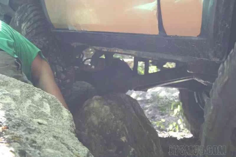

Couple of shots

Few more

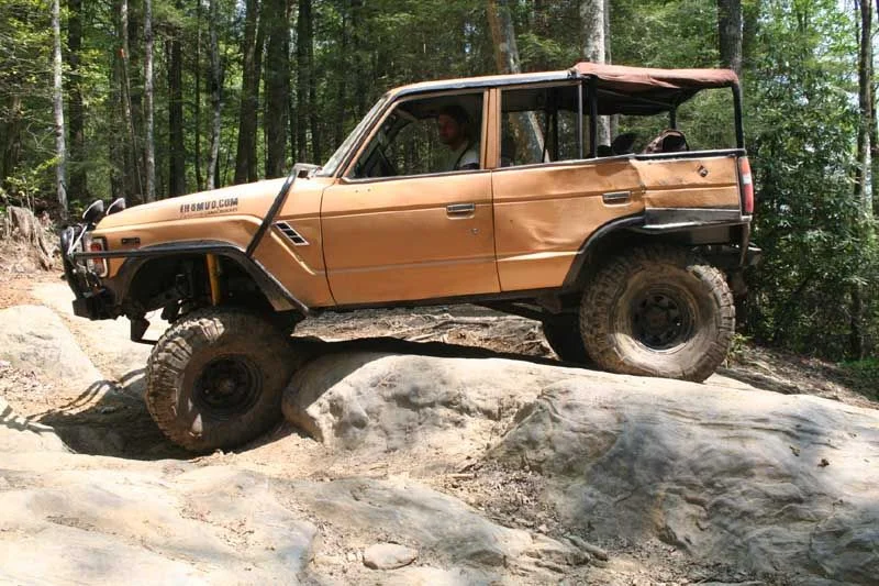

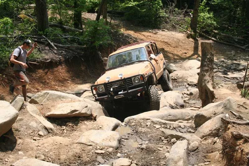

Few more for tonight...

Wow, I wonder what the PO would think of it now. I always wondered where velveeta came from, other then the color I didnt know why you would call it that.

Last ones for tonight....

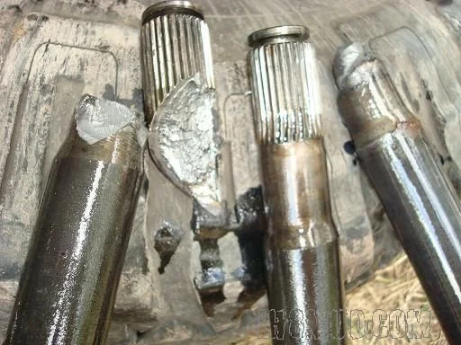

I did want to keep it all toyota. But After watching a buddy blow a chromo rear in a much lighter rig I knew they would never hold up under my heavy rig and driving style. I really wish I wasnt going to different axles but hey bobby long sells birfs for D60's.....and there friggin huge. So Ill be back to birfs some day

the D60 bobby birfs are in a word amazing..
Chromo's and longs U joints would be cheaper and stupid strong tho..

Haha, I have nothing to prove or hide and I can truthfully say that trail put a hurting on me that day. I went right to camp had half a beer and passed out.
I was ungeared with only one locker (rear)...I was in way over my head. Plus following franky is less than easy.
I remember coming back the following year fully locked and geared. It was a much relaxing ride up lower 2...more or less.
Its almost a highway now, kinda a shame... Flashed it in 20 some minutes.
