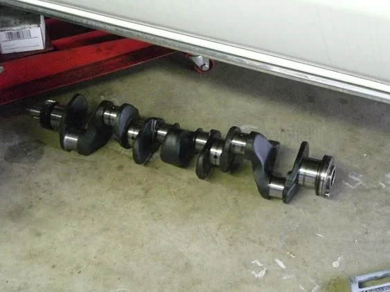

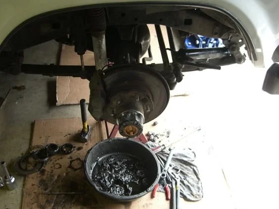

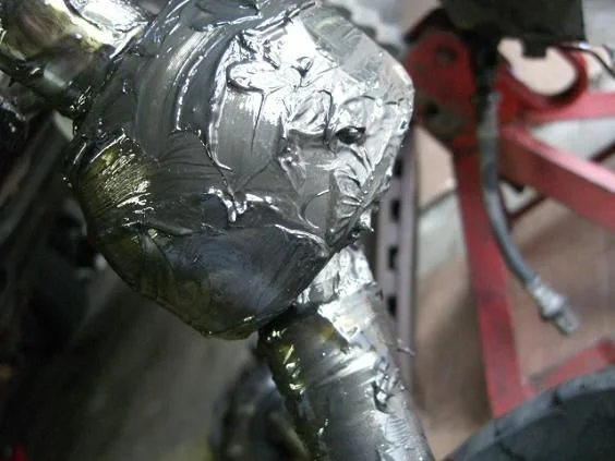

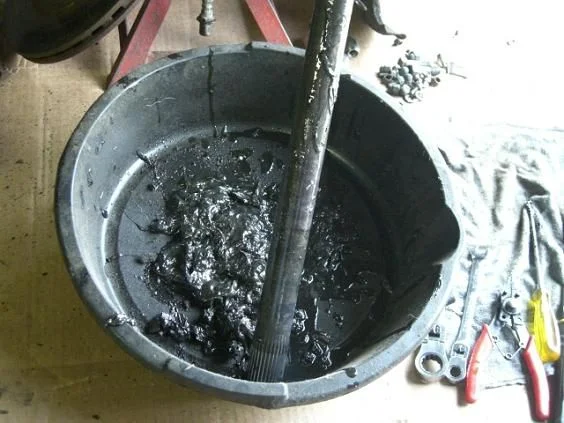

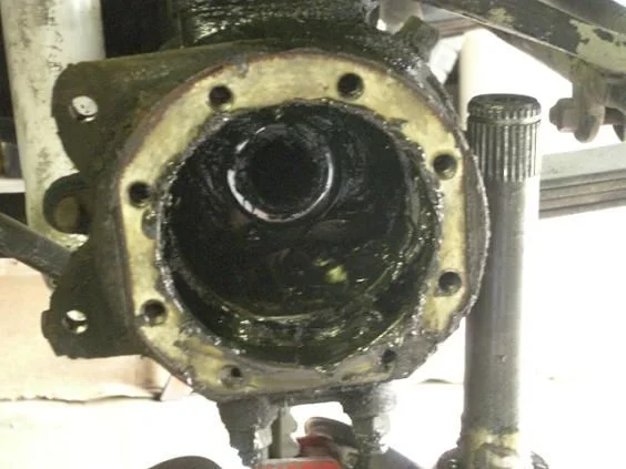

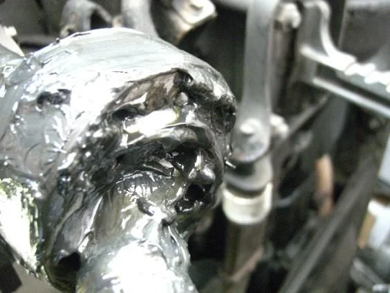

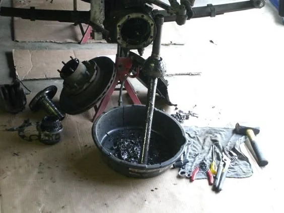

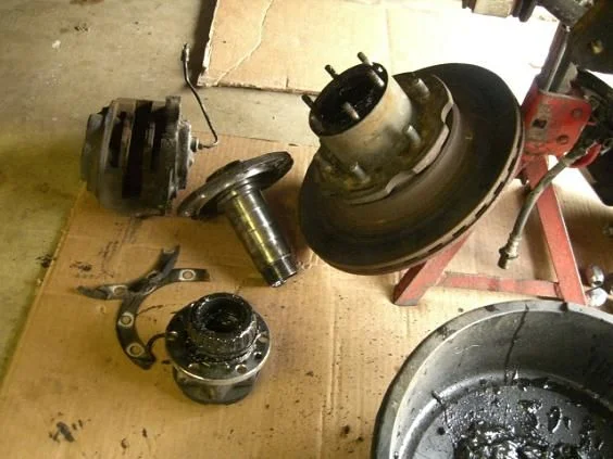

ok a quick update on the Great White Hope
as a few of you may know the crank had to be pulled on the truck as it still refused to coroperate and was still leaking some oil out of the front main when running also the rear main is also leaking some. Randy gave me a call and asked if i could lend a hand Of course always ready to help a fellow cruiser fanatic and in this case close friend and previous co-worker i am def not gonna say no. He explained to me what was goin on and how he has been slammed at his new job and other things he could use a hand catching up. I said sure, so I drove over and picked up the cruiser and towed her to my house and rested her in my garage. I will be droping the transmission and pulling the crank and swaping in the "new" one while there replaceing both main seals. I was also asked to do a knuckle rebuild... I again said of course (i hate knucle rebuilds). and am currently taking a brake from that to type on here and snap a couple pictures.
knuckles were not even half as bad as my truck was so its not TOO big a mess tho it has made one.
The picture so far are of the passenger side I checked the birf for any abnormal wear I.E. cracks in bell or inside bell, checked for any play and found nothing so it is rockin and ready to go in once i clean things up a little.
picture time. most i think are self explanitory.

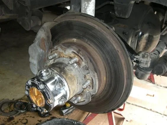

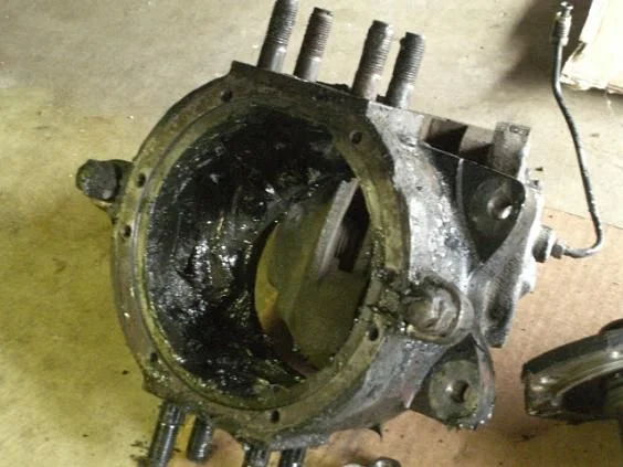

nother of the birf, a shot of the spindle hub and rotor, and a shot of the crank to be.

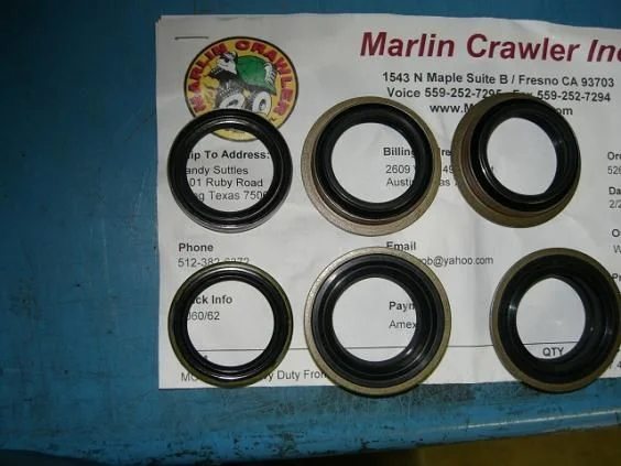

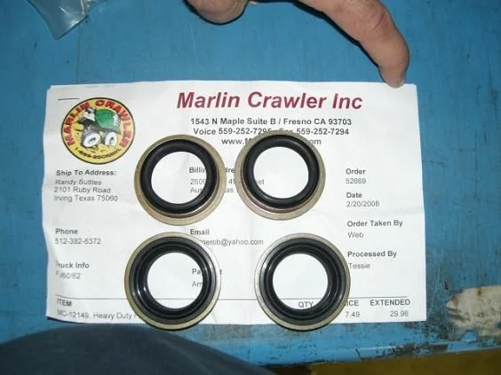

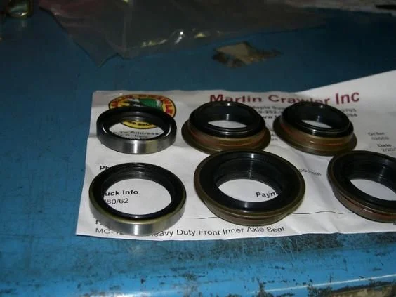

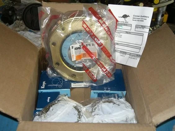

my pile O' junk, shot of marlin HD inner axle seals (GREAT CHOICE!! I love mine in my truck gets wheeled hard and still leak free!), then a shot of the marlin seals compared to the stock seals. (major diference)

nther comparison shot of marlin seals to stock inner axle seals, Picture of cruiser outfitters complete knuckle rebuild kit and KOYO bearings. (very nice kit), then a picture of the invoice of one of our supporting vendors. (my finger is to block out the customers personal information.)
all in all this truck has obviously been maintained the knuckles were leaking but not too bad the birf was kinda washed out of grease and had more gear lube in it then grease, inside the knuckle was nice and full of grease and was obvious it had been filled up from the top plug as to keep it maintained.

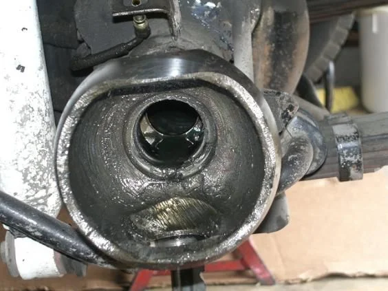

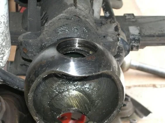

races out inner axle seal out ready to go back together. and knuckle wiped down.

Cool. Gooey. Degrease that sucker.......Welcome to axle tear-down land. Just don't forget to put the hub seal in after you are all done with the inner job and disc brakes are back on, etc. I redid mine recently from the axle housing on out with swapped in 62 parts. I had the hub seals leftover. What a shock that was. NOT.

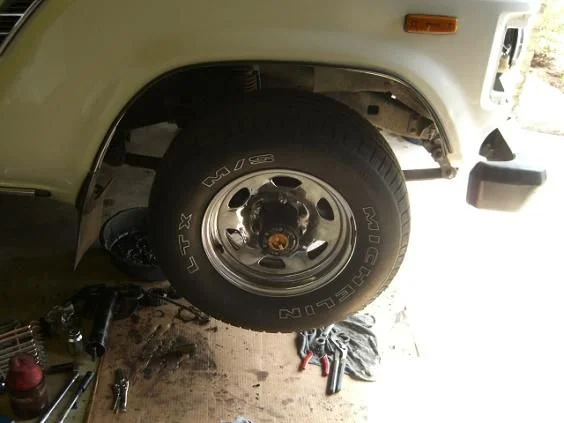

ok got it all finished up and cleaned up on the passenger side. not gonna do the driver side today as ima go look at a 83 yota mini truck ill do the driverside tomorrow after work no big deal went back together all nice and painless.
here are the last ones fer now yall enjoy.

got the crank from the machine shop as well as all the new bearings and oil pump ect.
im hoping to have the trans out of teh way and the front of the engine tore apart and the crank out by tomorrow. if not have the new one on its way in. but we shall see how things go. hopefully i will not hit any snags.
thats all for now. ill try and get some shots of the crank coming out as well if i remember.
