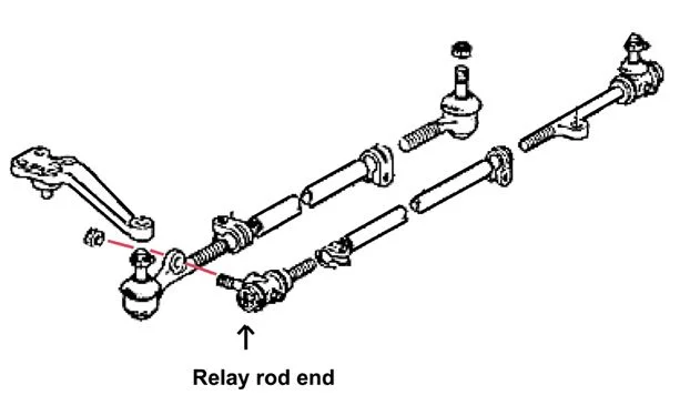

O so I got everything removed and installed my TRE but I can't get the drag link end to get in enough to get any threads on the other side..I'm think maybe has to be pressed back on? Any suggestion on how to put this back on? Also, is there anything I need on the TRE (washers, etc) besides the castle nut? I broke my old TRE on the trail so don't know what was all on it! Though I just realized I can look at the other side! Oh well too lazy to delete that last line!

Originally Posted by zgcruiser
"O so I got everything removed and installed my TRE but I can't get the drag link end to get in enough to get any threads on the other side..I'm think maybe has to be pressed back on?
If it looks like the one in the illustration below - It is a tight fit, but you should be able to push it on enough (with your hands) to get the nut started.
Torque them to specs, and don't forget to put on the cotter pin.
