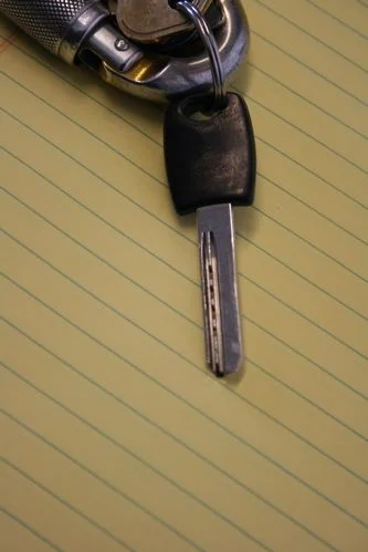

I've got one on my 60. The company that sells them here is "Mul-T-Lok" and they are a premium-priced outfit. It would cost me about $175 to get another one installed on my 80. They won't sell it without installation.
I'd just as soon save $100+ and buy it through the guy in the USA.
The one advantage to buying it here is that the key setup they use here is bulletproof... but then, I just don't see someone taking a lot of time to pick the key lock on the shift lock. If they have that kind of time, they are going to get the truck one way or another!

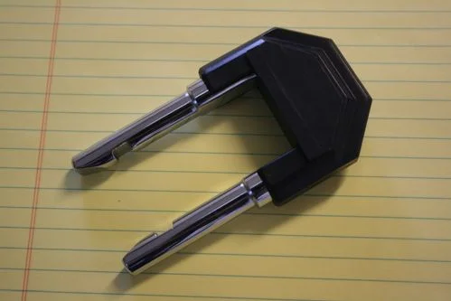

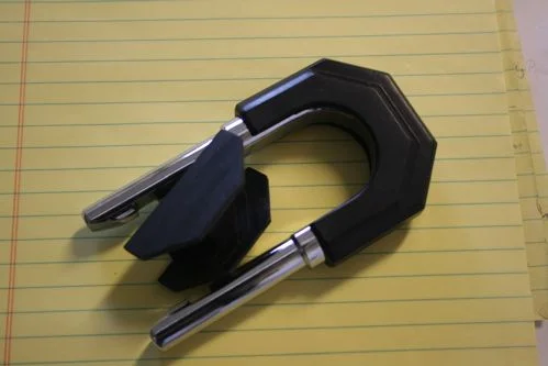

Jack Simian is a really nice guy, and was very helpful on the phone. His product was a great deal even at the full price.
Couple things to keep in mind, I installed mine in a rather unorthodox manner. I did not like where it would be if I bolted it to the trany tunnel. The normal place seems to be at the bottom of the shift pattern toward the console, since my console is gone and I use that space as a pass-through, that would have been in the way. Bolting on to the tunnel at the top of the shift pattern would get in the way of things I like to place there when on trips. So I mounted it to the dash. I do not know if that would work on a 62, on a 60 the metal dash structure is very strong there, and the two bolts that hold the shift lock on straddle one of the dash braces. I made sure that even if the the plastic part of the dash were broken/removed, that it would still be very difficult to get the nuts off the supplied carriage bolts. You can not get to them with a wrench or pliers, you actually need a short socket and a ratchet with a wobble. Then the last thing is that there is not much space between the dash and the shifter (remember that you can always bend the lower part of the shifter to put it wherever you want) so that made for a complicated bend on the mounting bracket, it also allowed the shifter to be moved out of first (the gear it is locked in) and into neutral. Not a big deal except when you are parked at a trail-head and someone breaks in to steal your truck, gets pissed that they can't, and decides to put it in neutral and push it off the cliff you are parked next to. Since I loved the mounting spot I just milled a block of nylon into a spacer and epoxied it in place. Now it is stuck in first gear. If you pull really hard you can just barley get it into neutral since the dash will flex a bit, but it will not stay in neutral on its own.
I am attaching pics of the spacer.

I think this is the same key here, I can pick most locks and I would have a hard time with this one. Double set of tumblers come in from the sides rather than the top, kind of like a low tech version of a BMW key. I'll post a pic of the key.

You milled that insert!!!?? You truely are a talented and out-of-control individual!

not the same.... I'll snap a photo of mine later--- much, much more intricate. Great key. But not worth a bunch of extra $$ IMO.

Which is exactly why I prefer to get one of yours vs. another one of mine!!
Here is a pic of my key:

That is a crazy key, I couldn't pick that one.

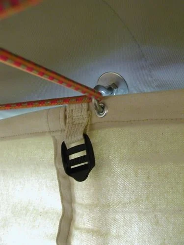

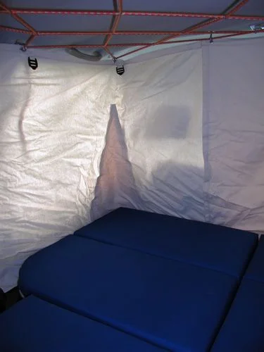

I have a couple of outdated pics from when the curtain was brandy new that I will post.
And I just like a good sleeping bag for cold weather camping, cant get much simpler than that.
The curtains help to keep the truck warmer, and now that the windows are limo tinted we primarily only use the curtain when it is cold. When the truck was first rebuilt I put a layer of reflective foil bubble insulation and a layer of wool carpet batting in the roof, that moderates the temperatures a lot, we are not sleeping right on the metal floor, the upholstery and air space in the drawers insulates us from the cold.

I have an old industrial sewing machine at work, and the curtain is just made out of cheap canvas from a local boat fabric supply. The plastic D rings have long since been cut off, now I just use a short length of accessory cord to tie the rolled curtain to the eye hook.
