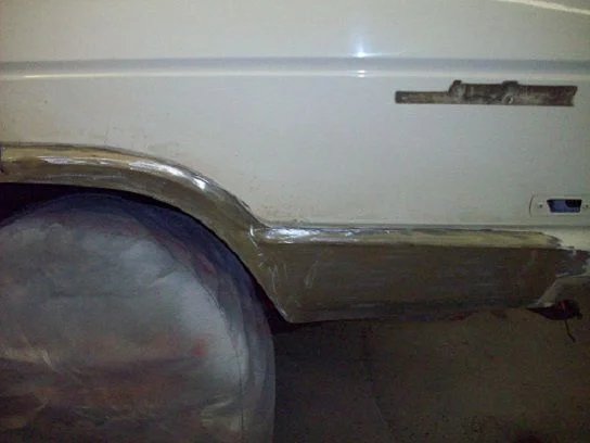

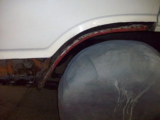

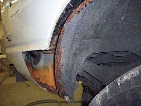

The CCOT pictures are accurate as far as coverage. The panels do not include the front dogleg or extend all the way to the rear (they stop in front of the bumper "pocket"). On my passenger side the bumper pocket needed to be replaced. A full panel would have helped here, but I chose the shop that I'm using because they are a full resto shop and scratch fabricating patch pieces is no big deal for them.
The inner wheel well lip/pinch weld area was shot on both sides. These had to be rebuilt. As soon as I saw the pictures I had them but open the front doglegs as well. I'm sure glad that I did - even though there was no rust coming through on either front it was just a matter of time. They cleaned, patched in a bit of new metal in places, and sealed the front halves as well. The Wolf panels might have been better here since they include the front dogleg but in my case all the outer needed was to be cleaned up, sealed and welded back in. It was the inner piece that needed portions replaced. None of the aftermarket panels or factory panels will include this, and you won't know what else needs replacing until you get in there.
Here are some pics that show the inner lip damage:

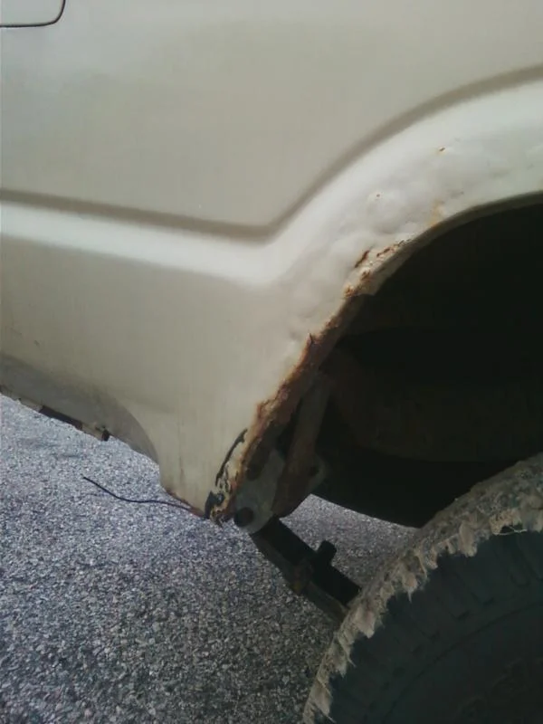

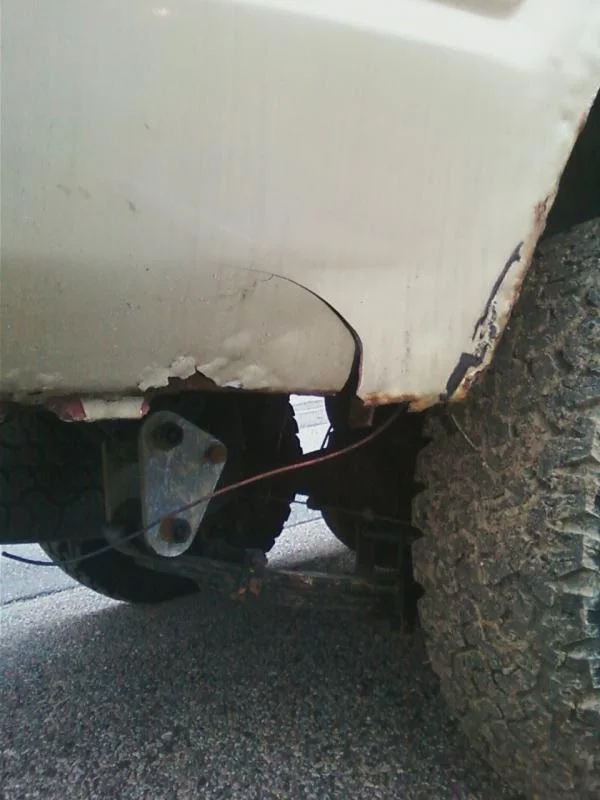

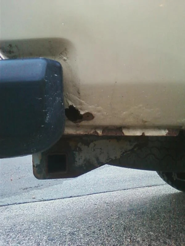

This is what I need to replace on the pass side, so the CCOT panel is not large enough....
Zack

I would try to get a used factory piece that includes the pockets. I would assume going in that you're going to need to fabricate portions of the inner panels as well, along the bottom of the quarters and through the wheel wells. You can take off the interior panels and take a look down into the quarters with a mirror to see how bad the damage is to the inner panels.
