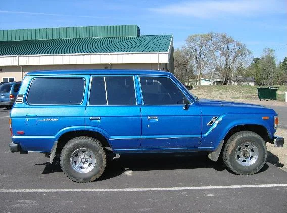

1: Original Condition 2: My cut rear quarters

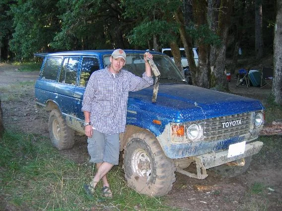

More pics:

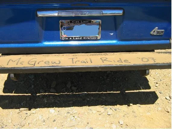

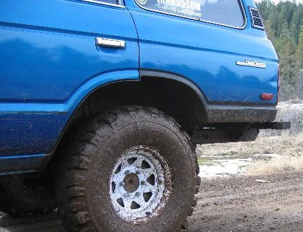

1: My rear bumper so far - on the McGrew Trail Ride
2: The sum of my carnage from McGrew.

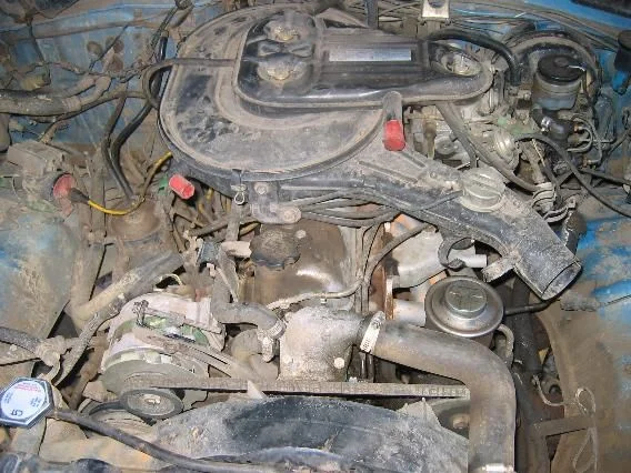

Did you have any problems with the desmog? I'd love to be able to move back to Oregon so I could de-smog my smurf blue 60. Could you take a pic of the engine bay? It'd be weird to see it without all that smog crap.

It's dirty as sin but I'll get a pic of it tomorrow. I just took the desmog real slow and followed JimC's desmog diagram as closely as possible. Then, once I knew what I was supposed to keep, I eliminated the rest. I did have to make a block off plate with a port in it for the connection on the intake.
Air rail is gone. Smog pump is gutted and capped. That octopus of metal air tubes is gone. 90% of the valves that sit on the DS inner fender well are gone. you get the idea.

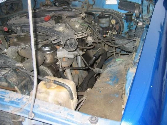

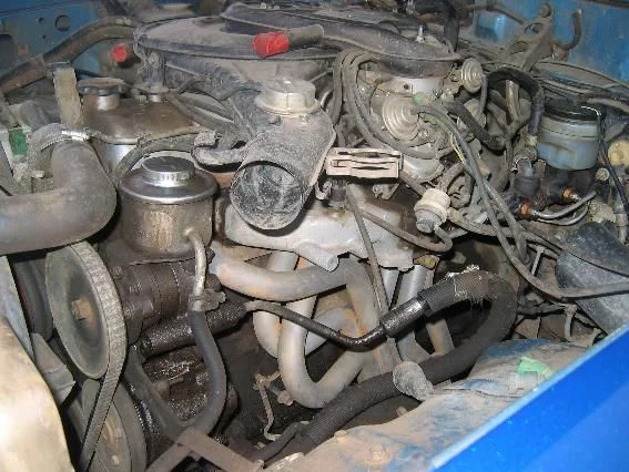

Here are some shots of the desmogged engine bay.
Bear in mind, the camera adds 10 pounds (......of dirt.......and grease.......oh well)
I'd clean it but it's about 15 degrees here.
No interior mods yet, planning on rear tailgate and qtr storage in the future.

Wow, you can actually see the engine. Very nice. Thanks.

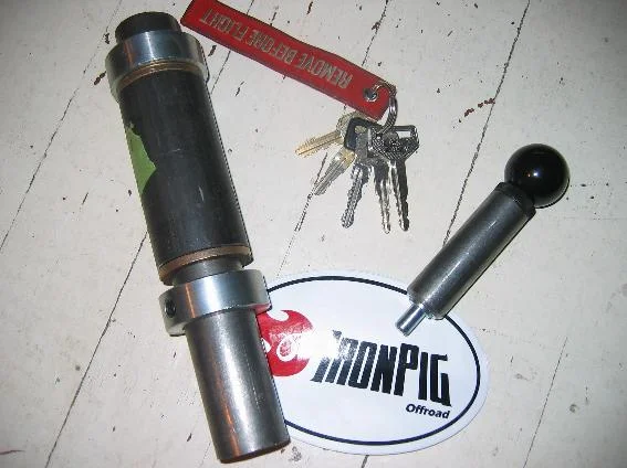

MrBrown delivered these yesterday-- two of each. That spindle is BEEFY. But I think I'm going to cut down the tube to a hair over 3" since I'll be using 2x3 tube for the swing out.
I've still got to figure out a way to mount the spring pins so that they'll actually engage the bumper- the body is right a 3".
