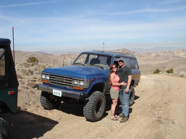

Hey all, My name is Keith, or some of you may recognize me as Chicago. The name of my beloved 1988 FJ62 is "The BLOTCH RIG", however, within my club (BBCNN) its referred to as "The grizzwald wagon"!
My story begins a little more than 3 years ago with an annual off road trip called BLOTCH!
Blotch has been running on the same weekend every year for the past 18 years. I was lucky enough to have been invited to ride along as a passenger on the 15th annual run. Growng up in Chicago (now residing in Reno, NV.) my exposure to off roading was essentially non existant, so this was an experience that was completely new to me. Needless to say I was very impressed at the capabilities the rigs and drivers posessed. Also, the group as a whole are some of the greates individuals to wheel and PARTY with...! It is the ONE run that I look forward to ON THE DAY I LEAVE, EVERY YEAR!
On the way home, I picked up a 4WD publication, and read it, then started parusing on the internet, researching varoius types of rigs, modifications etc. learning what a locker was, the difference between a solid axel and an IFS, what a lift was and what was the true purpose for it, with the idea that one day MAYBE I could get a rig for myself.
I decided that I wanted a rig with a solid axel, and a fuel injected engine, something that was in good running condition, but maybe not the prettiest thing in the world, something with maybe a mild lift and tires to get me wheelin a bit...
I began looking at the Jeep Wranglers and XJ's, and the toyota mini trucks and 4 runners (since those are the most exposed rigs you hear about). I had looked at a lot of rigs, weighed the pros, cons and costs of each that I looked at to get an idea of what I needed to do to get it where I wanted it. Everything I was looking at was beat and over priced and needed a TON of work.
Till one day I was looking on the local Craigslist...I saw an ad for an 88 Toytoa Landcruiser..."Landcruiser" I thought..."Never heard much about those." I called the guy to get more info on it. It had a mild shackle lift, 32 in tires, fuel injected and most importantly it had a SOLID FRONT AXEL! However, it did have some rust around the edges.I went onto pirate 4x4 and inquired about LC's there. George (OrangeFJ45) looked over the ad for me and said that it looked to be a decent deal! He was also the one who referred me here to mud! (Thanks again George)
I met the guy who was going to shcool to become and airline pilot and needed to sell off his toys to do it...I bought it In January on the 17th for 2500.00! In hind site I could have got it for a lot less, but I was totally GREEN so I bought it without negotiation. As it turned out it did have some rust on the tub...primarily the PS rear 1/4's and rear PS door. But the frame and components lookded pretty good and everything mechanically was in good order!
And thus, the BLOTCH RIG was born!

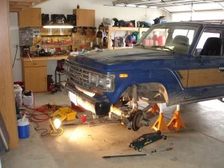

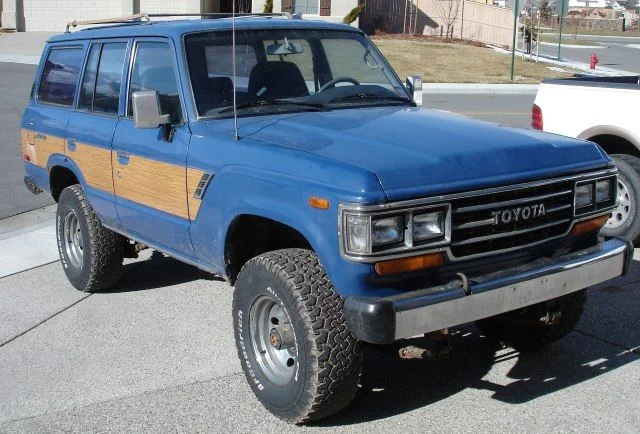

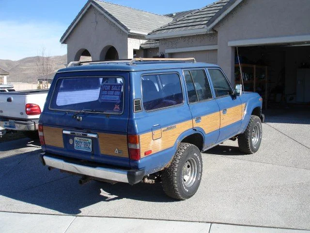

I promptly began working on it doing the PM stuff per recommendations here on mud with the main goal to wheel it down to Blotch for its inaugural run!
Here it is when I got her home after I replaced a bad alternator!

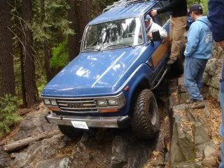

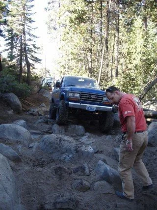

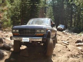

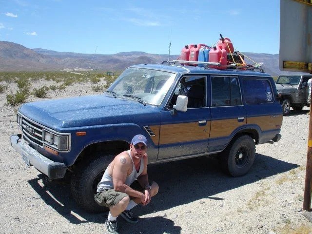

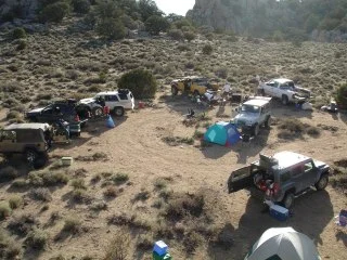

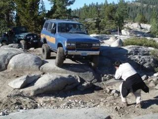

Here are pics of the maiden voyage...Blotch 06!
I had not wheeled EVER at this point, nor did I have much mechanical ability, so the 5 hour trip from Reno to Death Valley, wheeling for 3 days straight and a 5 hour trip back was daunting to say the least.
I had not ONE single issue and I learned what "Pucker Facor" was first hand!
Mace had given me his number before hand in case I got into a JAM being a newbie. Thanks for that Mace!

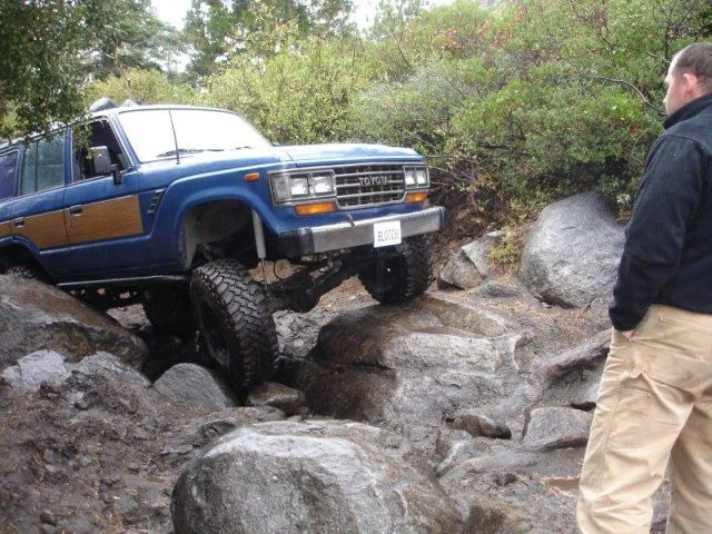

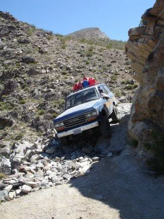

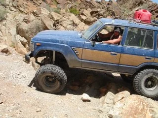

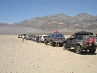

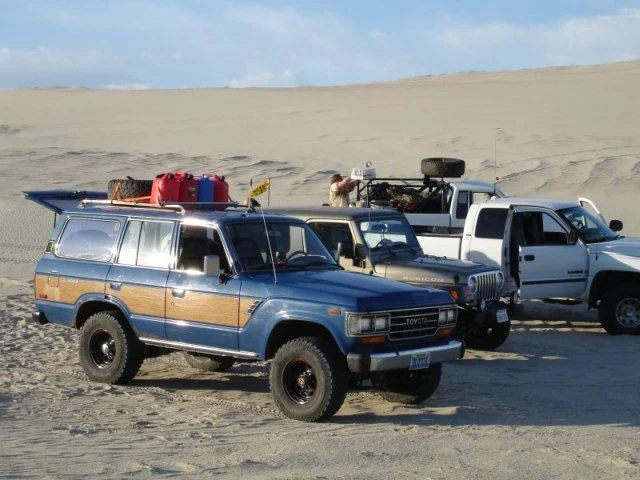

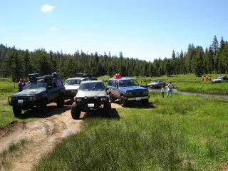

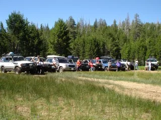

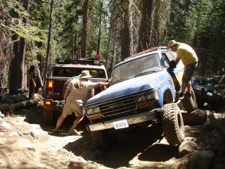

I later hooked up with the NorCal wagon folks and did a weekend trip consisiting of the DeerValley and Strawberrry Canyon trails!
This was an EYE OPENING experience! Never had I seen terrain like this! They were GREAT with me, as much of the time I was scared SH*TLESS!
Brett T (Dieselbigot) babysat me for MOST of the trip (which as it turns out would not be his LAST TIME babysitting me), and most everyone was awesome with my "newbieness." I learned SO MUCH from this run about wheeling, spotting, and all the fundamentals that is off roading! Most importatant, I realized what the "Landcruiser Community" truly is...the people!
It was this run that propted MAJOR CHANGES to the Blotch rig!

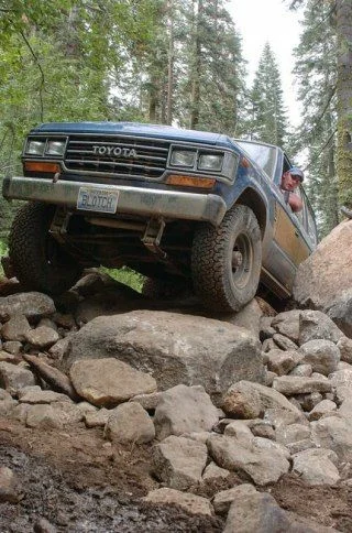

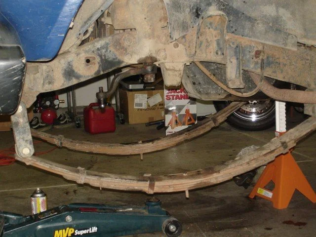

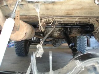

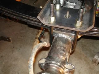

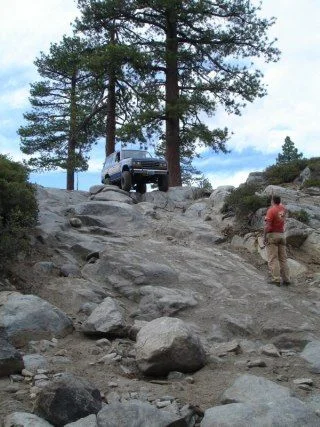

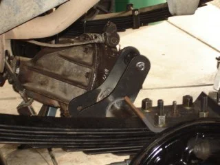

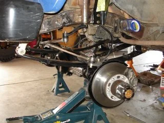

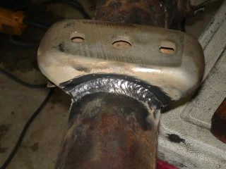

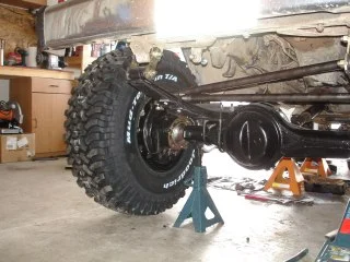

I loved the deer valley run and knew then that I wanted to more wheelin like that, in fact I had an itch to run the Rubicon one day. However, I needed a lift, lockers, tires and armor.
I kicked the string of mods off with the decison to go SOA!
I HATED my spring packs hangin up on the littleist crap, I wanted better articulation than the SUA set ups had and though it was the most work, it was what I wanted!
I researched here on mud, began accumulating parts, learned to weld and in Oct of 06 began MAJOR reconstruction of the Blotch rig...Mind you, I had never done any major work on an automobile before, and at this point I had only had the rig 8 months!
Quite a big nut to crunch!
OOOOH did I get a crash course! The experience was INVALUEABLE!
Here are a few pics!
Also, I did a FULL write up of my experience here on mud to help others who were going to tackle this project. I dont know how to post the link, but its here and its a LOOONG read Ive been told!

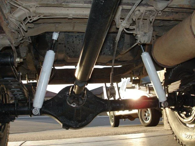

oops heres more
Almost completed, shocks mounted and a test run with RustyTLC!
I had to re learn how to wheel with the SOA! The performance is AWESOME, but the COG issue takes a bit of getting used to!
Id never fully understand that till the fall of 07!

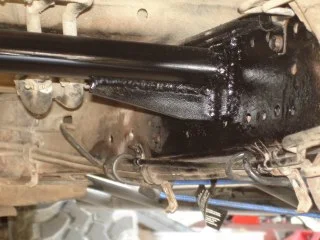

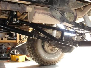

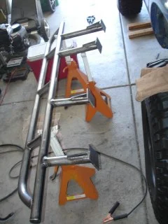

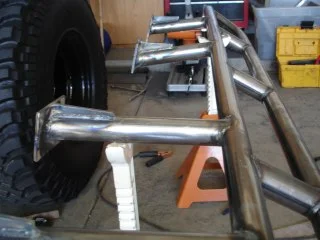

As mentioned, I wanted to run the Rubicon right...Well before that, I needed some protection, and a wrap bar. Here is what I (with help from the mud community) came up with...
Custom built x member and wrap bar...Cuz she was HOPPIN like a MO FO trying to climb SOA!

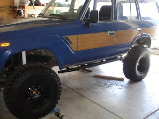

Marlin sliders!

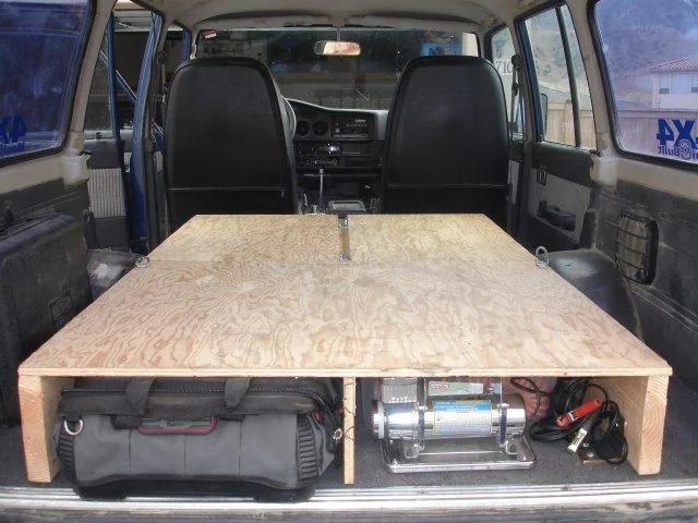

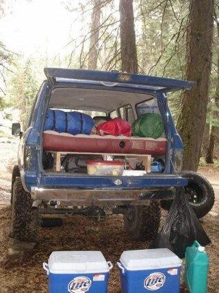

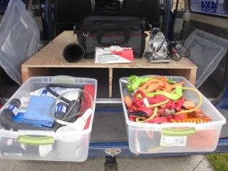

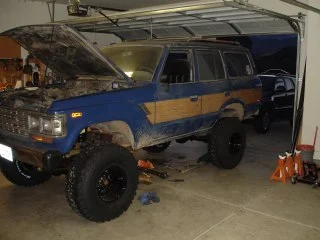

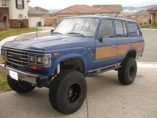

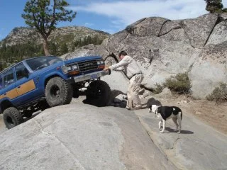

All the mods were done! and this is pretty much how she sits now!
SOA (Parts from Cuiser outfitters who also helped me along a great deal with the SOA process...Thanks Kurt)
Ford towers
Doetsch tech shocks (go to the internet to get the price, then call them to order and state the internet price)
DC rear shaft
Black rock crawler rims 2.5 in BS (RIms, tires, mounted, balanced with lugs and caps, shipped to my door...996.00)
35 BFG MT's
4.88 gears (1000.00 for both, set up with new bearings and locker installed)
Lockrite rear locker
sliders (179.00 shipped...custom fab...by me
Wrap bar (around 70 bucks for me to build including rod ends and hardware.)
Custom built in bed storage (Carpet and finish going in this winter!)
Coming up this winter!
ARB front locker
rear quarter chop and rust abatement
Dura line on the lower line
Wrap around rear bumper with swing out for jerry can and tire
Front bumper and winch possibly!
Later possibilites...
H55 manual conversion with marlin crawl box IF I go with the 2FE motor!
Or a vortec/ SBC with throttle body, with a 4l60E tranny and dual cases.
Ill deicde when the engine blows, which there is NO INDICATION it will happen soon!
Later FOR SURE!
Longfields and 36x 12.5 in TSL's!

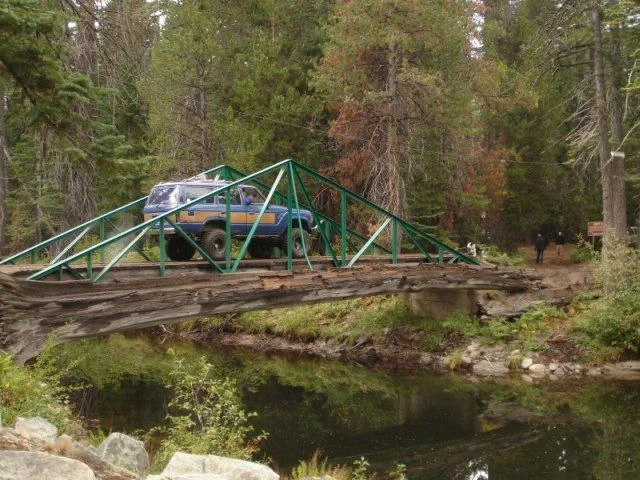

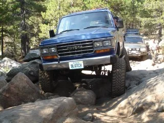

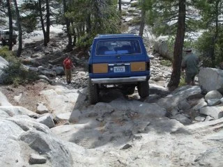

The pinnacle of my illustrious 2.5 year wheelin career came when the opportunity to run the Rubicon Trail with the Norcal crew!
Once again, Brett T had the duty of babysitting me!

More

Now, here are some more random wheelin pics!

Deer Valley, post SOA!
Got my butt kicked the first time, walked through it SOA and locked!

More Rubicon!

88 FJ62 (Sold to a good home. Goodbye old friend!)
76 FJ40 (Blotch rig part deux)
06 4runner...wifes rig!
06 Tacoma, DD, BONE STOCK and staying that way!
PROUD member of the WEST COAST BLOTCHERS and the Battle Born Cruisers of Northern Nevada!
FAWKING CUBS!
chicago is offline   Reply With Quote
Old 11-04-07, 08:59 PM   #28 (permalink)
Forum Lifer
chicago's Avatar
Join Date: Jan 2006
Location: Reno, Nevada
TLCA# 16202
Posts: 4,472
Quote:
Originally Posted by Ducks View Post
How long did it take you to learn how to weld? How are your springs holding up SOA?
Great pics, great story.
Chad
Hey Chad,
As far as the welding, I borrowed a friends 110 mig and started practicing in the end of July of 06 and started the SOA in the Middle of Oct. of 06, so I guess it was 3 months of pracitce and about 4 months till I did my first weld for the SOA which were the spring perches!
I posted my welds here on mud under the "workshop, tools..." secations and got feed back from other members on what I was doing. Then, I watched a friend (professional welder) run a few beads with the set up I was using and it really "SUNK IN".
Bevel your edges and prep the surface and if youre using a 110V burn the welds in and do multiple passes!
MIG welding is VERY EASY to learn and become effective with!
The springs have held up great! I was just under the rig yesterday, and they still have a good bit of arch to them, but I do have one long AAL at all 4 corners!
Here's a pic of one of the perch welds...I triple passed everything that I did on the SOA!
Chicago
