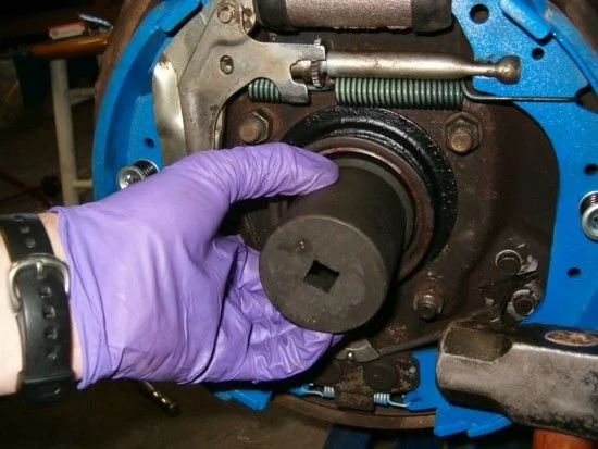

I used a socket the right size. I assume you are looking to drive in a rear semi-float bearing. No way you should ruin a set. They go right in with no freezing or other special issues. I think it was a Dana 60 hub socket that fit the best.
