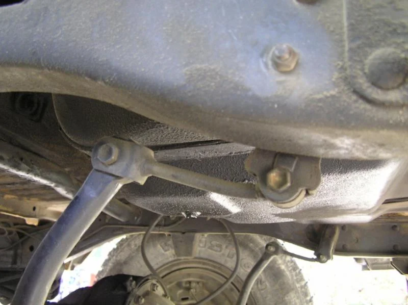

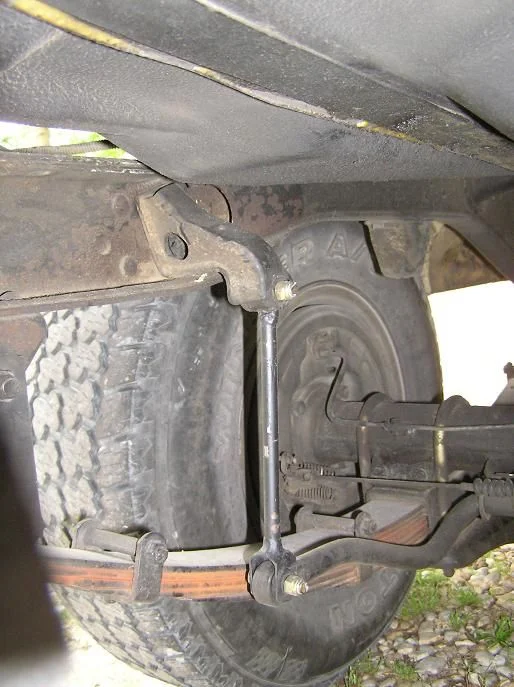

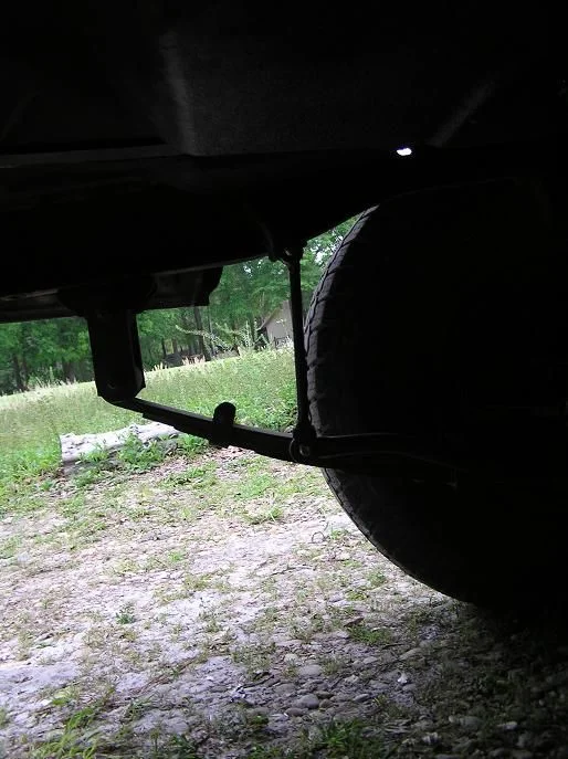

1) OOPS!
1) Sway bar links extended, (but not welded yet).

I'll snap a photo of my new, improved sway bar links, finished and installed, maybe this evening.

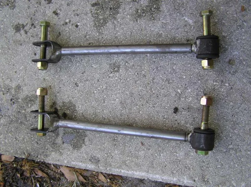

The extended sway bar links, all welded up, painted and installed.

Sweet links.

Thanks. Easy as pie to make.
Greg... See those? You do it the same way?
Tofudebeest is offline   Reply With Quote
Yep, pretty much.

Mine are prettier.
No need to extend the fronts?
