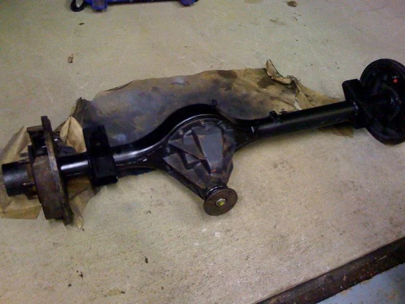

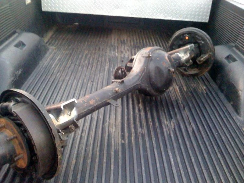

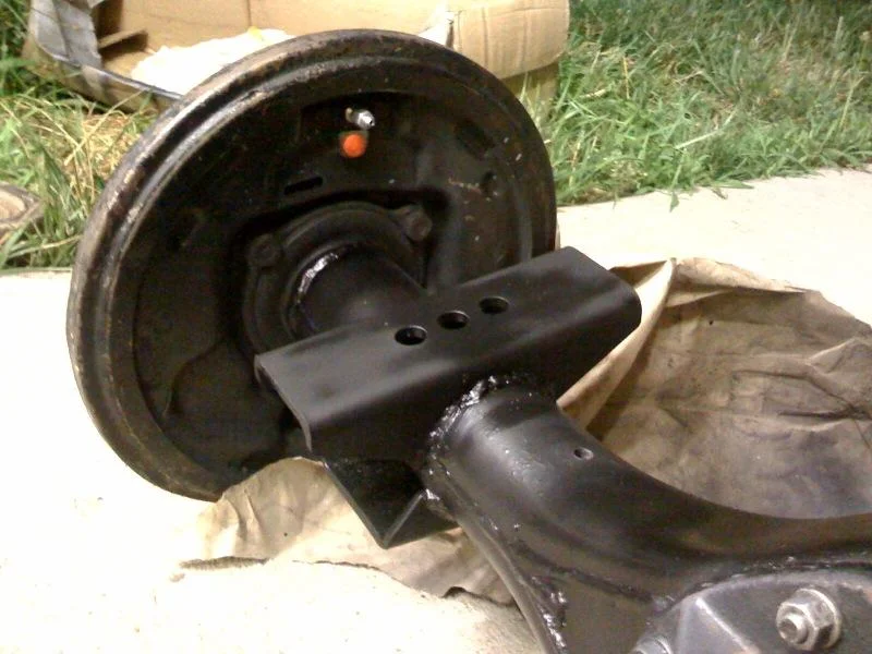

Today's update....
Last night, got the driveshaft installed and lined up the pinion. We set it so there was 1.5mm more space between the u-joint on the bottom than there was on top, so if that makes any sense, it's about 1* down from parallel with the driveshaft. I Think it'll work well. Tacked the perches on, then brought the axle over to kenny's to weld it up. Did that, brought it back over, slapped some paint on it and threw it under the truck. Today we'll torque the u-bolts, re-install the driveshaft, install the e-brake cable and make sure that's adjusted, finally bleed the brakes and take her for a spin.
