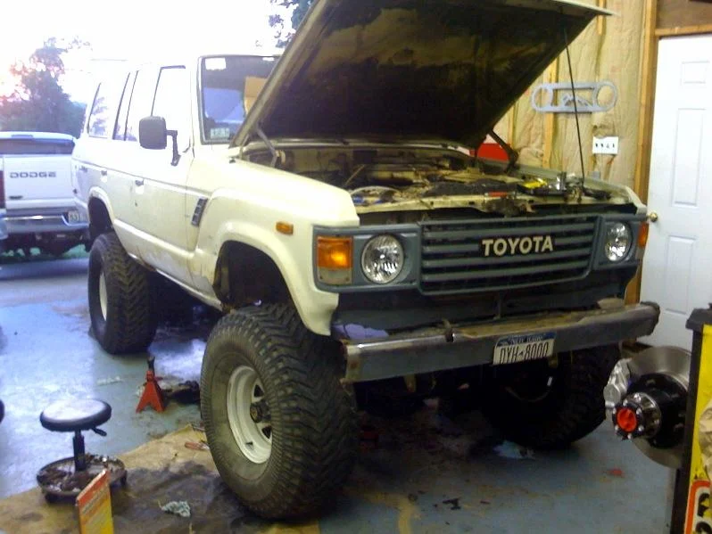

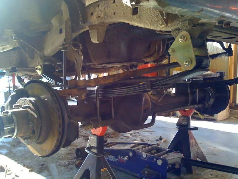

Tonight's update, front axle installed. It's gonna be high. Maybe I'll end up taking out the front AAL, but I am gonna wait till the rear is installed.

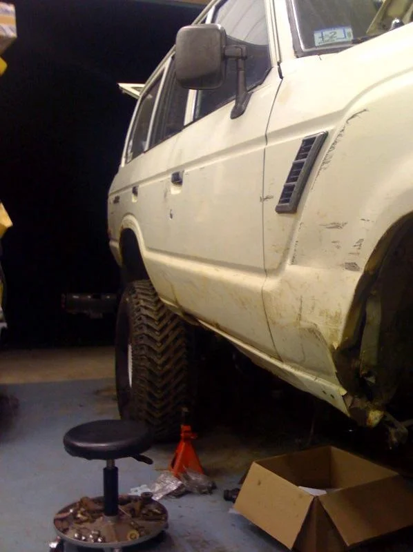

Originally Posted by goodol84 View Post
Any new updates on this beast??? I actually just want to see more pictures! And Ford Escorts Suck BTW
No updates yet. I dropped my FF axle housing at the machine shop to have the welded race ground down to spec and dropped my DC driveshaft off at a different shop to have lengthened for the rear. As soon as I get those two components back this will be on the road.
I ordered a set of bumpers for Moonshine a'la SROR. I'm getting his tube bumpers for the front and rear. Front is gonna have a bit of a higher stinger similar to freds40's custom front and the rear is going to be a copy of what brokenparts had on v1 of his rig ( pre-'tons ).
What else do I have to do
Shock towers
Shocks
Clearance tranny crossmember
Mount and balance tires
Buy spare tire + rim
As soon as this thing can roll, I'm pushing it out of the garage and cutting off the rockers like boots4 did. I can't stand staring at them any longer. We'll see how long it takes with the plasma torch.

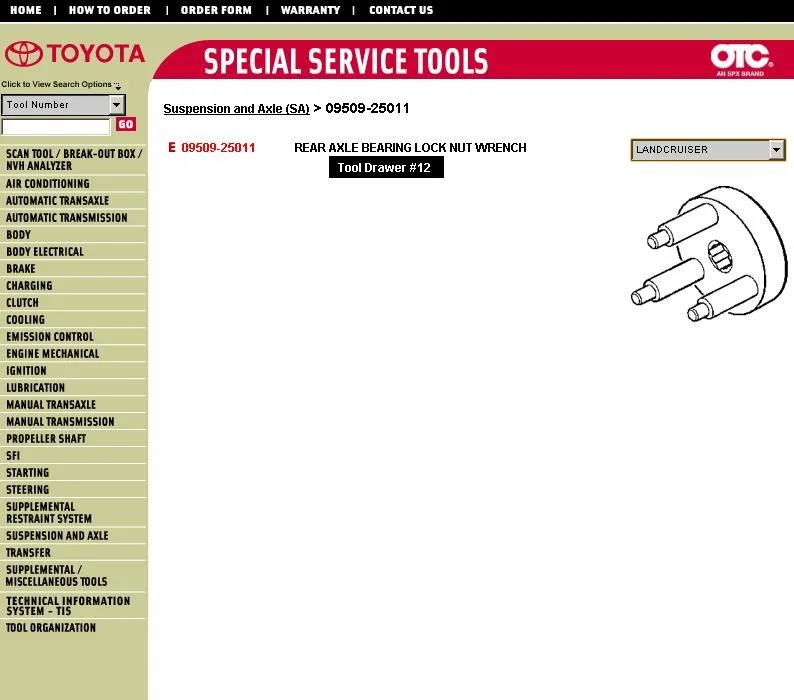

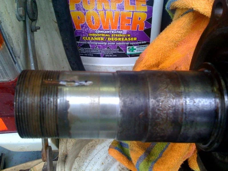

Finally some more updates. First I want to show my FF axle spindle. Just a re-cap, I bought this axle with a run out outer bearing race on the long side of the axle. To fix, you have to find someone to weld it to build up more metal, and then find someone to machine it down to the same spec as the other side. I had quite a time finding a machine shop with a lathe big enough to throw the axle housing, but I did and just got it back yesterday afternoon Here's the machine'd final product:

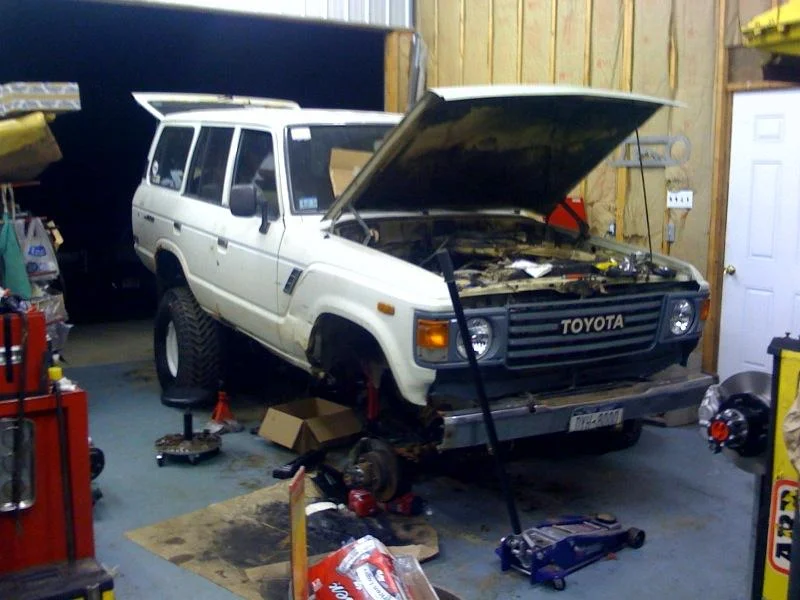

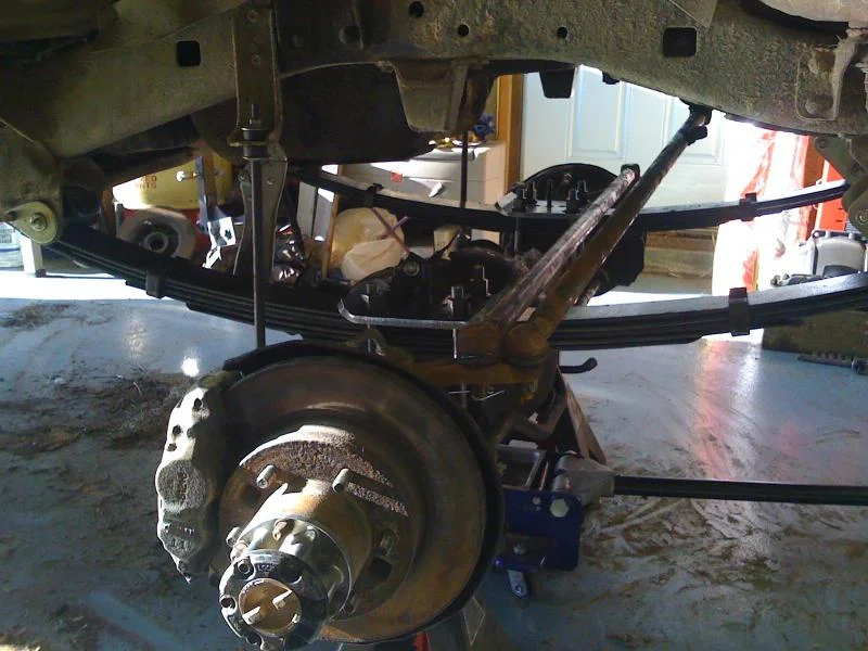

So after racing over to the machine shop to pick it up before they closed, I brought it and everything else I had over to the David's shop to get started right away. I ground down the locations of the perches on the top of the axle, slapped the perches on and threw the axle on the springs. We then centered the axle, put the weight of the truck on it and assembled the brakes with new wheel cylinders. At that point, I realized that the bearings I had for this axle had rusted in the weeks since I took this apart, so Kenny busted out a spare set of wheel bearings from the front of his 80, same numbers!! After cleaning and packing those, we had the hubs on. Now, to set the preload on a FF axle, one must have the special Toyota SST to do so. It's a 3 prong tool ( pictured below ). After fabricating one of those from a 3"x3" plate and some spare bolts, we set the preload and threw the tires on.

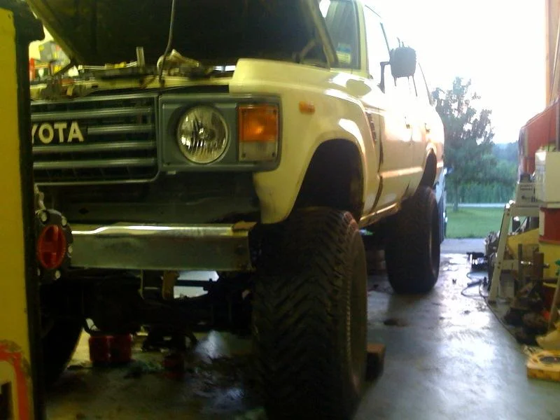

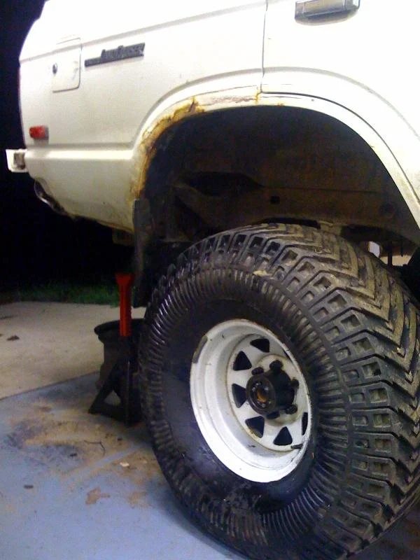

So as you can see, it's obnoxiously tall. The rear springs are new, so they will break in, but I may end up taking another leaf out. Time will tell. Today, we are going to put the front wheels on, front brake line, grease all of the busings, install the spring pin lock bolts and re-torque everything except for the rear axle u-bolts, because those will come back out.
Getting closer! If we can weld up the rear on Thursday, then I'm taking it camping this weekend :bounce2 :
As it sits now:

Okey dokey, last night got a couple of misc things done on the truck. Greased all the bushings, installed new spring pin lock bolts, installed the front SS brake line, threw the rear diff in and put the front tires on. I think it looks pretty badass. The frame height in front of the rear spring hanger is 26.5" and behind the front spring hanger is 26". The rear tires are a little flat, so approx 26" front and 27" rear. NOT BAD!! I think it looks like a million bucks.
Today I'm going to try to pick up the rear driveshaft so we can line up the rear axle and weld the perches on. Then it's ready for the weekend.

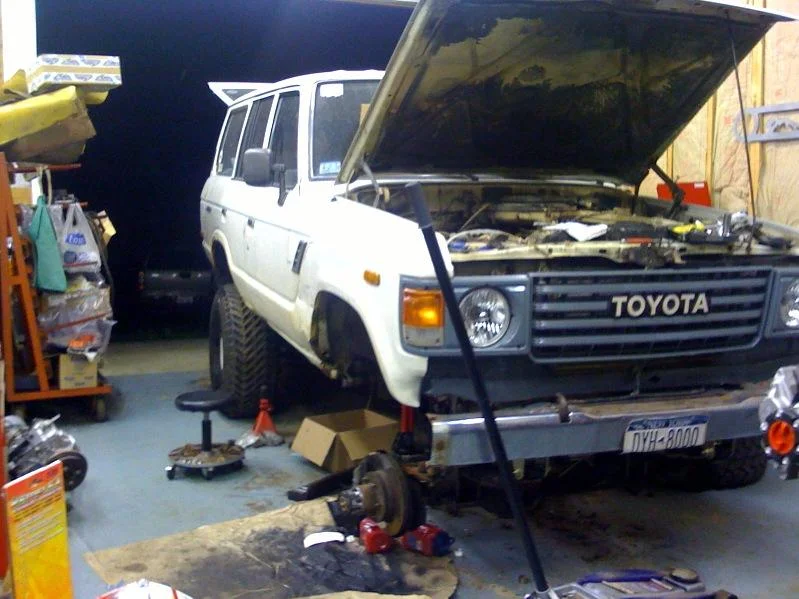

Those tires do look schweet now that they're on! I expect to see John and Ponch hopping out in their CHiPs uniforms . Definitely old school! So...what happened to the old tires?
Mall cruiser!! Hahaha, nice buddy. The first time those tires got flexing on my truck, it was on a loading dock. Glad you like them! Were they out of balance?
Tires feel good! I'll get them checked soon, but no vibration. Even at 80mph. Yeah, had to get a poser pick at work. Actually backed into my golfcart before I put my tire up on the barrier. Whoops .
