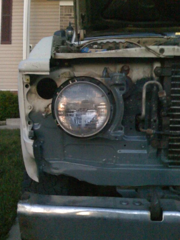

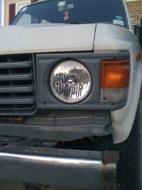

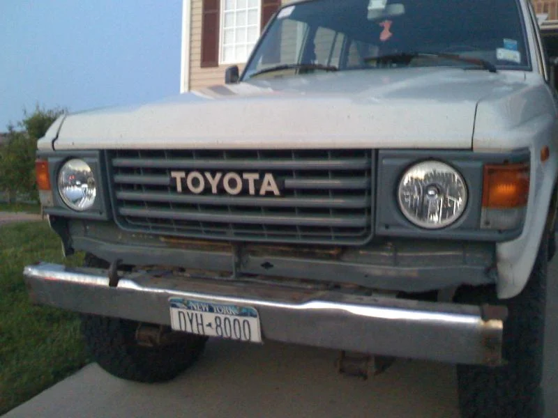

Installed my Roundeyes headlights and painted my new headlight doors + grill with "Industrial Grey" from my local Tractor Supply. I think it came out pretty well and the headlights are wicked bright!!!
SOA this weekend...........

MMM, bright head lights... I still need some real headlights. Did you do your own wiring?

Roundeyes are plug and play. Works with the stock harness and they're pretty awesome. I highly recommend them.
On another note, I'm starting to think about what tire to buy for my rig. I will be DD'ing this probably about 12-15k a year, so I was thinking another set of BFG AT K/O's in the 35x12.5 variety, balanced with dyna beads or some equivalent. Any thoughts?

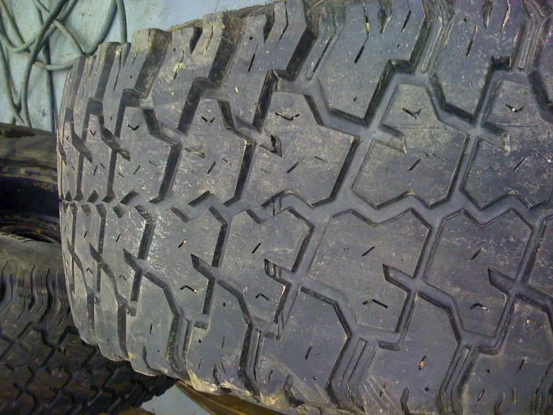

I know this has been beaten to death, but no one has a suggestion on a better DD tire in this size?

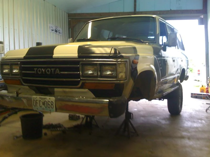

And so it begins.....
My 60 can float, and when it does that I can get 1,000,000 mpg.

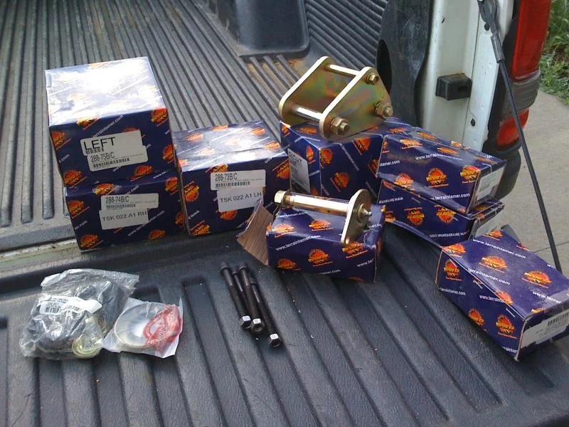

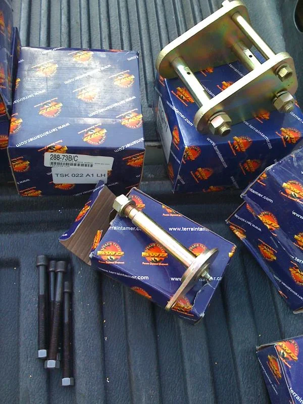

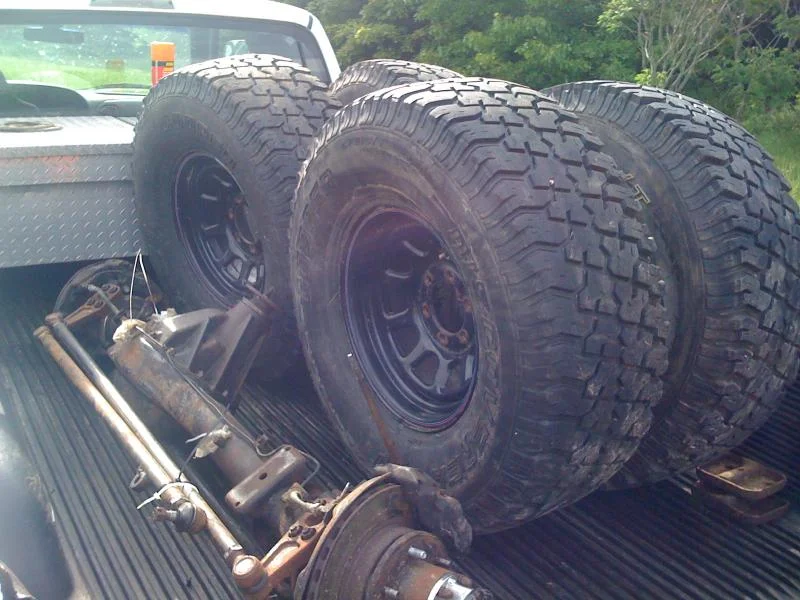

Just got home from the 1100 mile round trip to pick up my initial set of tires and front axle. It's 4am eastern time and I'm going to bed.
I'm going to run the trac bar because I have a really heavy right foot when it comes to wheeling and I would rather not spend most of my time on the trail replacing broken pinions.
More pics and progress tomorrow. Thanks for the good word guys!

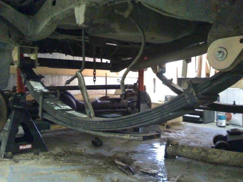

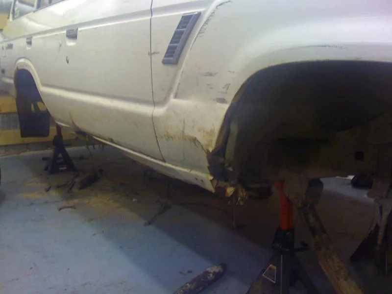

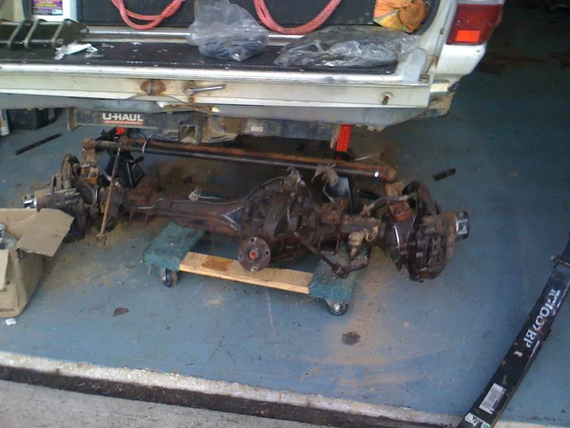

Ok, update time.
So after taking the axles out from the truck on Friday after work, the next step was to bring them to Paul, who is near Rogersville, MO, approx 1100 miles from where I am located right now in Lexington, KY. I traded Paul my two axles for his setup SOA front 62 axle and a set of 35" tires + rims. Paul is a great guy and my truck will be a good home for the axle. I got home at 4am after a very long day wearing my assprint into the drivers seat of Kenny's truck ( thanks Kenny! )
Today I didn't get much done, but I feel good about it. I need to replace the pinion seal on the axle I picked up ( leaked all over the bed of the pickup ) and pick up some more parts. I need 4 greasable frame side spring pins in addition to shackles for the front, a pair of center bolts for my front springs. David has a set of 36x13.50 Mickey Thompson baja's that I'm going to trade him for and after that, all I have are questions and pictures. First the pictures...
1. Truck my new front axle came from
2. My end of the deal
3. By far the easiest way to load / unload axles out of a pickup

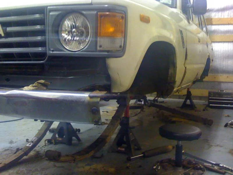

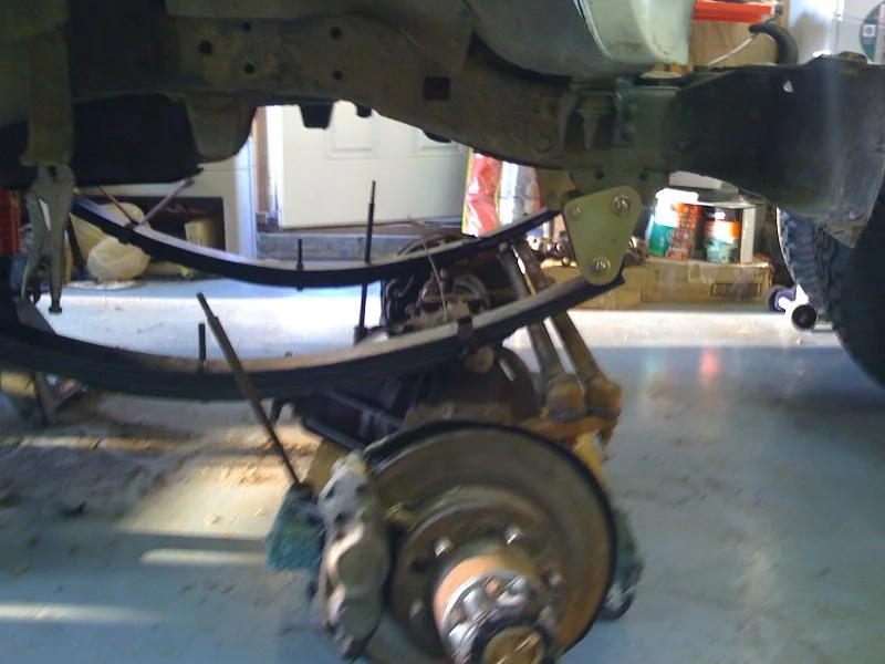

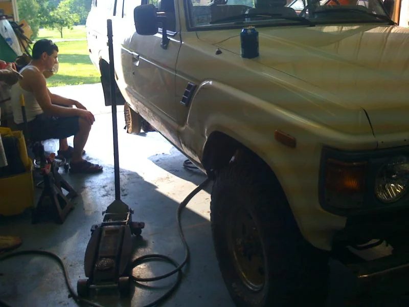

More pics...
1. Axle's new home
2. Disassembled front springs
3. Tire example

Now for the questions.
First off, for center spring pins, do you guys just use bolts or do you order new center pins? Mine were all bent and rotted, so they need to be ordered.
Next, see the tire picture above. There is more wear on the left side of the tire than the right. The outside of the tire ( when mounted ) is the more worn side. What would cause that??
Painting the springs. Is there any tangible benefit to painting the springs while one has the pack apart aside from aesthetics? I was planning on cleaning them, but if there is no real benefit to priming and then painting them, then I'll just clean them up a bit. Either way, the NE salt will make them rusty soon anyway.
Thanks for the advice guys.

Quote:
A little too much toe-in on the camber?? Is that a common SOA side effect?
Looks like you've had a busy weekend! I like the paint job on the 62 .

Quote:
Camber is not adjustable on these solid axle rigs, so if it was any other vehicle I would say the camber is off. I have no idea what would have caused this and I definitely have never seen it before.
Definitely a busy weekend. I do not recommend driving for 18 hours straight,

I had that same problem with tire wear, replaced my springs, shocks and it went away. I might have had a bent spring bc of a wreck I had earlier or maybe a shock was bad.
Just my experience.

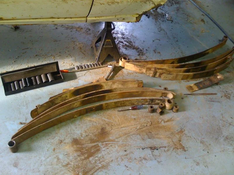

It's really sad how little 400 bones will get you. I got a really good deal on the set of shackles, don't get me wrong, but damn. I got an extra set of spring pins so that when I break one I will have a replacement. First pics of the parts so I remember how shiny they were in a year.

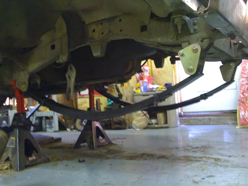

Installed the springs with the new poly busings and greasable pins + shackles. The front springs came out great all painted and the rear springs had to be flattened out a bit with a ratchet strap and a board to fit. It's all together though, so the next stage is to install the front axle and get my damn rear axle housing back
