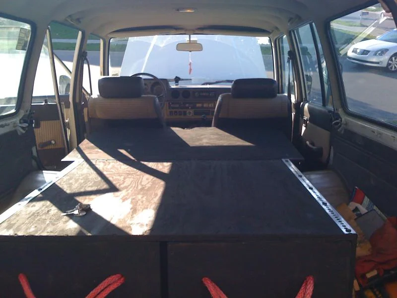

I'd like to do the same thing on mine; any reason you didn't widen it out to the wall panels aft of the wheel wells? And are the nice red handles leftovers from earlier, or the remnants of the Black Mountain debacle? Nice work man!

I'm glad you asked!! The reason why I didn't expand it to the sides was to be able to accommodate Kevin's Quarter Panel Storage Hatches which will match my Tailgate Storage hatch. However, he just made a set with doors that have the hinge higher, so I'm not sure if it was worth while or not. Time will tell.
As for the winch line, Kenny said that it was left over, but I'm gonna say that it's the remnants of that night. I will NEVER forget that trip!!

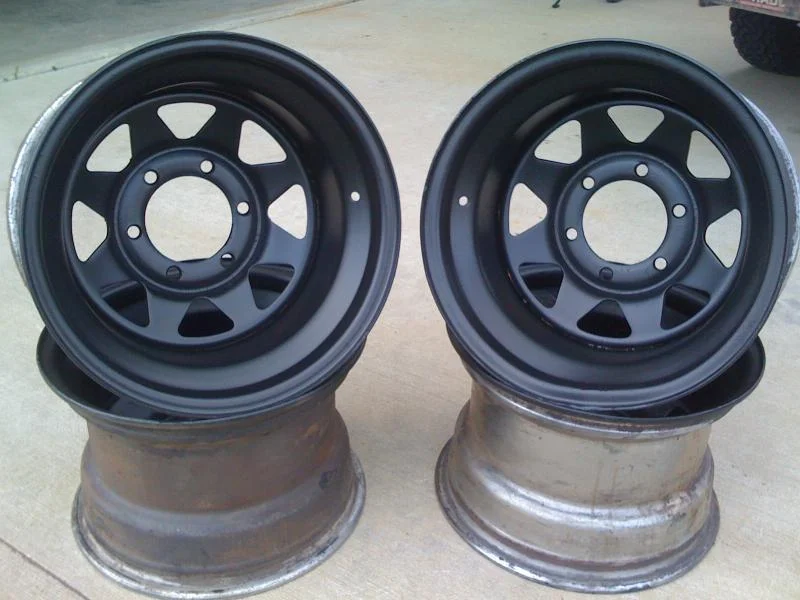

Haha, true. By the way my wheels are getting here tomorrow. They hit the UPS facility in Lexington today, so they'll be here tomorrow!
15x10 w/ 2.5" BS steelies that are getting powder coated. SWEET!

Guys, here are the dimensions for the drawers in case anyone wants to build them. I also attached a pic of the sleeping platform folded out. I gotta tell you, I love it!

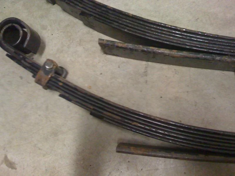

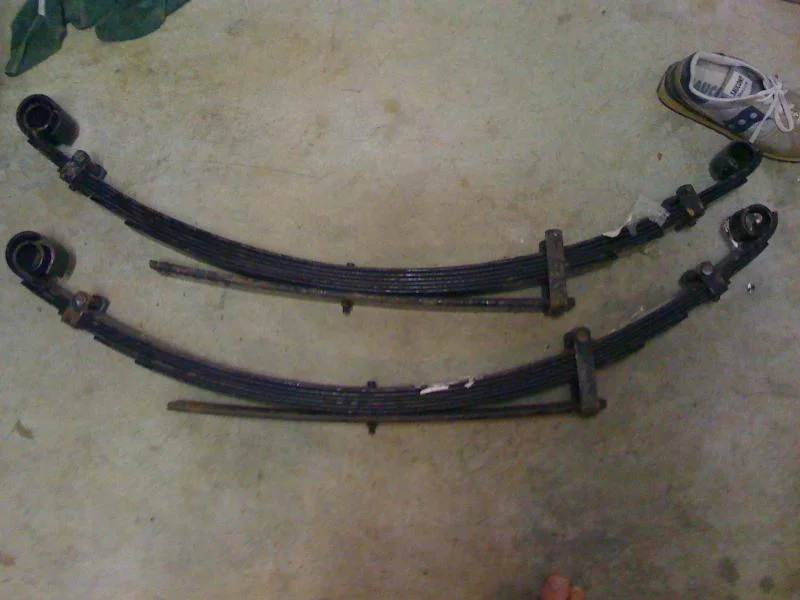

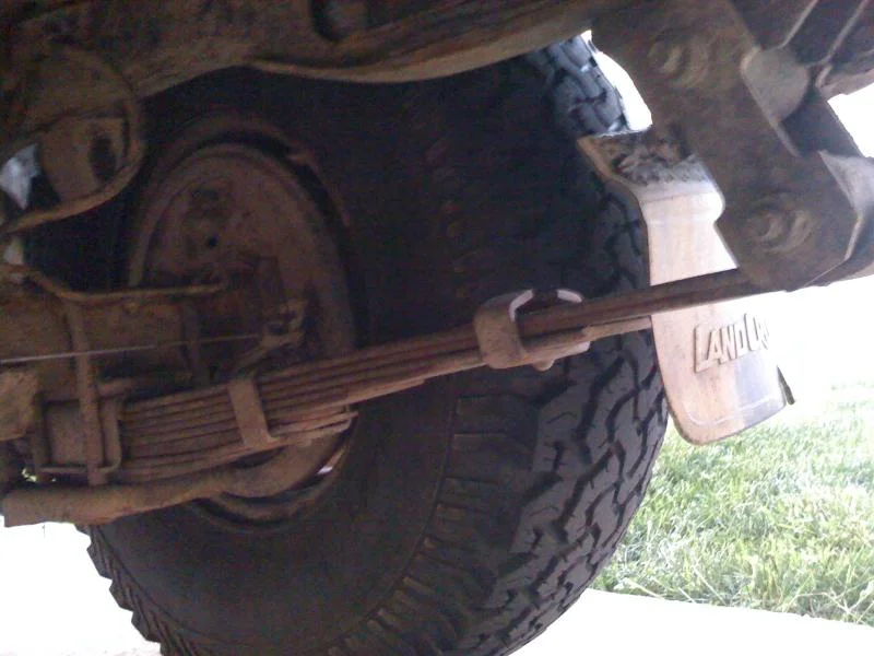

SOA Project Officially IN PROGRESS!!
My SOA ambitions just got supercharged the other day when I found another mudder who wants to convert his 62 back to SUA from SOA, so I am swapping axles with him! I am going to start collecting parts, and I'm PUMPED!!
My plan is to take this already set up SOA front axle, bolt it in with the stock springs and convert my FF rear to SOA and bolt that in with a DC rear driveshaft. Parts I need to get:
Ford Towers
Spring perches
U-bolt plates ( already have the u-bolts )
Extended Front frame to axle brake line
2 DC Drive shafts
Two early 60 t-case companion flanges
misc stuff
First step for me is to rebuild my current front axle in prep for the swap, so that will hopefully happen this week. I'll put everything in this thread, so yeah, I'm pumped!

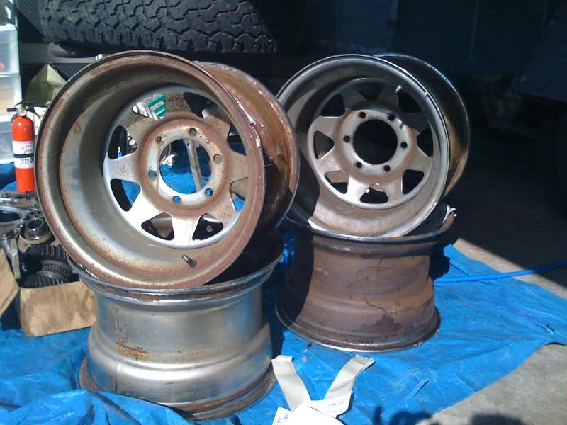

On a separate note, Kenny and I powder coated my new rims today, which came out AWESOME!! Here are before and after shots:

The wheels look great!

I like the wheels! I'm starting to save for some new 33s. When I get 'em I'm going to black out my rims too. Maybe I'll have some real tires in time to see ya in PA?
How was TN? Got any good pics?

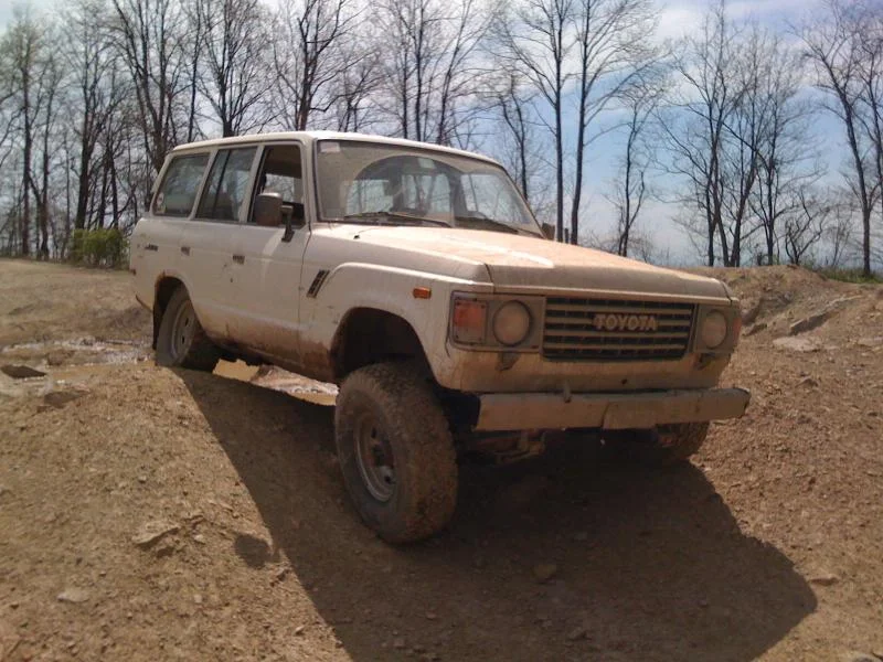

Thanks buddy! I have another offer for you. I am doing this SOA and will have no use for my 33" BFG's. They have about 1/2 tread and I'll sell them to you for cheap if you'd like them!
Pics, and yes, that is Todd Kaderabek, editor for Toyota Trails, in the Tacoma

Nice Pics! PM sent on the tires. I haven't wrenched on the truck since before we went to Kintuck. I keep checking your ROTW and getting psyched up to start going again. I'm starting to search for clutch parts to do the 4spd swap as soon as I can get Larry to visit you. Thanks man! I'm all about the hand-me-downs

Tech question: so I have a rear set of Ironman 2.5" lift springs that I was planning on using before I realized I was going SOA. The rear springs on it now are 62 springs with short AAL's. My question is should I put a long AAL in my 62 rears ( getting flatter as we speak ) and use those or should I take a leaf or two out of my Ironman springs and use those?

Are the ironman's and the 62's springs the same length? If not I'd go with the longer set and readjust it as necessary. If you keep the rear SOA low (shackle through the frame) the 2.5 shouldn't do much. The other question is which springs are in better shape? Any pics to share to get stacking/removing ideas?

Ok. Springs are approx the same length at ~4ft. Here are a few pics to illustrate the springs. The springs on the truck are 62 springs with a short AAL, the set on the garage floor are the ironmans. I was thinking about taking out the bottom two leaves on the ironmans and running them, or putting a long AAL on the 62 springs and running them. The reason why I want to modify the pack instead of running it as is, is because the front springs have more arch than the rears and I'm tired of the truck squatting.

My 2 cents:
The ironmans definitely look to be in better shape and I'd be inclined to use those. I'd take the smallest leaf out but leave the overload and start from there. Expect to readjusted the pack but hope that it turns out perfect the first time.

Sweet. Hopefully the axle wrap won't be too bad with the overload till I can fab up a trac bar. Thanks for the advice Mike!
