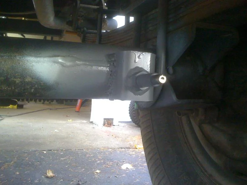

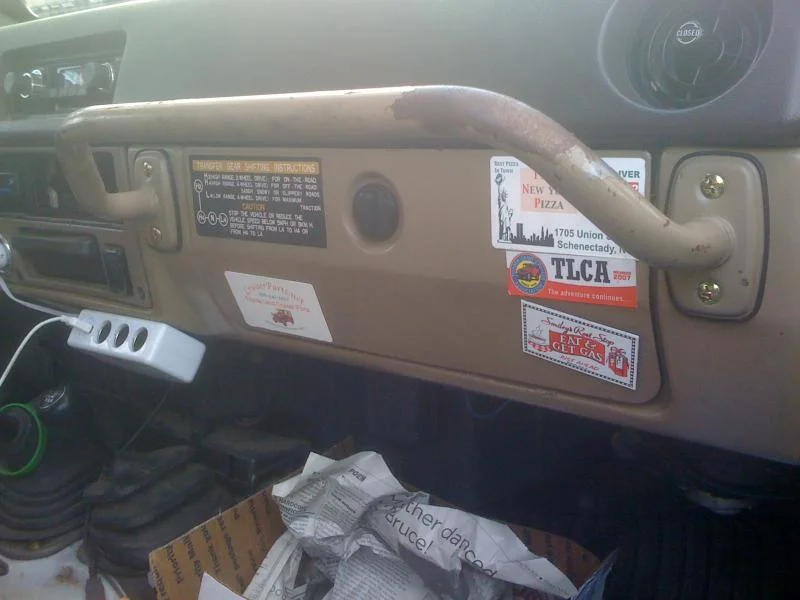

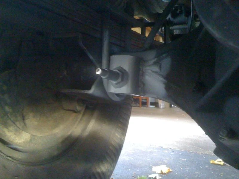

Went over to Kevin's this weekend to get some stuff done. I welded half of each shock mount onto my rear axle and Kevin welded the other half. My upside down TIG welds suck and his are absolutely incredible. I need to practice more! Got some pics at the bottom.
On top of that, got my dash grab bar installed and welded my windshield wiper back on. Screws fell out of it a couple of months ago on the highway, but I was able to recover the blade itself. Didn't have any screws, so Kevin welded it up for me.

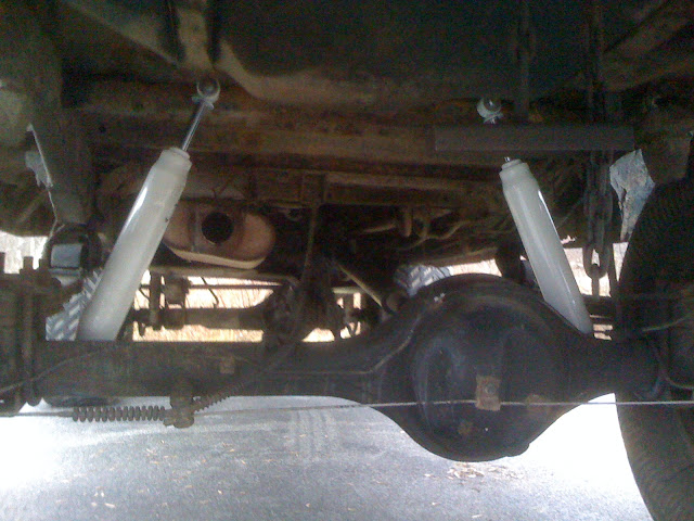

SHOCKS!
I need shocks. I know that the Bilstein 5125's will work but I'd prefer not to spend that much money. Rancho 9k's don't seem to be any less expensive and I can no longer find the Doetsch Tech 8k's for sale anywhere on the internet. Anyone have some used shocks in the 10" travel range for sale?

More shock research: Man-a-Fre has a Hecklethorn shock in the correct dimension for the right price - $25 less per shock than the Bilsteins. Anyone have experience with the Hecklethorn shocks?
9136 HECKETHORN HI-PERFORMANCE NITRO 9000 SHOCKS FJ55/60 E-01/90 FT 4 INCHES 15.39-26.29 $49

Did you have to make the grab bar mounting pads or did you find a source?
Butt

Quote:
Butt
Got those used from SOR.

i really like the grab bar I need to do that for the wife .

Quote:
Exactly why I did it man. My GF loves riding shotgun but she needed something to help her get in. This should do the trick
ANYONE have ANY experience with the heckethorn shocks? These are the cheapest ones I can find, I just can't find anyone who runs them.

i found skyjacker nitros on ebay under the skyjacker outlet. Says they are blemished i.e. scratch and dent but when i got them they looked great they were the n8060 and the n8079 seems to ride good with them. THey are nitr charged and take up the slack of the soa. Cant remember the price but i know they were dirt cheap.
Good luck

I am running Pro Comp ES9000 shocks...Best shocks on the market? No. Cheap with a wide range of sizes at summitracing? Yes.

This week's update:
Got the shocks installed. Makes the ride a bit better Had to cut the tailpipe off in order to fit the shock on. Got a little deeper exhaust note now
Got pulled over the other night. Turns out that my rear harness connector had corroded off a couple of wires, so I had to figure that out today. A couple of weatherproof connectors later, problem fixed. Taking it to get inspected this week!!

Still following this.
Just get the exhaust re-routed so it doesn't hit your shock. I think when I had them do that it was less than $100.
Good build.

Thanks for the kind words man! I really want to make a trip out west one of these years, but my class schedule really gets in the way and when that doesn't, the lack of money in my bank account does Where do I find info on the Rubithon? I'll take a look at the timing and see if I can do it.
As for the exhaust, I cut it off right after the muffler. You can see the end in the picture I posted. I plan on making / buying a little turndown to come out the side like Cruisin'FJ60 did on his, but my $$ situation is not conducive to having a shop do it. I saved my tailpipe so I'll probably use it to make a turndown myself.
