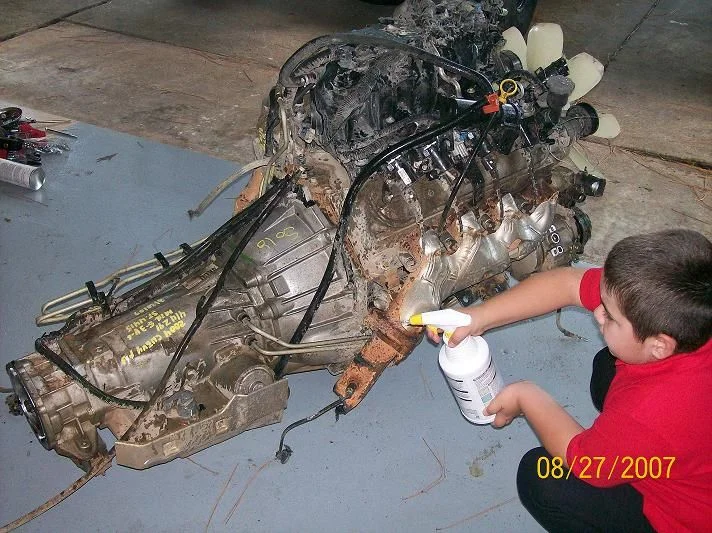

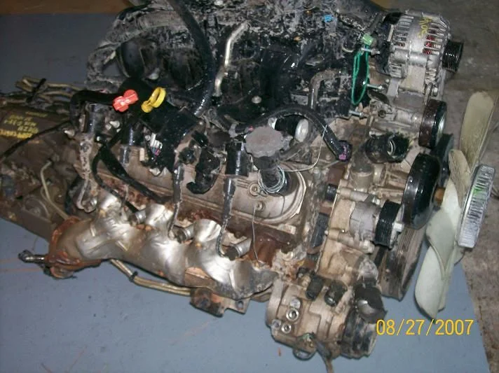

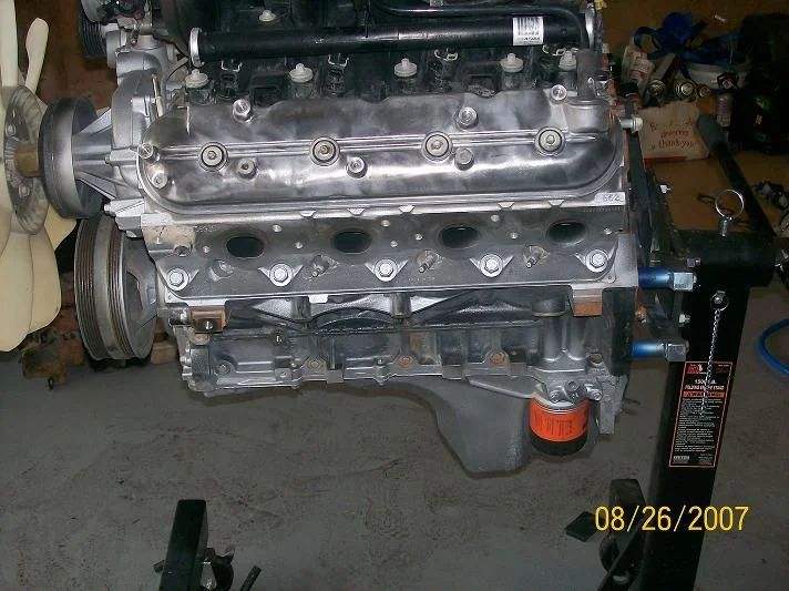

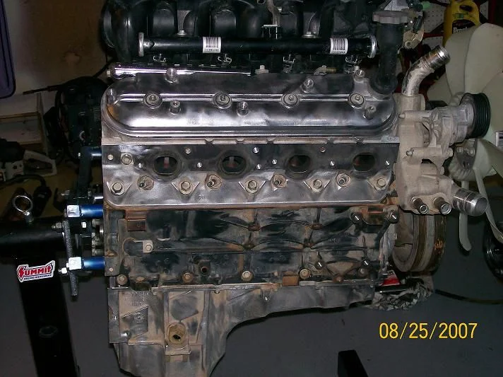

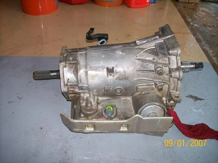

The 5.3 arrives

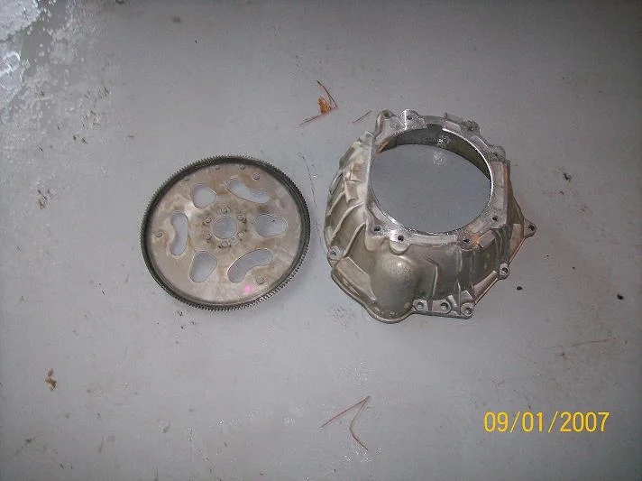

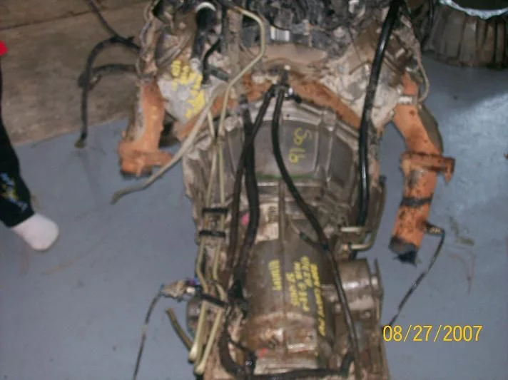

Here are the pic's of the engine and tranny as how I brought it home. Very nasty looking if you ask me...That's my son Andy helping with the clean up work.

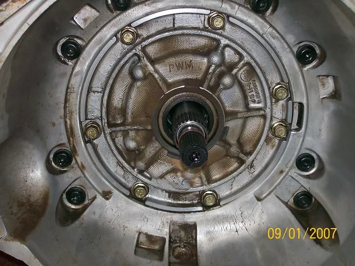

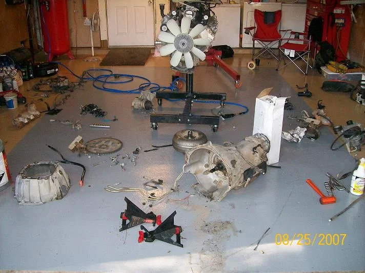

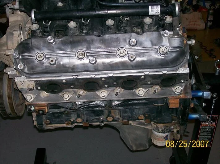

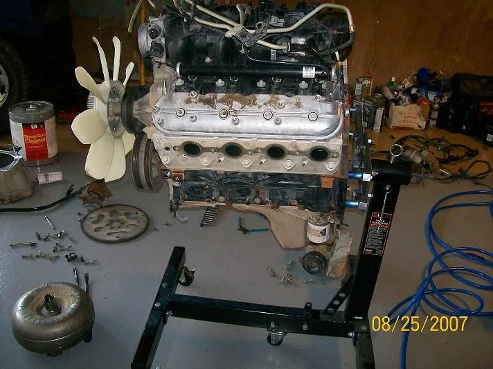

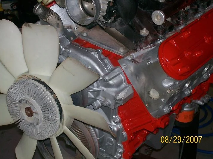

The 5.3 prep begins...

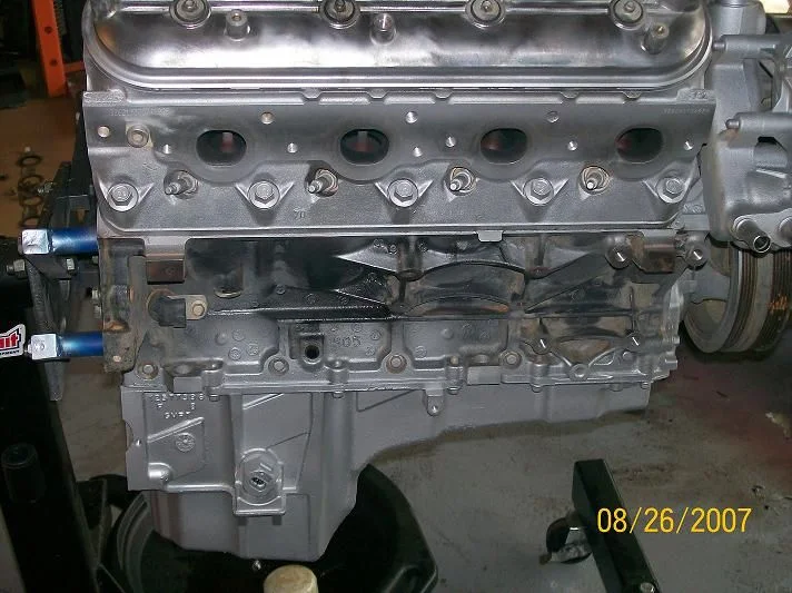

Here's the tear down and prep of the block. It takes a little time but I have always liked doing this portion because I can actually see the end result before it goes in the truck

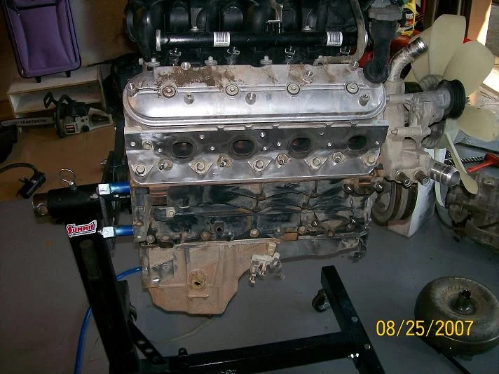

More Prep work...
More pic's

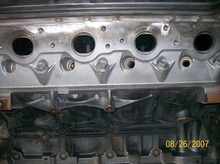

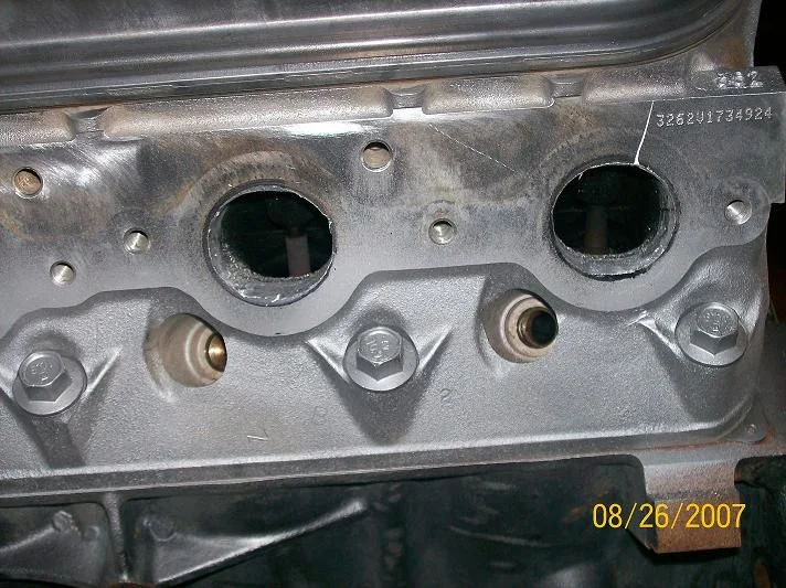

Porting/polishing the heads..
Here's a little trick I have always done but seem to forget to post it. This is something every racer has done in their lifetime....

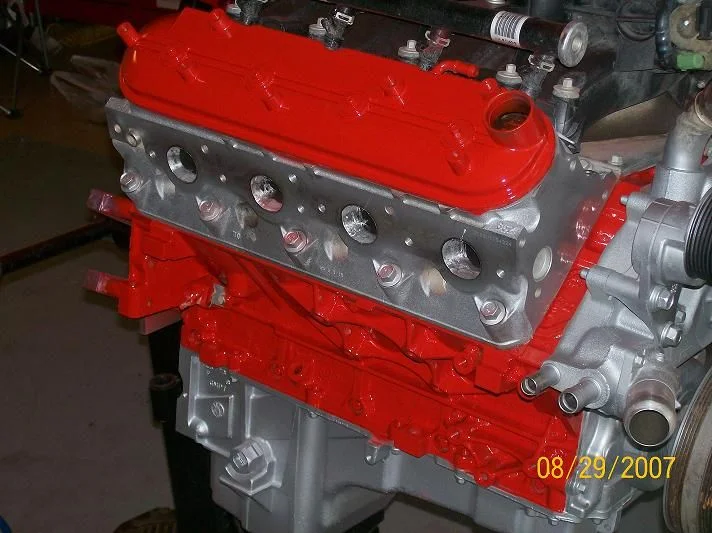

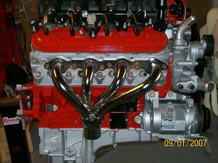

Bling!!!!

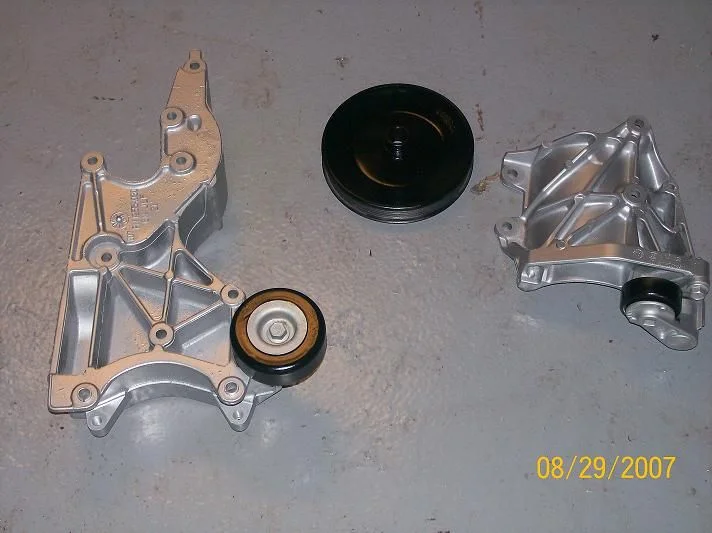

Now for the after pic's of a little bit of elbow grease and Ceramcote paint. Yes that is a very close match to the vehicle scheme.

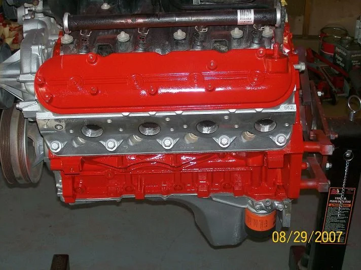

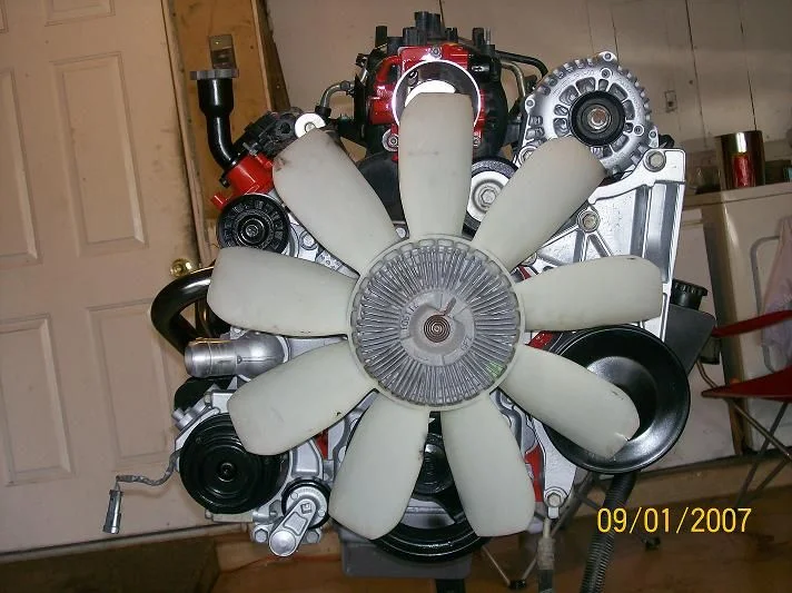

Bling!!!!
A few more...

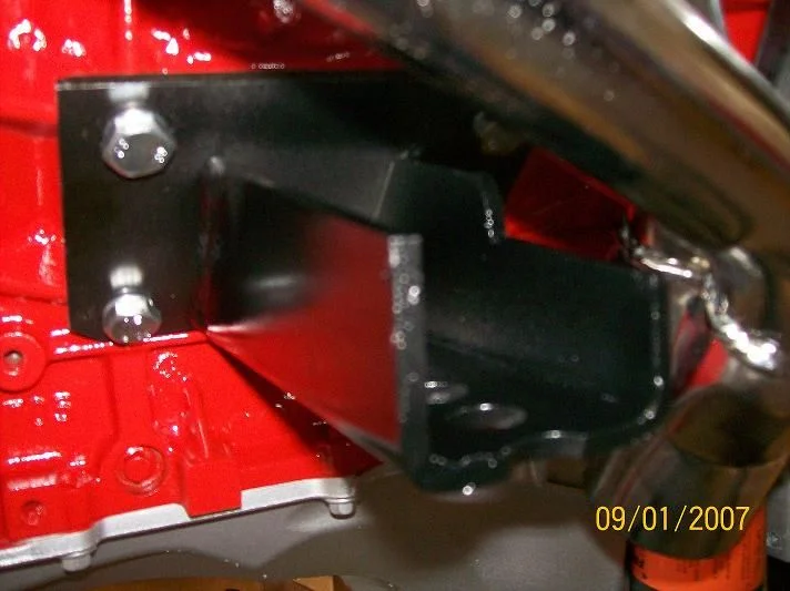

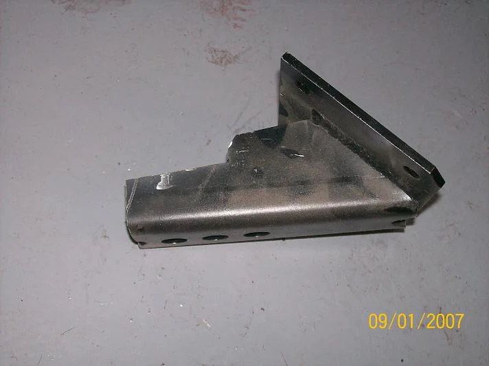

The motor mounts

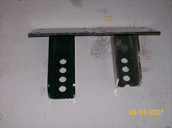

If you are using the AA LS1 motor mounts with the AA center dump headers you need to modify them. First of the #1 tube will hit the steering linkage when install so the pipe has to be cut and turned in. This is done at the exhaust shop, But I cut the relief and the 1" offset on the drivers side. There are no issues with the P/S header during installation.

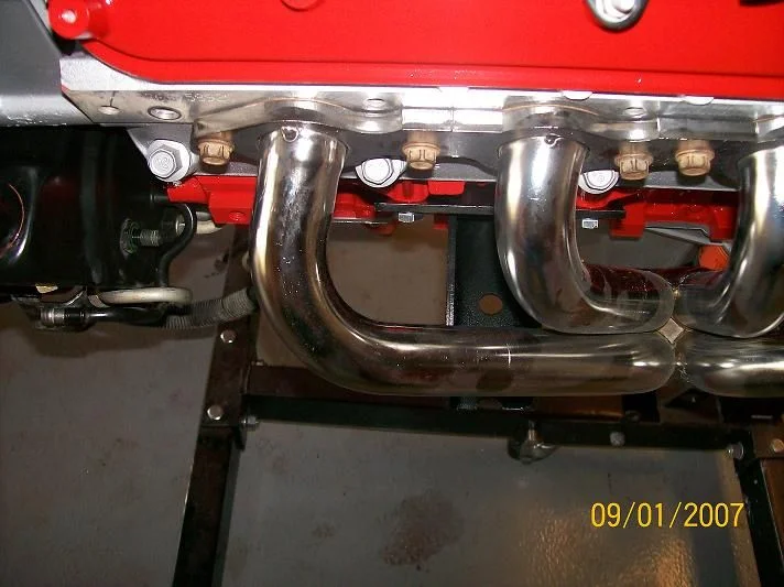

Drivers side header
This is the header after it is installed. Note the #1 sticks out a bit further. This is where it will hit the steering knuckle. Easy fix for a good exhaust guy.

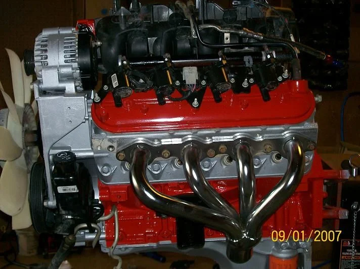

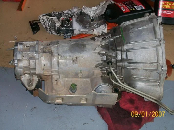

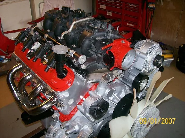

It's ready to mate up to a tranny
Here's the pic's for the finished product. I am leaving the top cover off because it is going to be a surprise for the final pics.

1 more
I may be getting a little carried away but I think it looks good. Next will be the tranny and the installation of the new end shaft and possibly a TCI upgrade kit.

Tranny prep
OK here goes the fun part. Removing the bell housing and tranny support to get it ready to disassemble. Thats T50 bolt heads on the bell housing and don't use an extension on the impact.
__________________
Cool place to get all the cruiser crap you could want! http://cruisercrap.com
And if you want a Vortec: Randy@RTCustoms.net
1989 FJ 62 4" Hell Creek Suspension, Bridgestone Duellers 33X12.50, Sliders, HI-Lift, Pioneer equipment Rack, HFS 2.5 Shackles, Defender Light rack, 4 KC Rally 800 series lights,TaskLED, Warn 8k, and 10k, Dual Optima's, Mean Green Alt. 74mm TB, First responder kit, Safari Snorkel, Manaliveoffroad bumpers, Trail Gear Armor, and a whole lotta stickers!
Member: LSLC, DFW and Austin, BSLCA
My Smugmug galleries: http://iaintscared1969.smugmug.com/
iaintscared1969 is offline   Reply With Quote
Old 09-01-07, 05:14 PM   #21 (permalink)
Site Addict
iaintscared1969's Avatar
Join Date: Apr 2006
Location: Irving, Tx.
TLCA# 17528
Posts: 1,886
Tranny prep
Last set and I am calling it a day. It doesn't look so big now. But it still has about 200 moving parts inside. I may pull in the truck tomorrow and tear it down?! Maybe Monday
__________________
Old 09-01-07, 06:46 PM   #22 (permalink)
Forum Regular
gswest's Avatar
Join Date: Jul 2006
Location: St. Lucie County, Florida
Posts: 147
It's amazing that you can make that dirty motor new; better than new actually.
gswest is offline   Reply With Quote

I just take my time and Clean everything that can come off and put it back together. I am glad you like it. How about that color scheme?

The color looks very nice; it matches the truck perfectly. Does the tranny get painted?
Old 09-01-07, 07:41 PM   #25 (permalink)
250+ Club
MrZero's Avatar
Join Date: Jan 2004
Location: Austin, TX
TLCA# 17387
Posts: 316
The red bling is AWESOME!! Love the valve covers!

Are you jealous MrZero? The tranny will get treated just like the rest of the engine. Clean and matched. I bet I get the Mistress back for some love?! Hope the A/C is working good. I still owe you the part #. So in your opinion how is it looking? Familiar? Hey when we get these all done let's do a 4th of July get together!!
