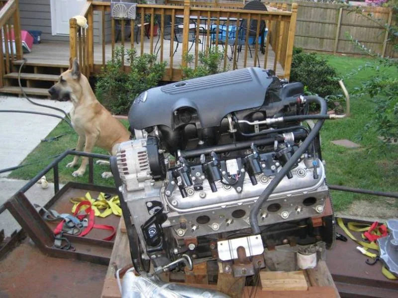

OK, like many others I decided to do the Vortec v-8 Swap... I thought about it for a while and was set on a 1HZ but th eavaiability was just not there.
Right now I am busy getting all the bit stogether so I can get the project started. Thanks to many for answering all of my questions, I appreciate it!
I have gotten the engine (2004 5.3 Vortec with ~ 30k miles), with the wiring harness and computer already done by fuel injection specialties, bought a brand new h55f from cruiserparts, bunch of odds and ends from cdan, clutch and headers from Advance Adapters, Marks adapter (that fits the gen III lock) and still have more random bits to go.
Leading up to this I have done the OME suspension kit (heavy heavy), rebuilt the rear axle with new brakes and bearings, and still need to do the front axle and brakes. Hopefully I can knock that out soon before starting the swap.
Anyways, I am getting excited and just wanted to share the joy. I'll try to make a little thread out of it if you guys are interested..
Got some engine and wiring pics below... if i can figure out how to include them..

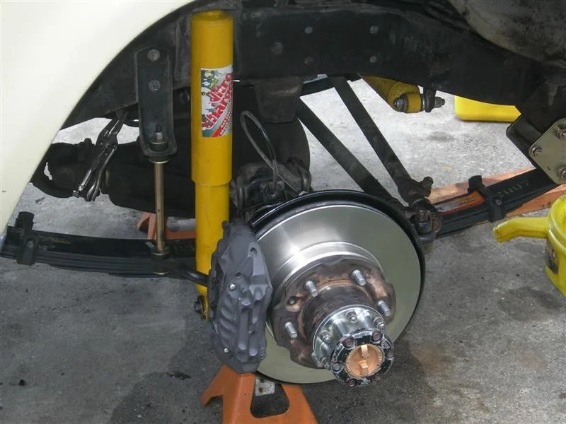

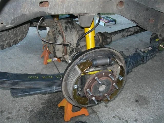

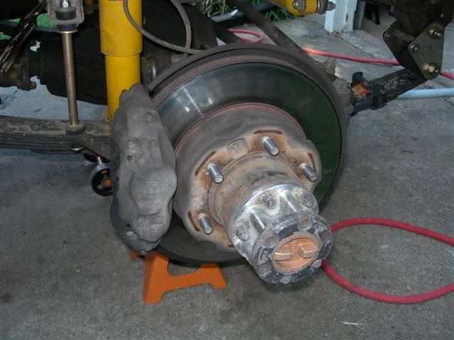

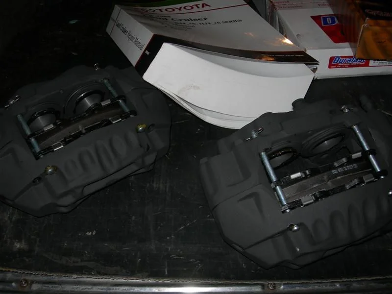

ok, had to take apart the rear brakes again to fix what was apparantly a warped drum. Got them machined, we'll see how it works.
I also went to autozone and got some 95 4 runner calipers, new pads, and new rotors to go on the front axle while I am taking it apart to put new seals and bearings in it. Hoping I can make this thing stop before doing the swap next week.
going to finish up the front tomorrow and take it for a test drive.. I am excited.

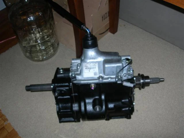

as far as swap stuff goes, all i have done is put the shifter on the tranny and placed the order with summit for the exhaust u bends, muffler, cats, and fuel line junkola.
Just wanted to share the progress and a few pics.

Spacers needed for 4runner calipers w stock wheels?
5.3 looks great. I'm curious to know if you had any clearance problems with your new brake calipers with the stock wheels. I have the 4runner S13WB calipers that I plan to install on my FJ62 and am wondering if I'll need spacers. Thanks,

sure, let ya know tomorrow..

looks like the new calipers fit just fine. All I had to do was trim up the dust sheild, and they sit right under the wheels with plenty of clearance. almost done with the new wheel/knuckle bearings and brakes, just got a little bit of the left side to finish up on tuesday whe i get back from yet another work trip (boo). Had to wave goodbye to it for a few days a minute ago.
rover67 is offline   Reply With Quote

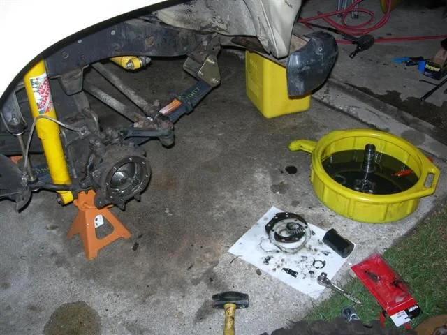

mmmmmm. 4 runner caliper and fresh guts in the knuckle.

Do those calipers bolt straight up?

yup, the calipers bolted straight up with a little bit of cutting on the dust sheild. honestly it was pretty easy with the angle grinder.... and they are fitting under what look to be the stock wheels. as far as a sheet with total cost goes, i have a pretty complete spreadsheet started with part numbers, prices, and vendors that i am using to make sure i have all my parts. i can post it as the list gets more complete. there are of course the many trips for random crap that may not get recorded though. looks like in total it is probably going to be roughly a 6500 dollar deal. thats with no skimping on parts, but looking for best deals and shopping around. also realize i do all my own welding and fab work... so stuff like exhausts just costs me the parts (u bends, ect.) .
anywho, thanks for the intrest!

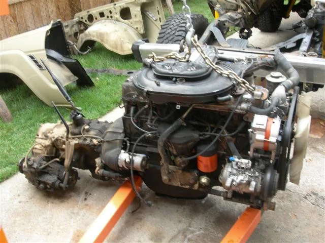

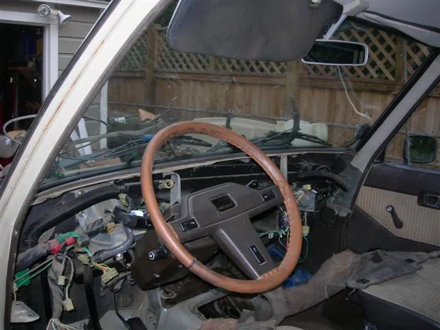

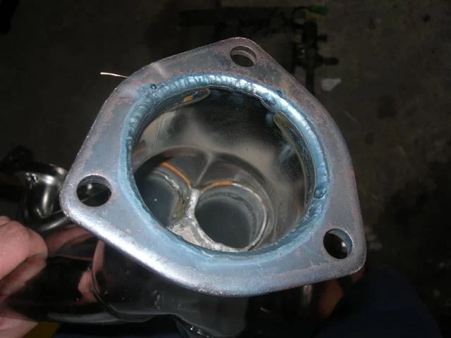

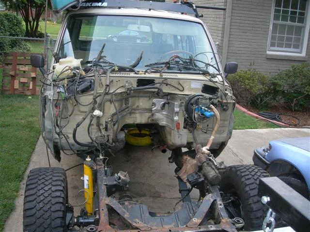

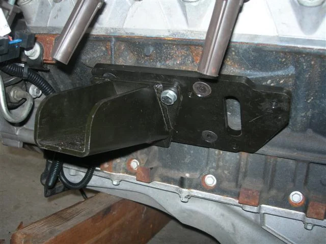

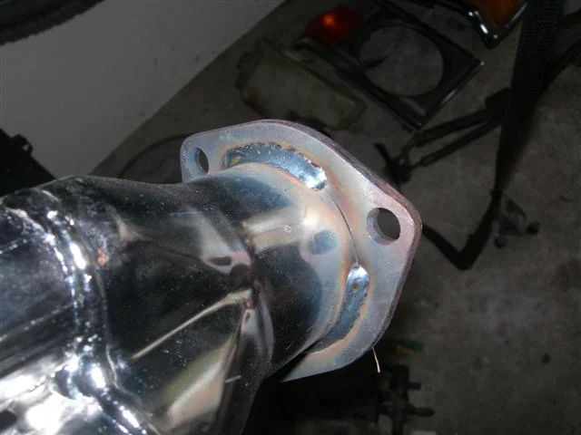

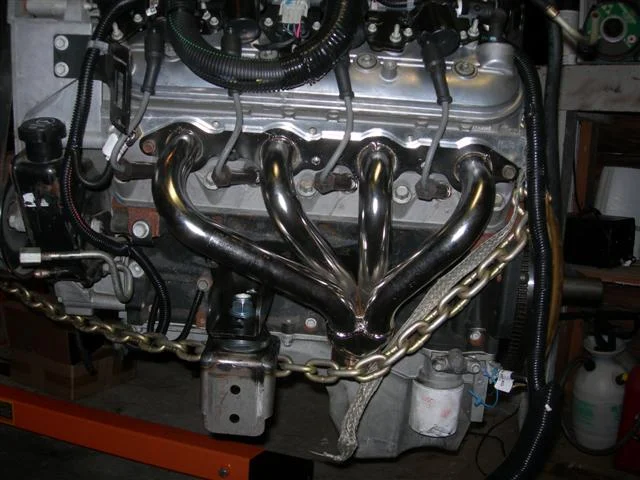

got a lot more done finally. took the whole front end apart and pulled the motor tranny trans combo. Had a good last drive in the truck to IA and back to memphis with the old combo... cant wait till the new stuff is in and running.
welded flanges to the headers, put the motor mounts on the engine, started to set up the marks kit and clutch, and am off to pull apart the transfer case tonight. hopefully i cna get it all apart tonight and start cleaning.
Also pulled the heater core out to figure out where the antifreeze leak was coming from, man that was a bear... had to take the WHOLE dash apart and out to get to it. hopefully i never have to do that again.
Motor came out without a hitch, just hoisted it like you see in the pics, it tilted back to clear the transfer case shifter and slid right out with little effort.
enjoy the pics..

what are your plans for the radiator, fan and shroud?

stock rad and ford contour fan. we'll see if it works...
had the rad rebuilt a few months ago, so hopefully it will be up to snuff. The old engine overheated some, but I think it was due to a faulty thermostat and worn out fan clutch.

got the old tranny and transfer case off of the 2f tonight.
took for ever to blast all of the grease off of the old parts at the car wash... but they are finally getting close to clean. The transfer case had almost every bolt loose in it, it is a wonder it was running fine the way it was. should be a lot smoother with everything tight again.
thanks for the props, i appreciate it!
